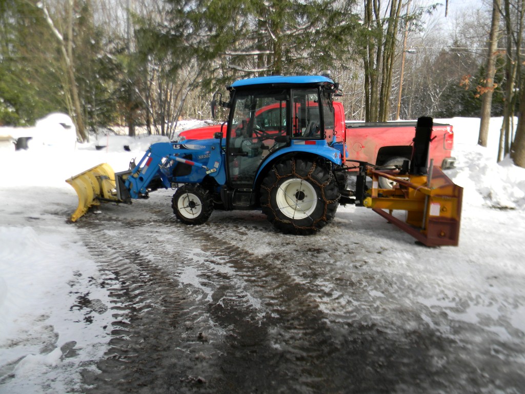

I have the older version of the tractor you are looking at purchasing. Mines an XR3037HC and I have a 7 1/2' Quick attach plow for the front and a double auger blower for the 3 pt. It works fine on my gravel driveway. I like it better than plowing with my truck since it can turn much quicker and is easier to maneuver than the truck. DSCN2000 (Medium).JPG
