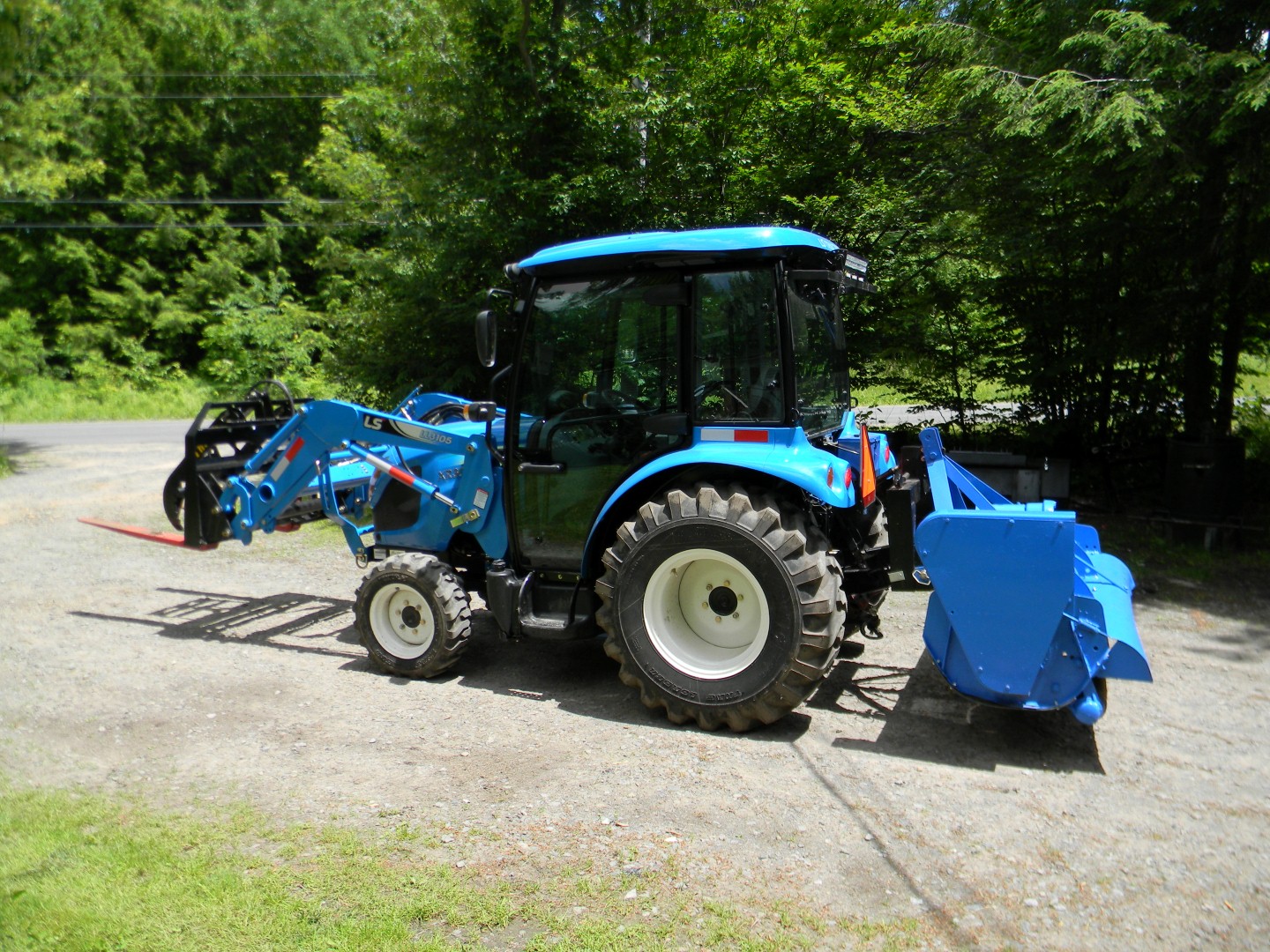

I've been looking at LS tractors as a very likely option for my next major purchase. I like the features, size and capability of the XR3135 tractor, but I find myself wondering about the tiny 25" R4 front tires. Every time I see a picture of one, it makes me think of a t-rex, with it's tiny front legs, and huge back legs. :confused2:
It seems that historically, all the 3000 series LS tractors used smaller front tires.
Other brands seem to have 27's in R4, and 7-16's in R1 on similar size tractors, excluding of course NH Boomer's...
Strangely, the opposite is true of the 4000/4100 tractors, which have oversize front tires compared to other brands.
I have noticed that the 7-14 ag tires used on this series are a little taller (~27") than the 25-14 R4's (~25.5"), so it might be possible to bump the R4's to 27-15's if an appropriate set of wheels could be found.
If anyone has a 3000/3100 series tractor with R1 tires, can you toss up a picture for me?
Just seems odd that LS put comparatively undersize tires on this series, while the next series up has slightly oversize tires. ??

I have the XR3037HC which also has the smaller R4 tires. I would have preferred the larger front tires but would have to go with the 4000 series to get them. When I needed a tractor the dealer had the 3037 in stock but not a 4040 so I bought the 3037. I've now had it over 2 years and never a problem with the front tires. As long as they are aired up properly they do the job but like you say, it looks odd with smaller tires. The 3135 is basically the same as the 3037 but with the LS engine. If you want the larger tires go with the 4000/4100 series. You get the bigger tires and much greater loader and 3 pt. lift capacities.
I like my LS a lot. It does all I need it to do. Its very rare I need to lift more than a ton with the loader so it suits my needs well. I've never seen a 3037 or 3135 with R1's as the majority get R4's. The stock R4's are rated for 2130 lbs. max load each (4260 for the pair) and are more than capable for the tractor. If I remember there is a member that has R1's on his 3037. Hopefully he'll read this and post a couple pics.
Here's a couple pics of mine wire the R4's.

Thanks for the thoughts and pics fellas.
To clarify, I'm not worried about the rated capacity of the tires, as it's likely more than sufficient. My concern is that the tiny footprint will make travel over soft ground difficult, particularly with the loader full of dirt or lifting logs...
The first use for my tractor will be developing a property and putting up a log home... No doubt the ground will be soft in places, and I'll be lifting quite a bit...
For the small relative price difference, I'll probably bump to a 41xx series... You rarely hear anyone complain that they bought too big a CUT. :)
