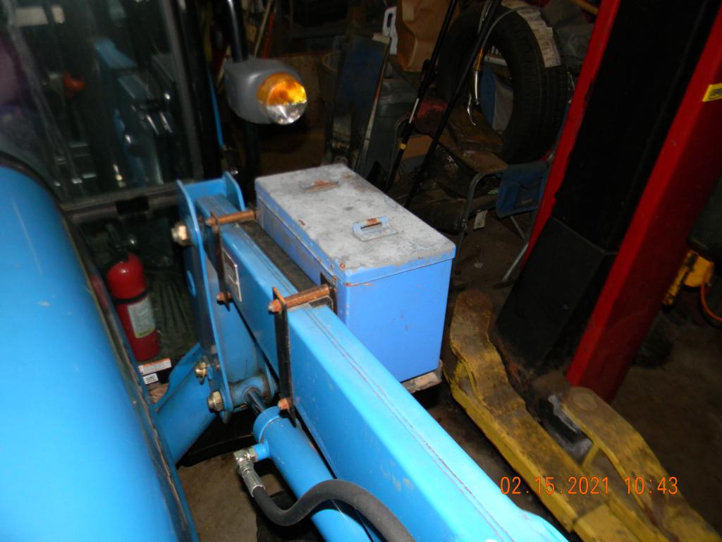

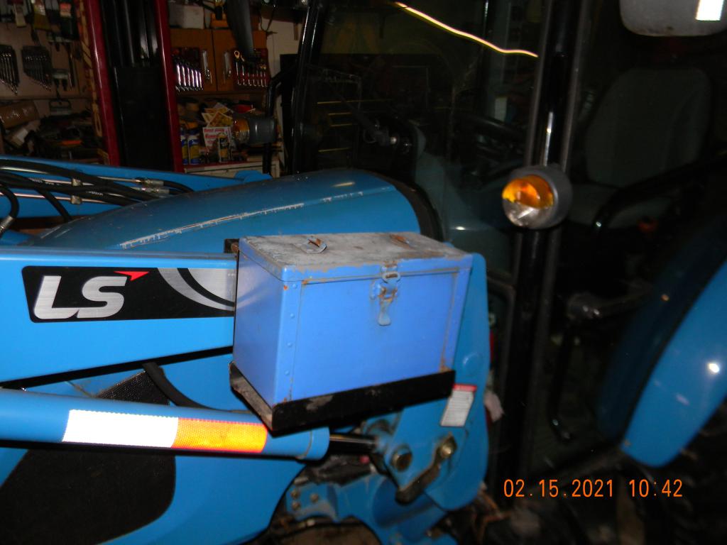

I originally made a bracket that bolted to two threaded holes on the back right side of the cab just above the rear remotes but found the ammo box was always in the way when I needed to plug hoses into those remotes. I then made another bracket and moved the box to the left loader arm about 6" in front of the cab window.
