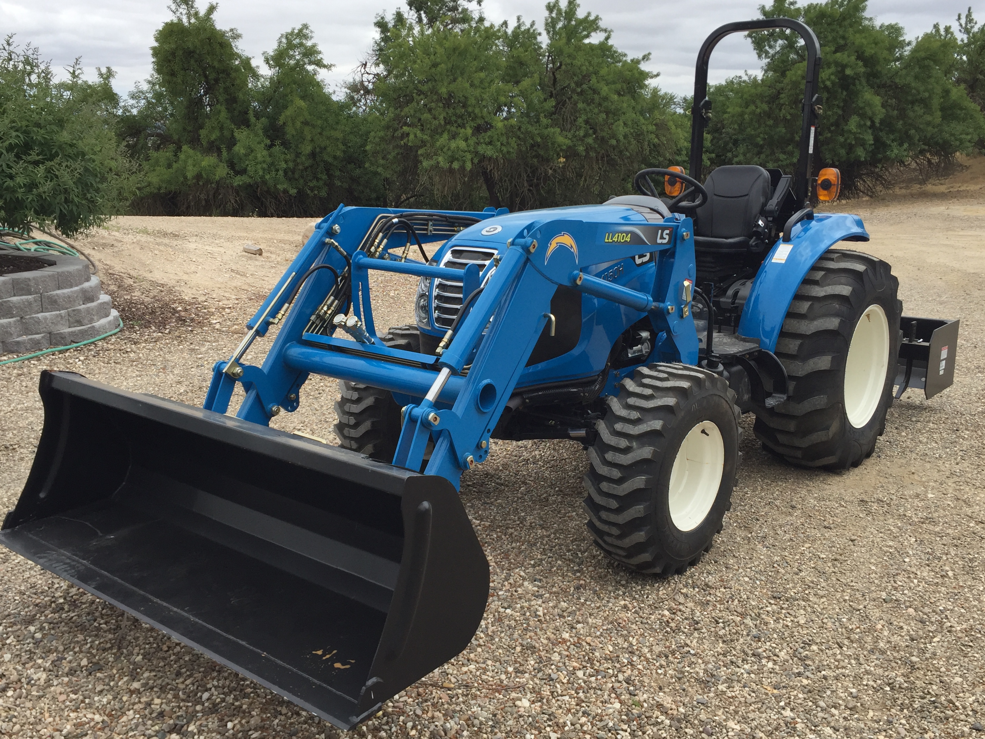

Well I finally got it. I had ordered my tractor a few weeks ago and the dealer delivered it yesterday. I have to say it is a little bigger than I had originally thought about getting! Last year I had looked at the XR 3135 and thought that was the dream machine with a suspension seat, good ergonomics and rear hydraulics. This year when I did the side by side comparison I really liked the heavier drivetrain components and lift capacities of the 4100 series. My primary use is a 1/4 mile DG driveway that has two hills that are 10-12%. The other use I have is in my almond orchard for firewood and brush clean up. I got the hydro trans. due to the ease of use for my kid especially with hills. I had the dealer install a top and tilt kit and run hydraulic lines from the rear to the front loader. He made a couple 18" whips that allow me to tap into either of the rear outlets. I ordered a HD grapple, forks, hydraulic auger and rear 3 pt forks from Titan. Hoping to get a Woodmax chipper for next fall. Any advise on hydraulic or mechanical feed would be appreciated...
I had a chance to take it out and get it a little dirty today. Overall impression is an 8 out of 10, even though it has 50 hp it still doesn't have the cubic inches to really have much umph. In 2nd range it stalled on a incline without being under load. I guess I will have to get used to running it at a higher RPM than the full sized tractors I'm used to or maybe I'll just be crawling along in low gear. I do like that in the disked orchard the large tires of the 4150 make for a smooth and stable ride unlike my last little tractor (JD 2210). That's all for now, I'll post a little more once I get a chance to try the auger and grapple.
