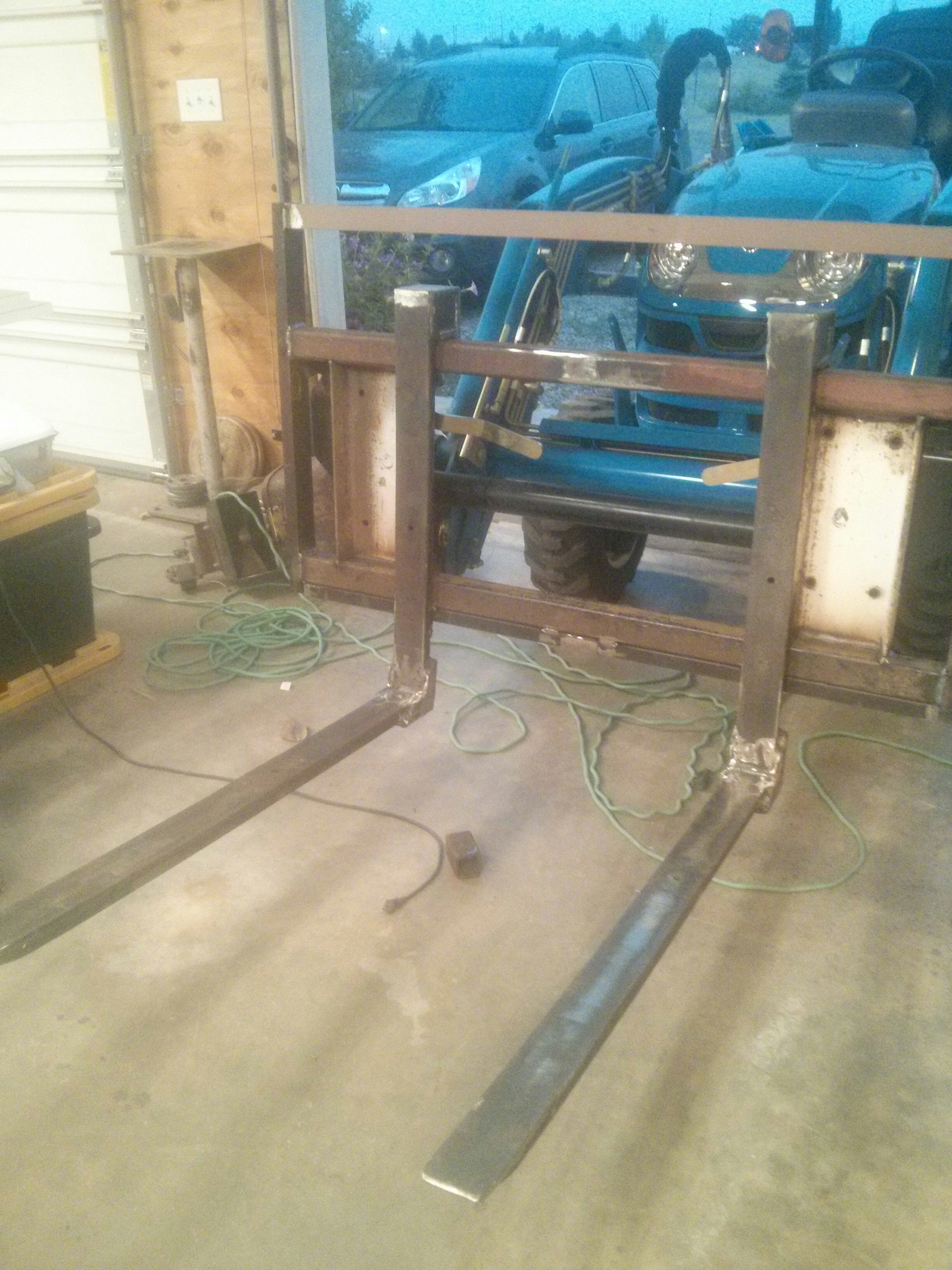

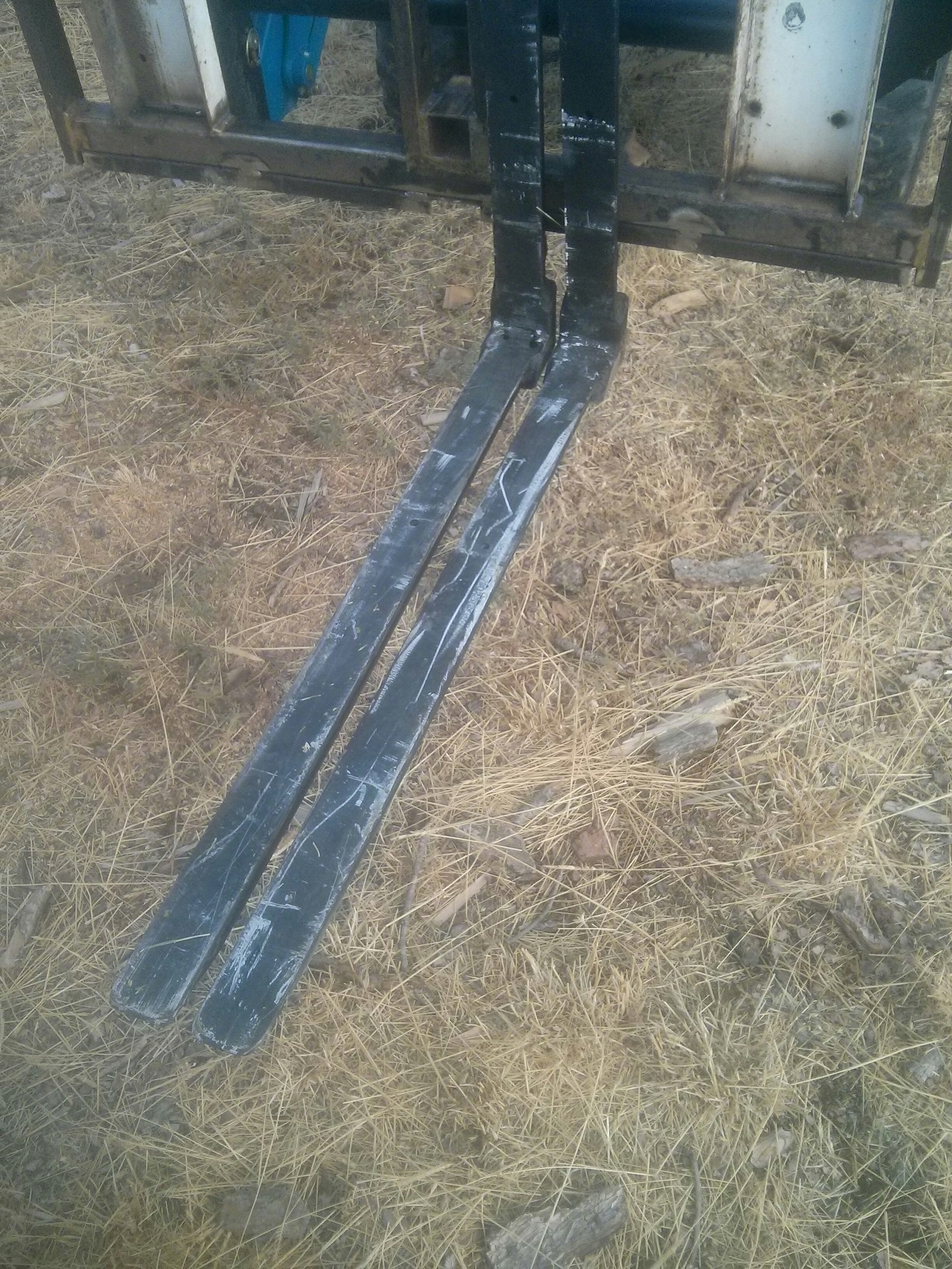

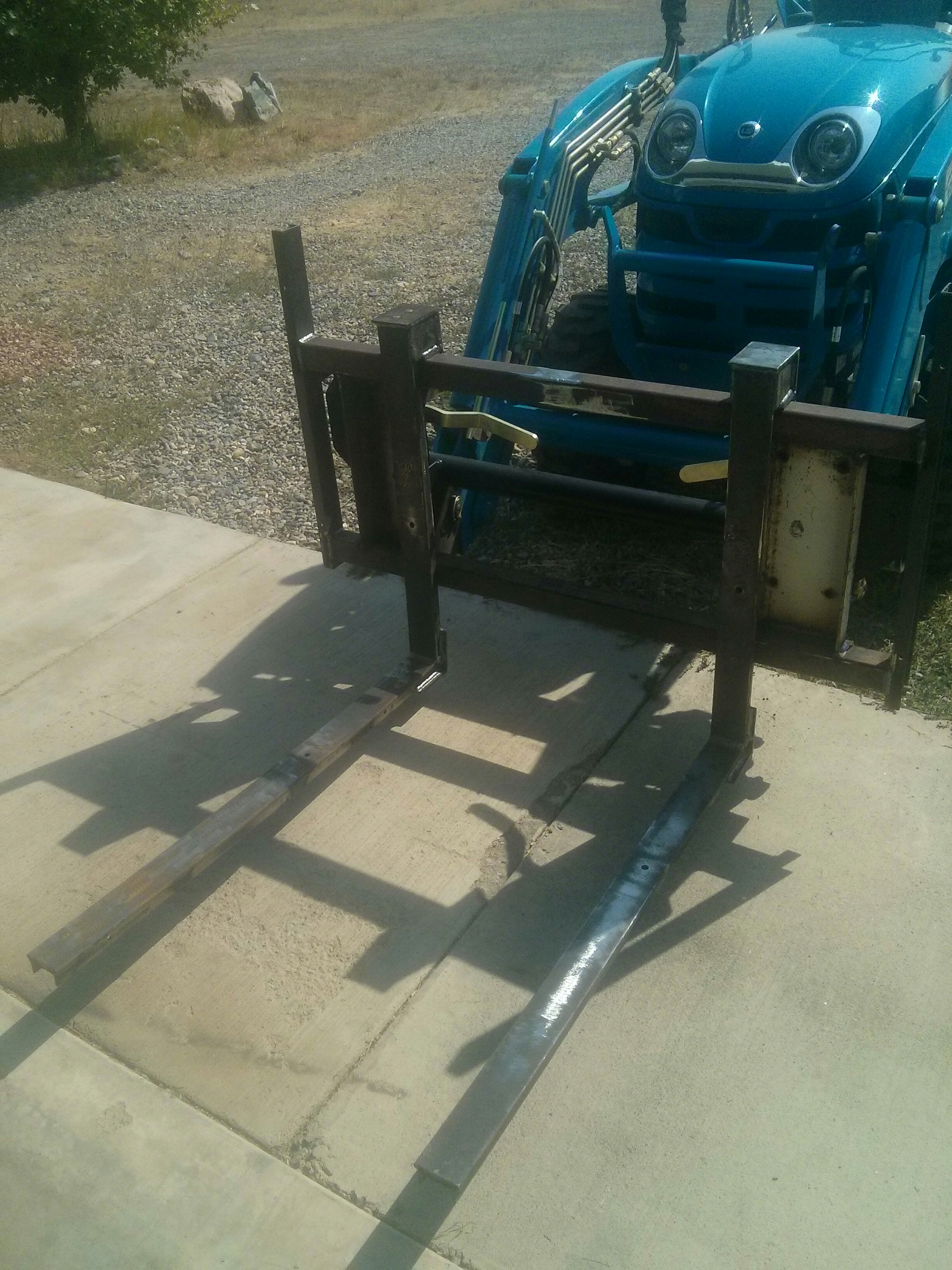

I built these pallet forks from a pile of (s)crap steel I have in my back yard and today Ive been moving things around in my yard with them, now that it stopped raining for a bit. I have some videos ill put on youtube later.
I built it out of .25 thick steel 2x2 square tube and 2 chunks of 6 inch channel and some 2x3/16th channel on the sides and the center.

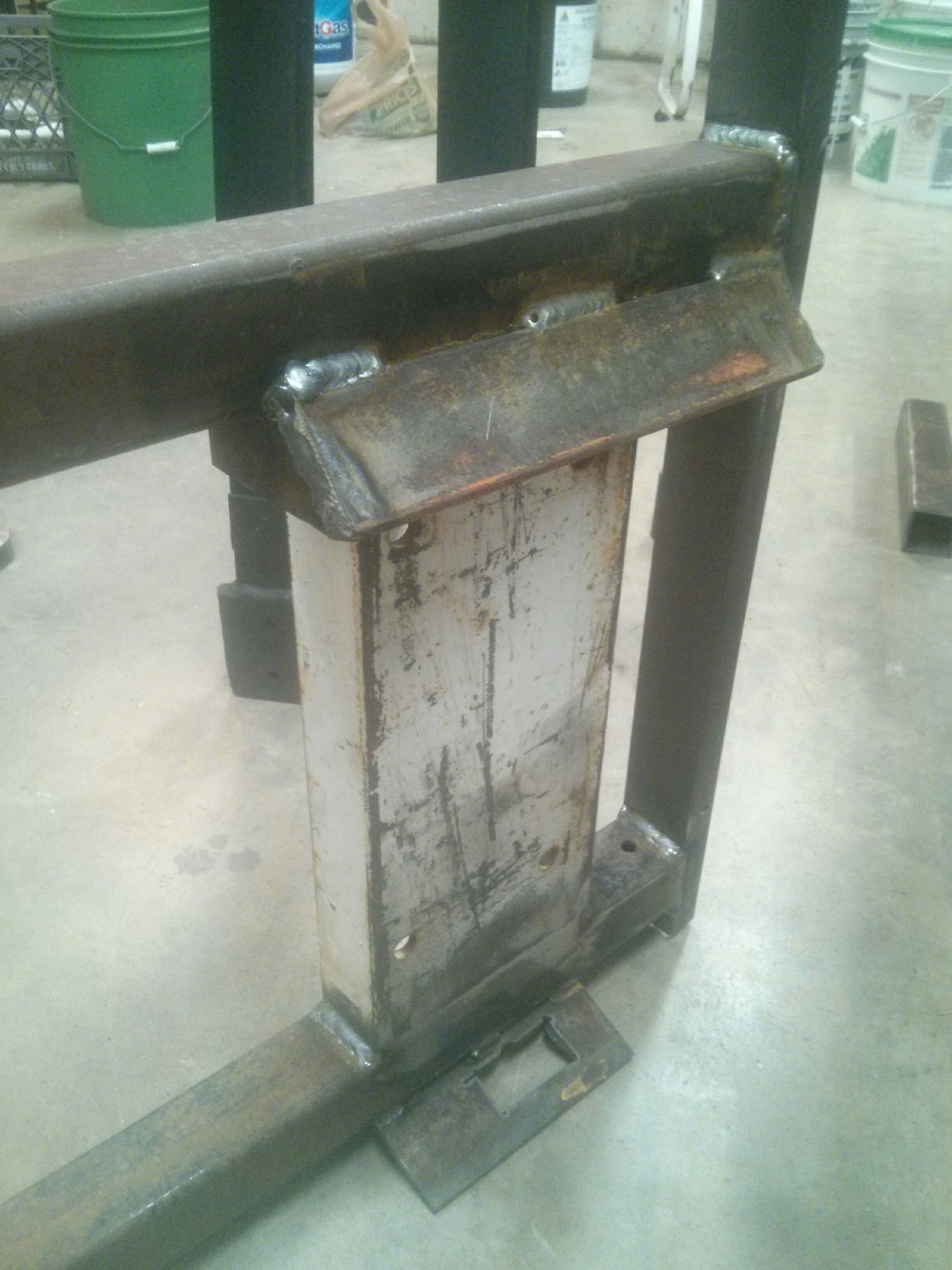

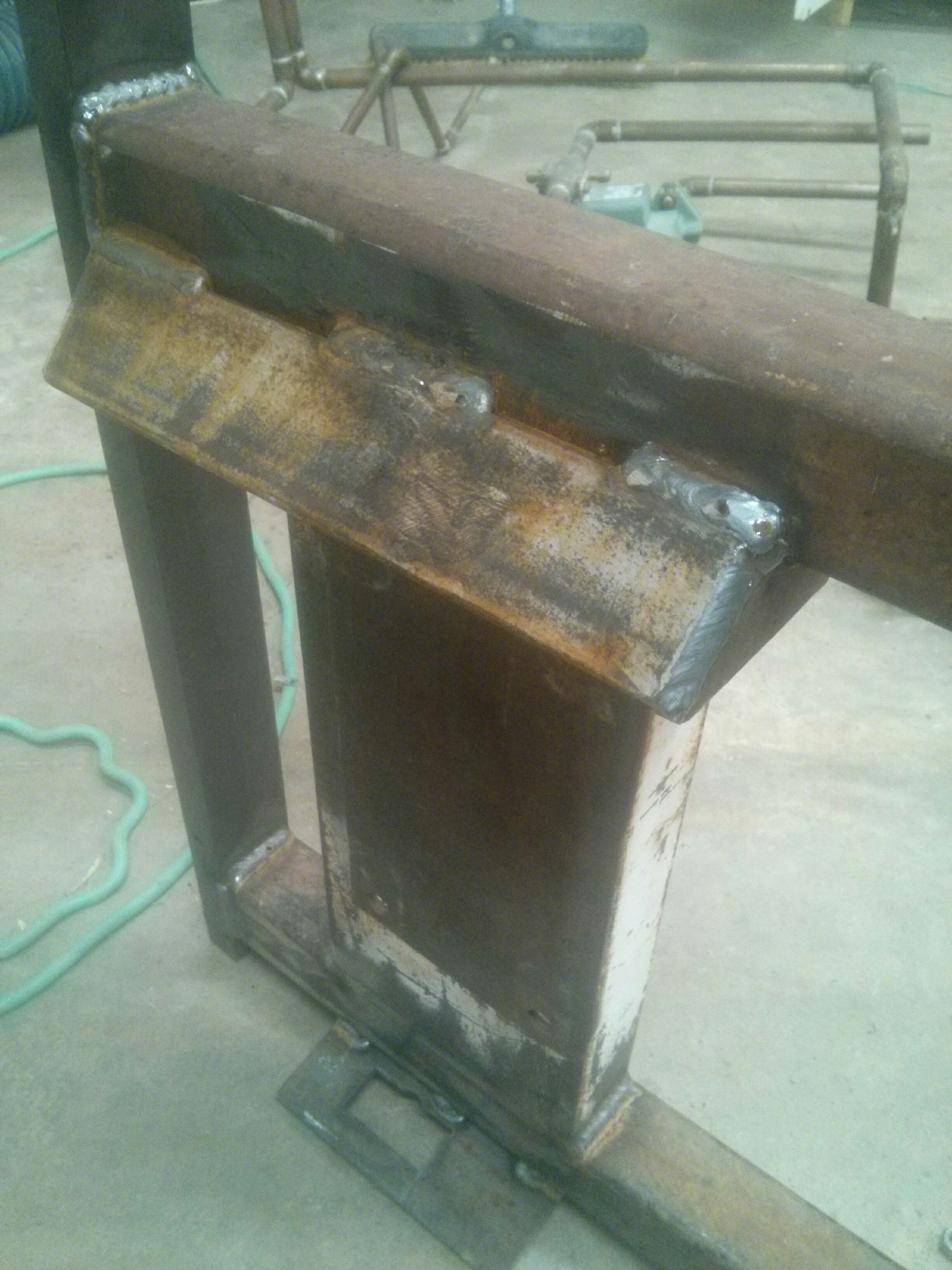

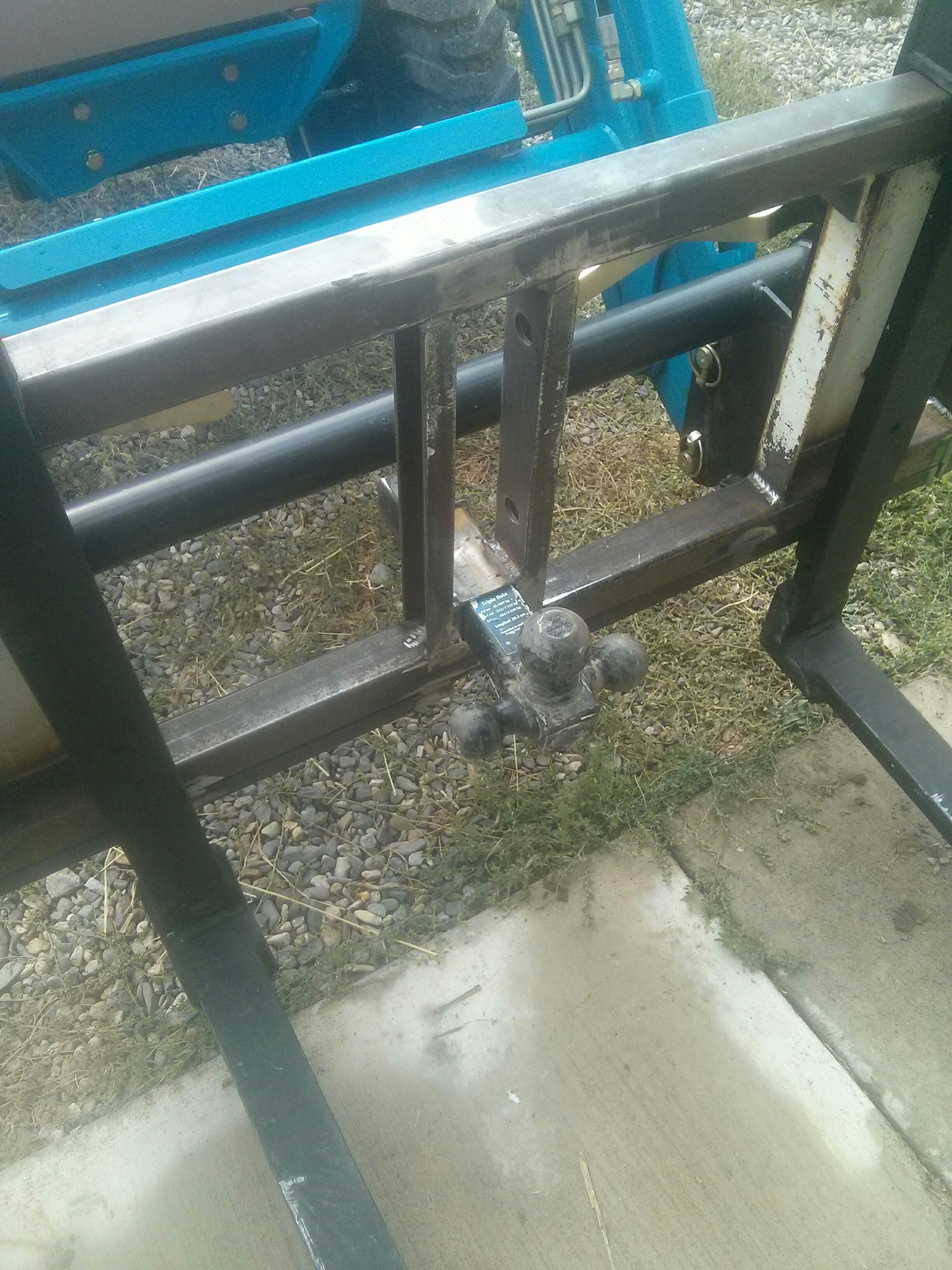

Added this hitch receiver today
SSQA attach points

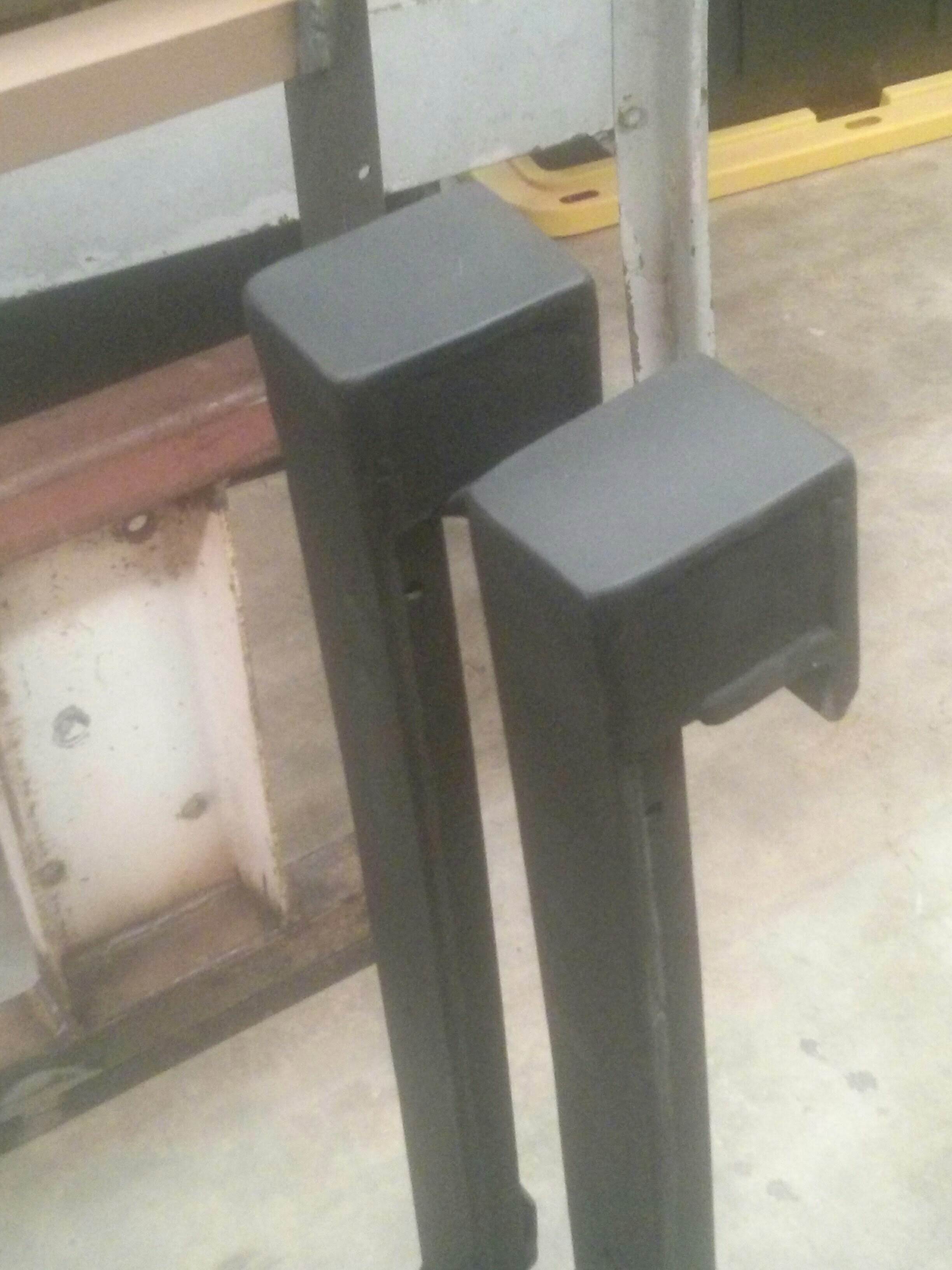

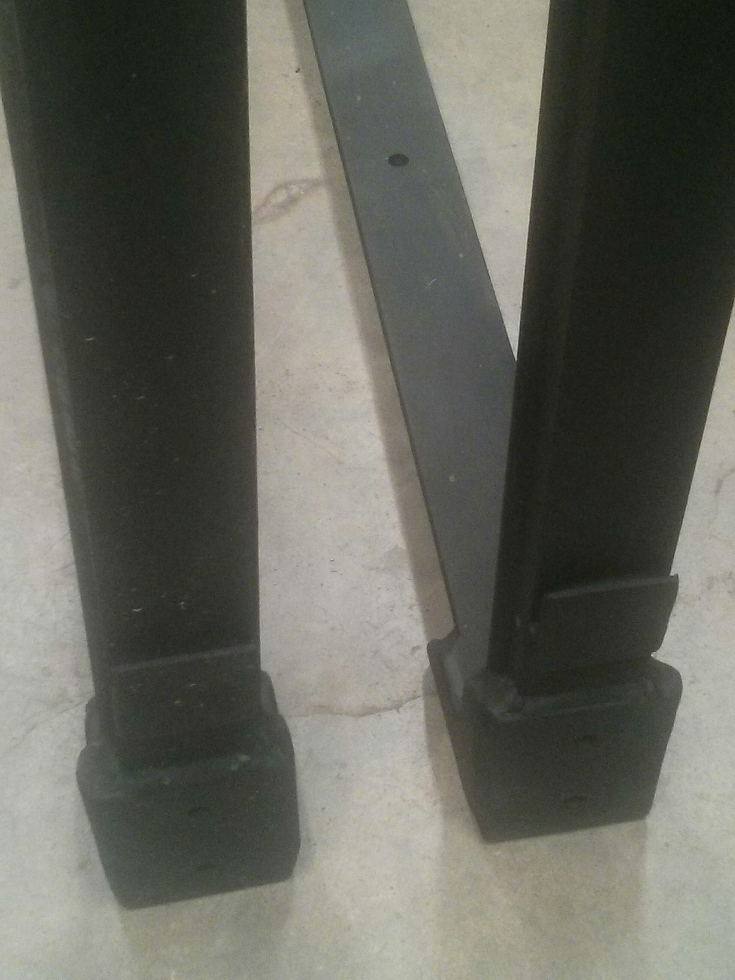

I built the forks from 2.5 inch wide (I think) 5160 steel and backed them with 2" channel with a complete weld all the way around. There is a high chance that the weld will fail because I did no special preheat/post heat... before using them I measured from top to tip and it was 46 3/8"
the top of the forks hang on the 2x2 tube
this is how I kept the forks from bouncing up and down, but turned out to be a nightmare so I'm going to cut it off and redesign it with spring loaded mech.

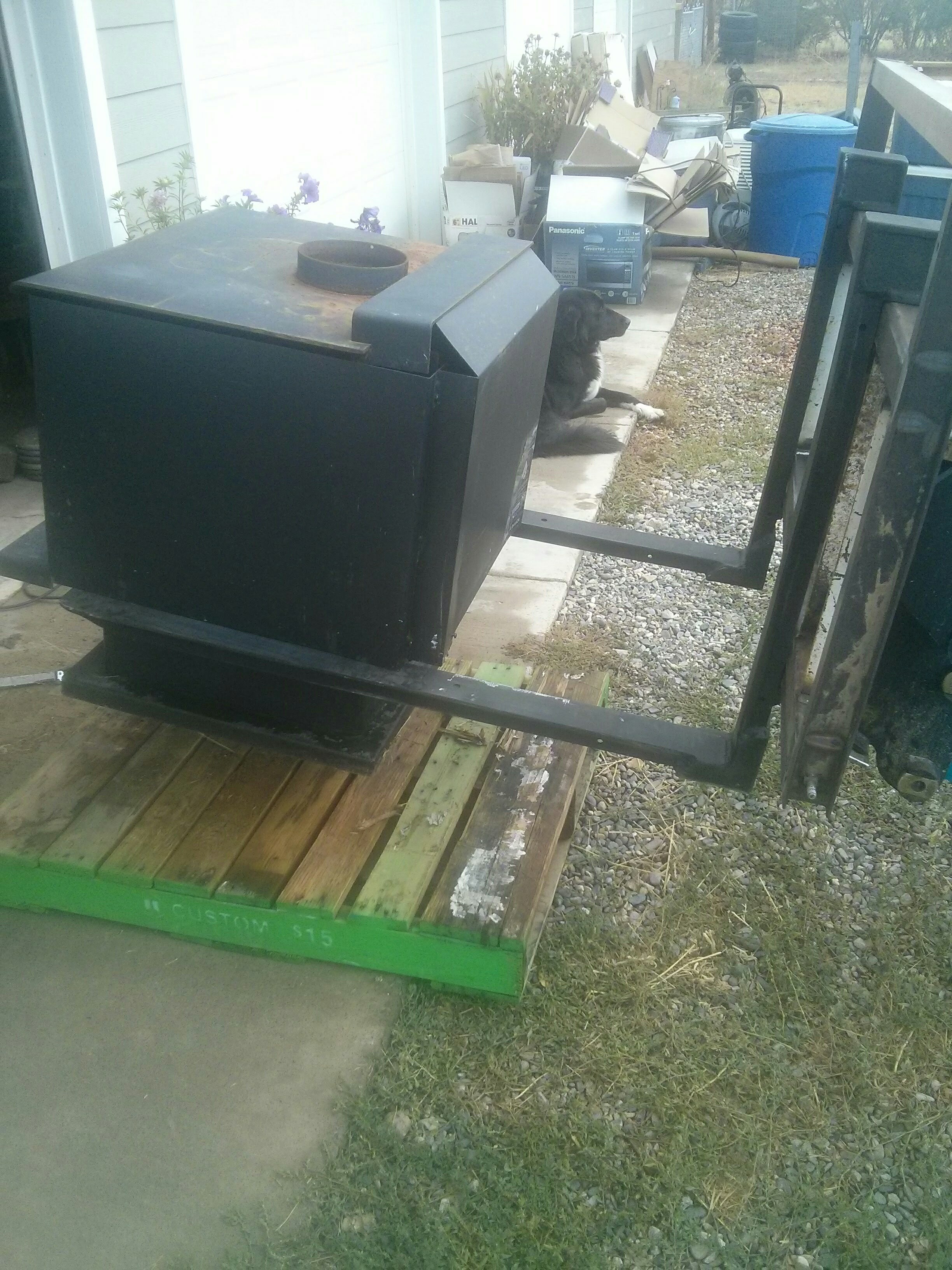

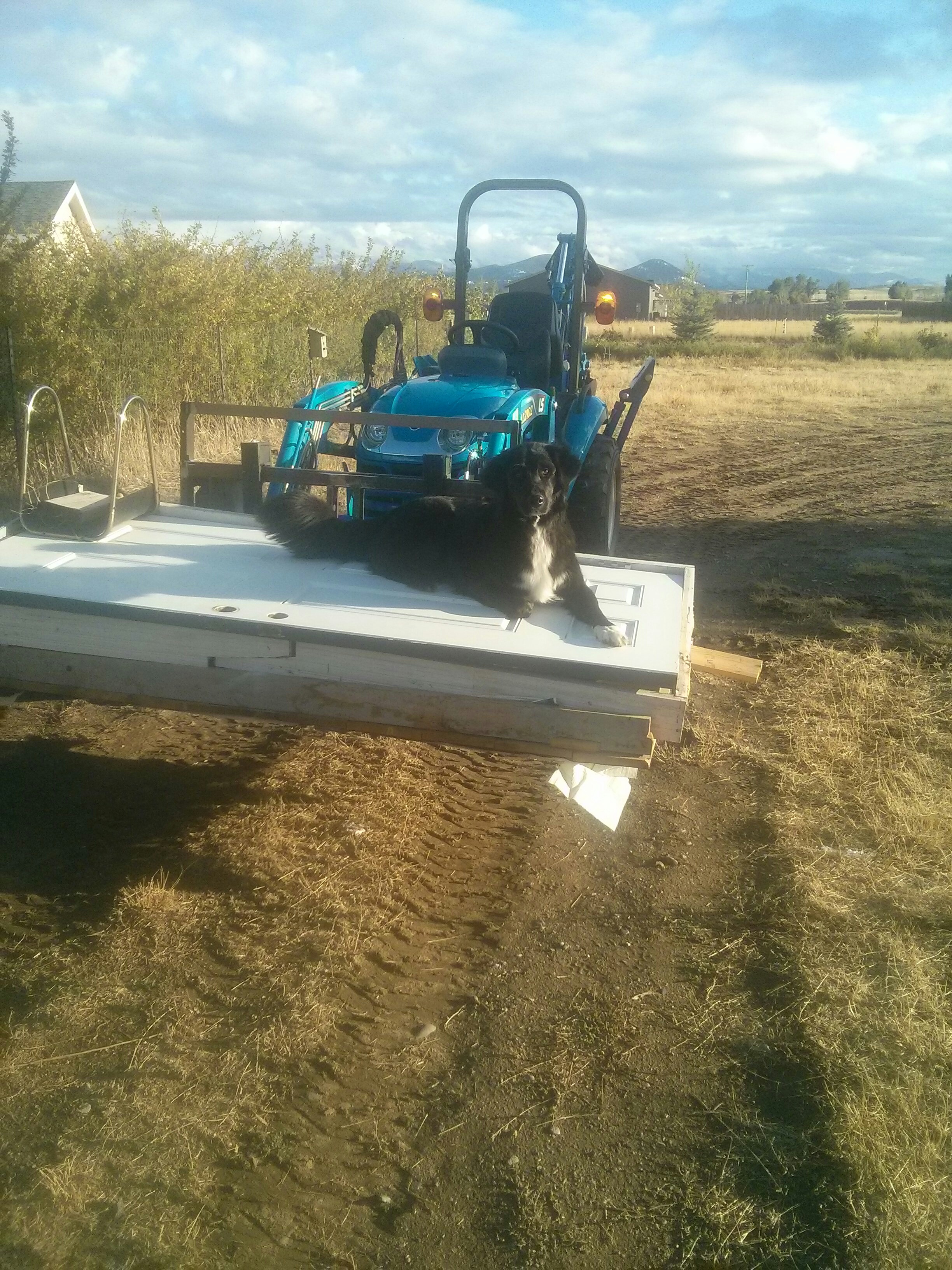

I recently did (still doing) a major remodel on the entire first floor of my house so there was a stove I pulled out of the house I need to put in the garage. The stove in the garage I already moved out with the bucket.

After I was done moving things I remeasured and it was exactly the same as when I started

I then went and lifted my home made double acting log splitter to replace the tire and fix the leaking drain plug. The thing is pretty heavy and the loader lifted it but now one of my forks measures 46 3/4 instead of 46 3/8 :shocked:
I guess i should add more support to them :thumbsup:

My helper seems to approve of my latest tractor attachment.
On Sunday I lifted my log splitter again but swapped the forks to see if I could get the other to "bend" the same... and they are now matching again. What I didnt realize when I lifted it the first time was all the weight was on the right fork. I thought the all the weight was closer to the rear of the splitter. Apparently there was no weight on the left fork at all (1/2 inch gap) and the splitter was only held up because of the hydro hoses, other wise i think it would have tipped off to the right.

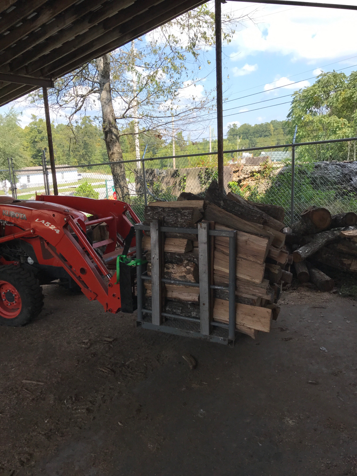

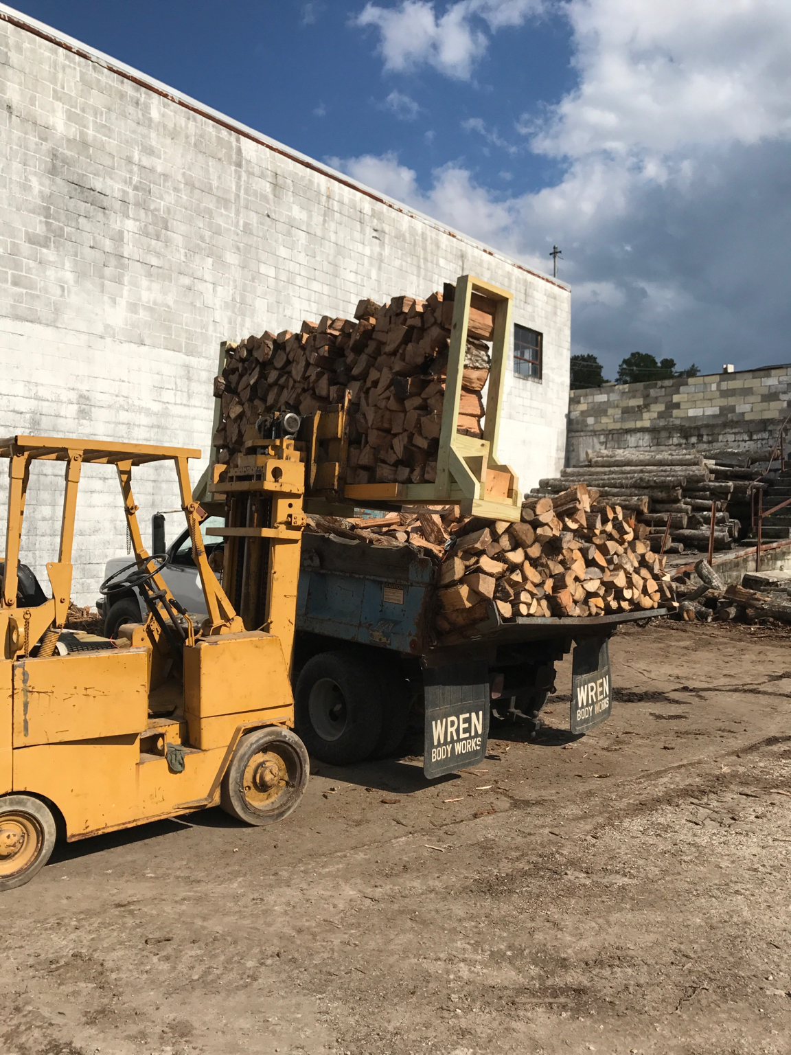

Here's a firewood rack I've got that my tractor can just barley lift to full height with green oak. 3 basket full is 2 rick in that rack. Here's another rack I've got that holds 1 rick and surprisingly the tractor can lift it high enough to move around with green oak cut 16" long. My loader is supposed to lift 1130 pounds to full height at the pins but I'd be surprised if it's not doing a little better.IMG_0467.JPG IMG_0462.JPG
