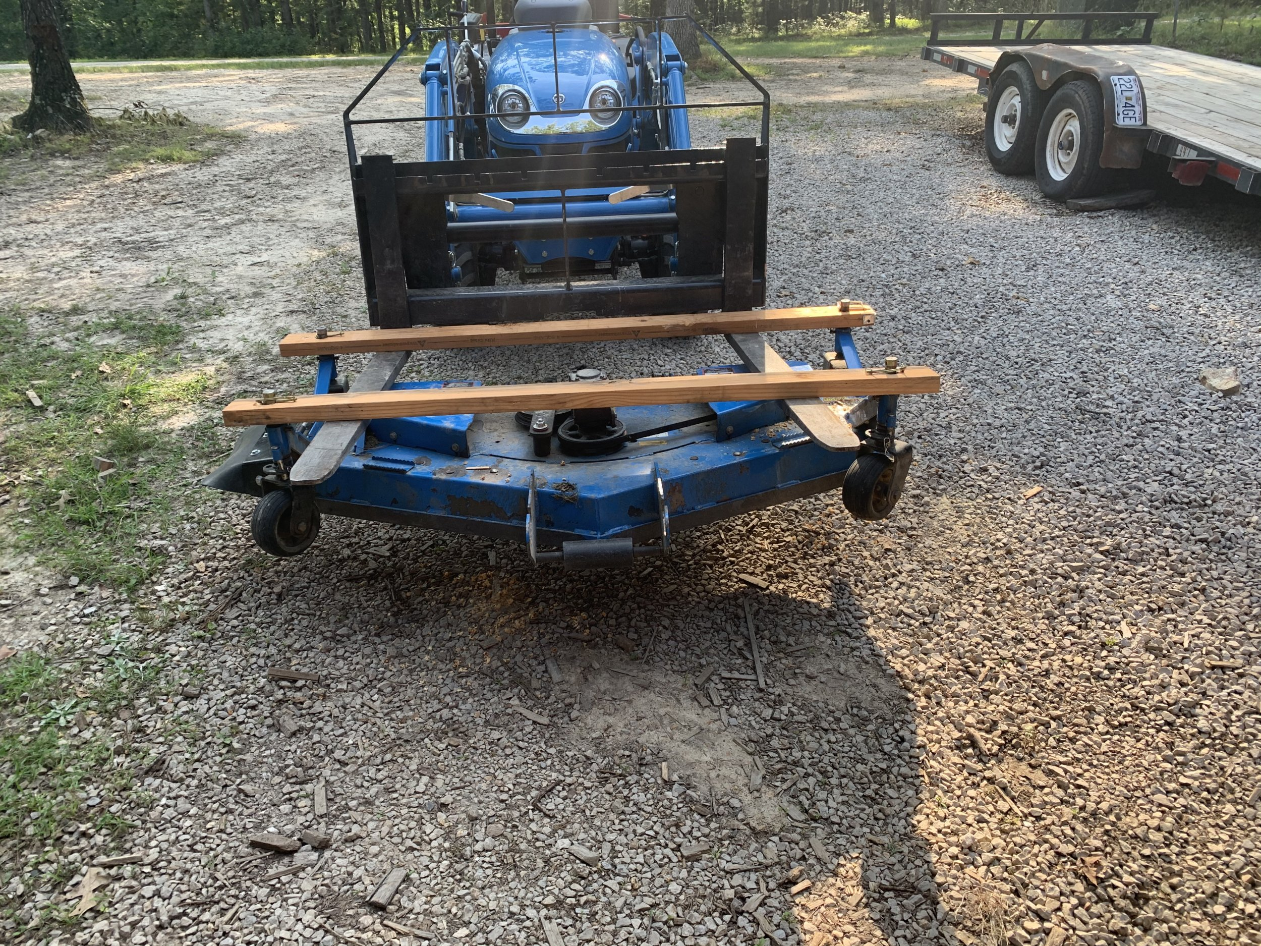

I have an XJ2025 with a MMM. Has anyone fabricate some type of contraption to quickly and easily mount on the top of the mower deck to lift it with a set of forks and move it around or stack it on an implement rack when not in use. I’ve been taking mine on and off when not using and it really isn’t a big deal. But when off the tractor it’s usually in the way and it sure isn’t easy to move around since the wheels have to be lowered all the way when driving off.

That’s the thing…..I don’t want to drag it, I want to carry it with the forks. I think I’ll have to fabricate me an easy way to lift it or resort to a chain and hooks.
   / XJ2025 mower deck

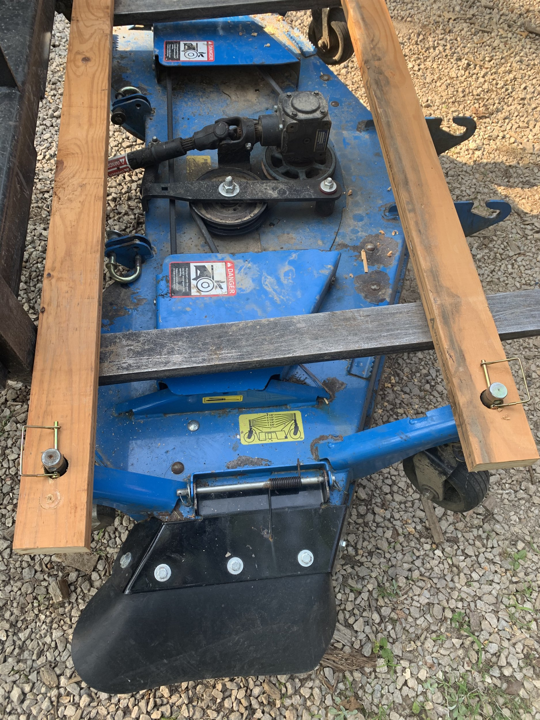

Well, here is a simple solution I came up with. It was cheap using repurposed 2x4’s. If I would have bought new ones, I might have needed to sold a kidney.

Why not put the forks underneath it and lift from the bottom of the deck?
When you drop the wheels to the lowest position (as the manual describes) for driving over the deck, the deck itself is sitting flush with the ground, no room for a fork.
   / XJ2025 mower deck #8
Try it, you'd be surprised...forks are made to "get under things".
   / XJ2025 mower deck #9
With your setup it will make for easier deck cleaning and blade replacement without the forks being in the way.
