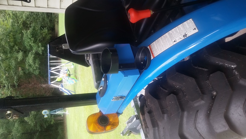

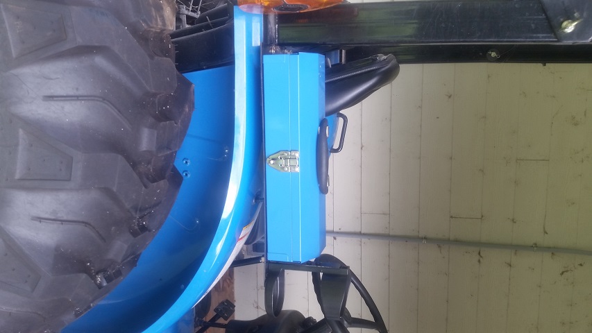

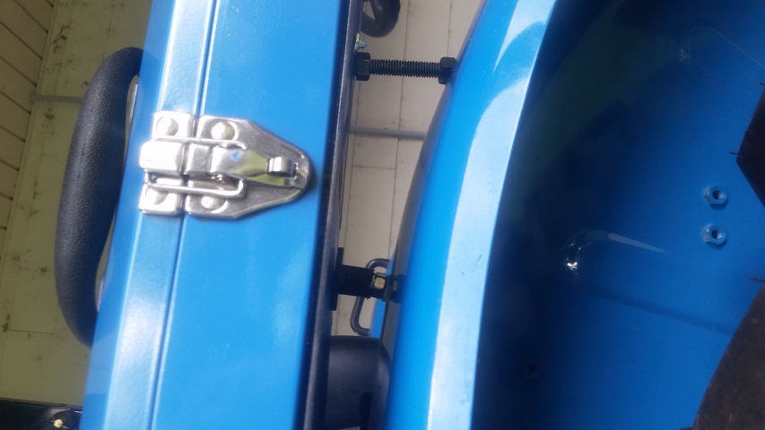

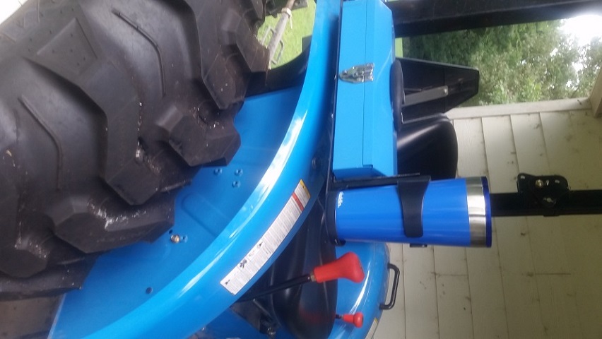

I attached a thick sheet of aluminum to the fender with the ROPs bolts and used the holes for the non existing handle for supports.
The cup holder come from Wal Mart's bicycle section. I painted the tool box with Rustoleum Safety Blue spray paint.
I haven't figured out how to rotate the photos.

Nicely Done!
   / XG3025 Tool Box and Cup Holder #3
Very nicely done! :thumbsup:

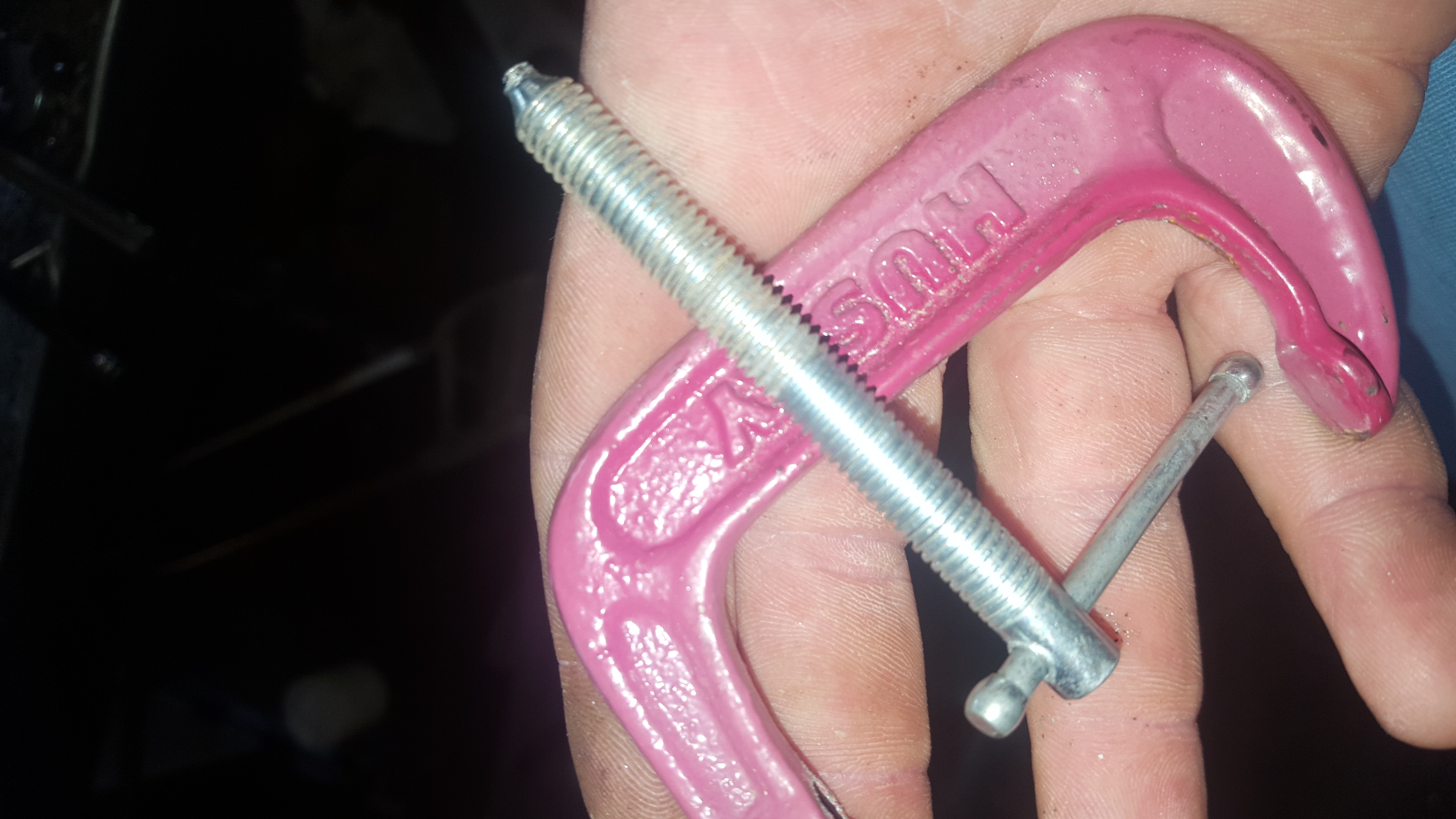

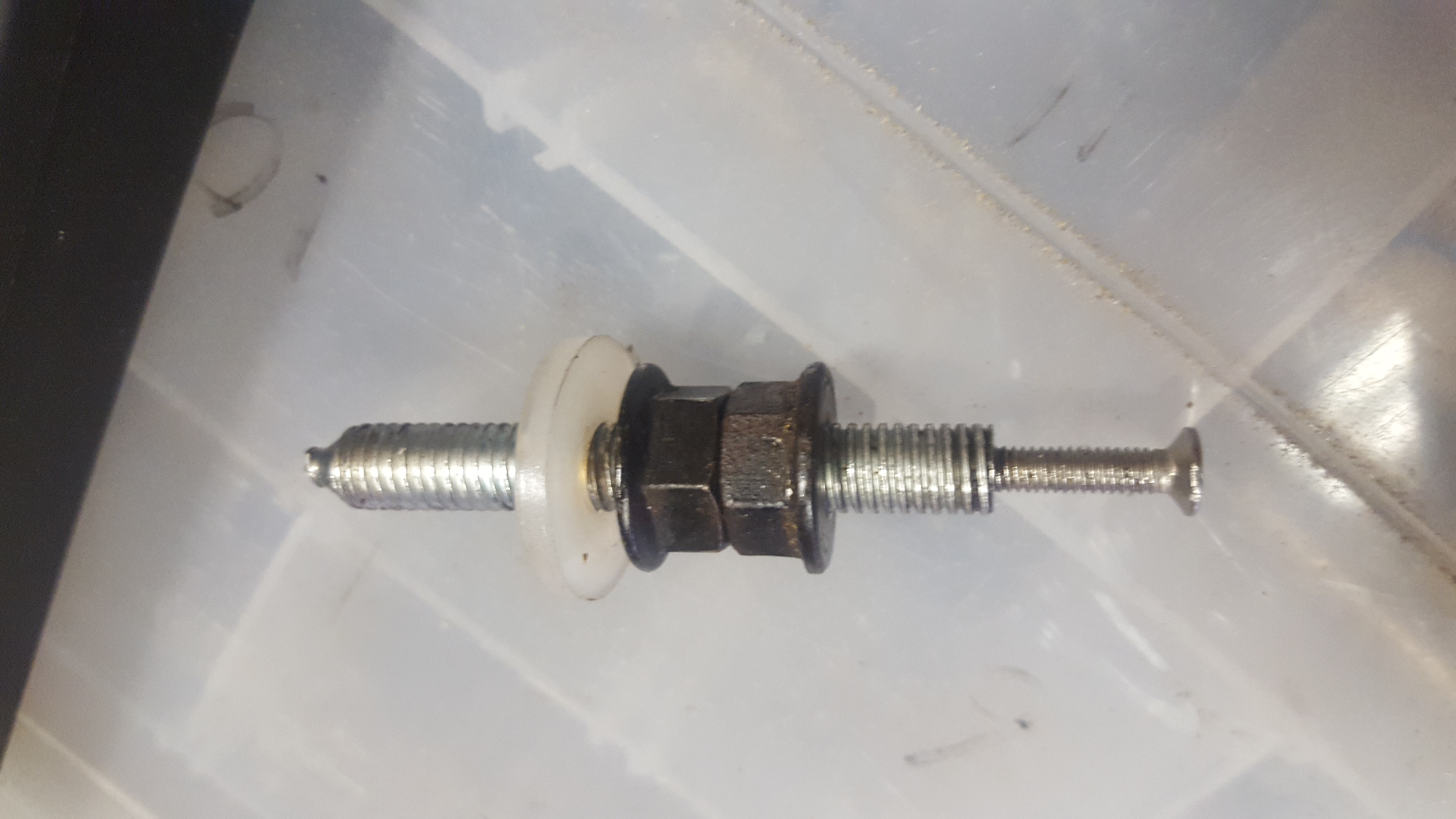

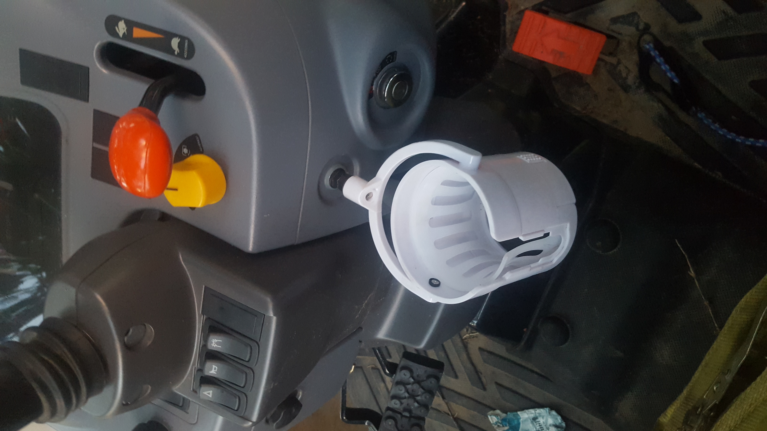

Well anyway, here's my cup holder.
It's made for motion, set inside a gimbal so the drink doesn't slosh out. Big enough to fit a coffee mug and has a slot for the handle. As long as I don't do anything crazy I can drive around with full mug of coffee, no lid, no problem.

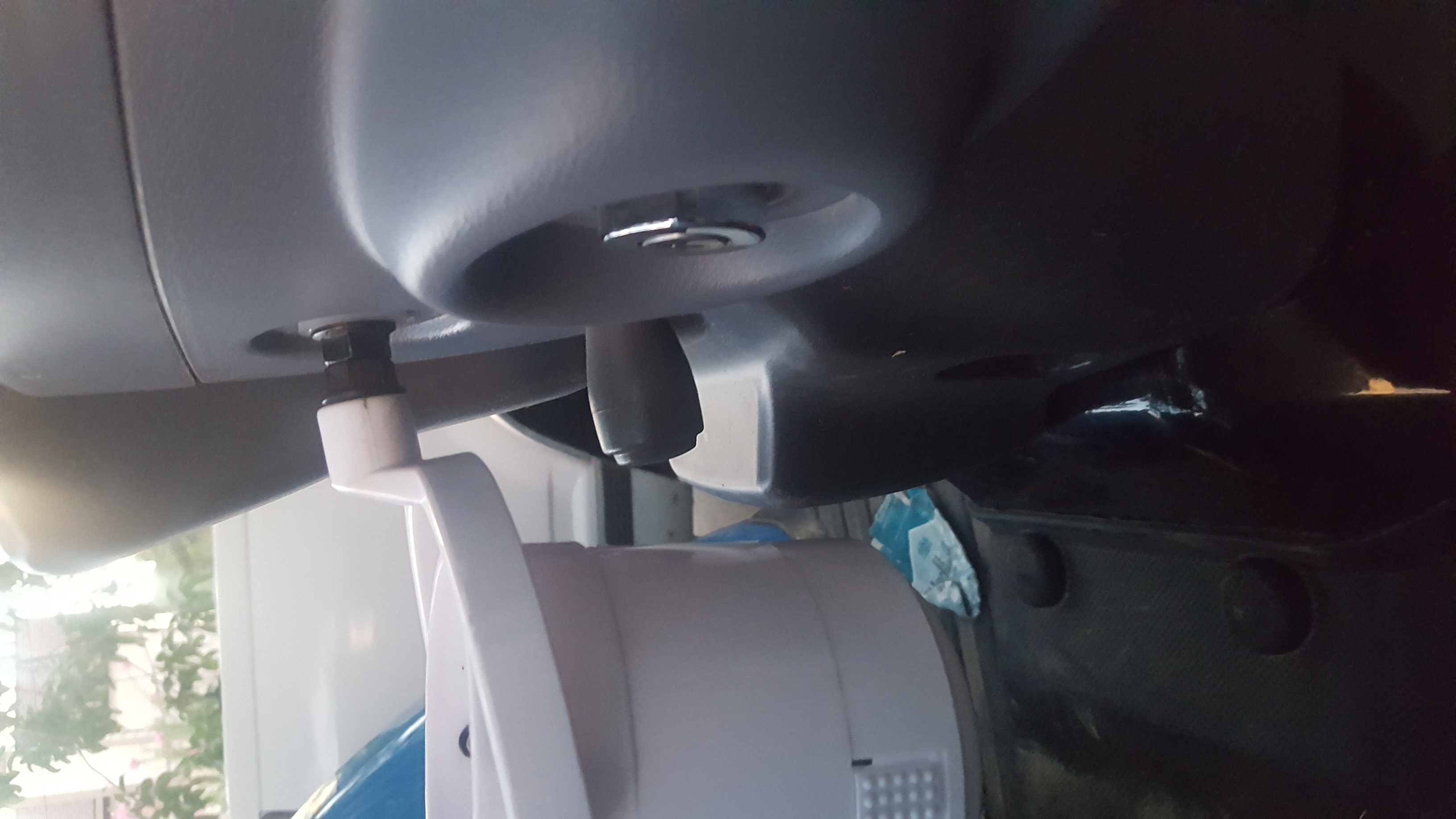

Right out of the package, they give you a few options to mount this contraption, but none that I liked. I wanted it right in front of me, oriented toward me, no reaching in strange directions and grabbing a coffee mug with handle facing out. I guess I'm just picky. I spent more than a reasonable amount of time coming up with a solution for that. I've got it attached where the dash panel retaining knob goes.

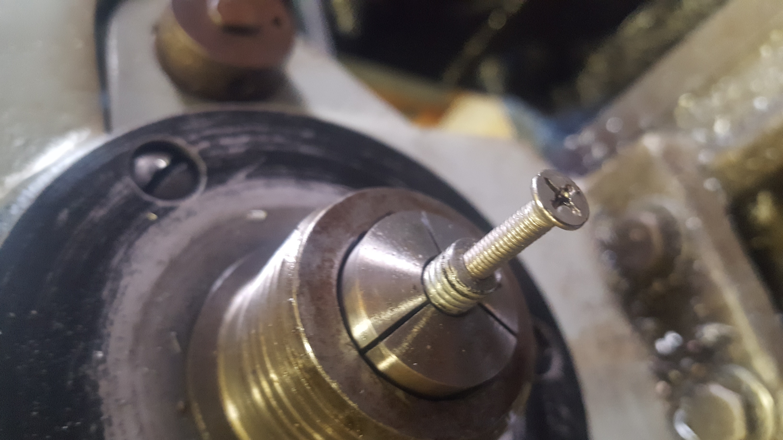

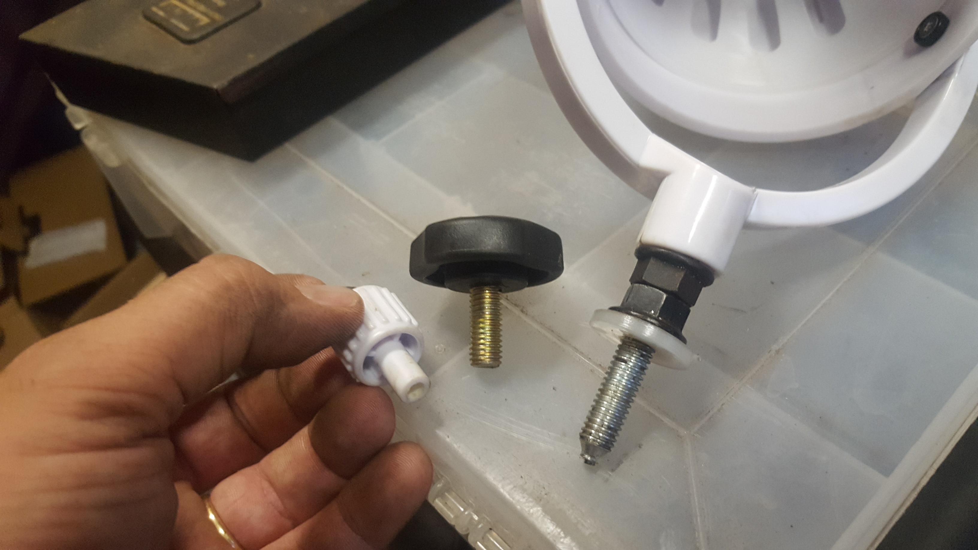

I made a custom little "Liquid Caddy XL --to-->> LS XR Dash Panel" adapter out of a cheap china C-clamp screw.
20180826_184627.jpg ---> 20180826_193818.jpg ---> 20180826_194828.jpg ---> 20180826_195028.jpg
It replaces both the dash panel retaining knob and the universal attachment of the cupholder.
I have no toolbox solution yet but it's on the to do list.

Very ingenious. I thought for a second, you were using a 12 volt power outlet...

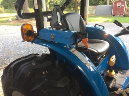

ok I got mine done today, in the midst of about 4 projects all at once, but here's the pic:
