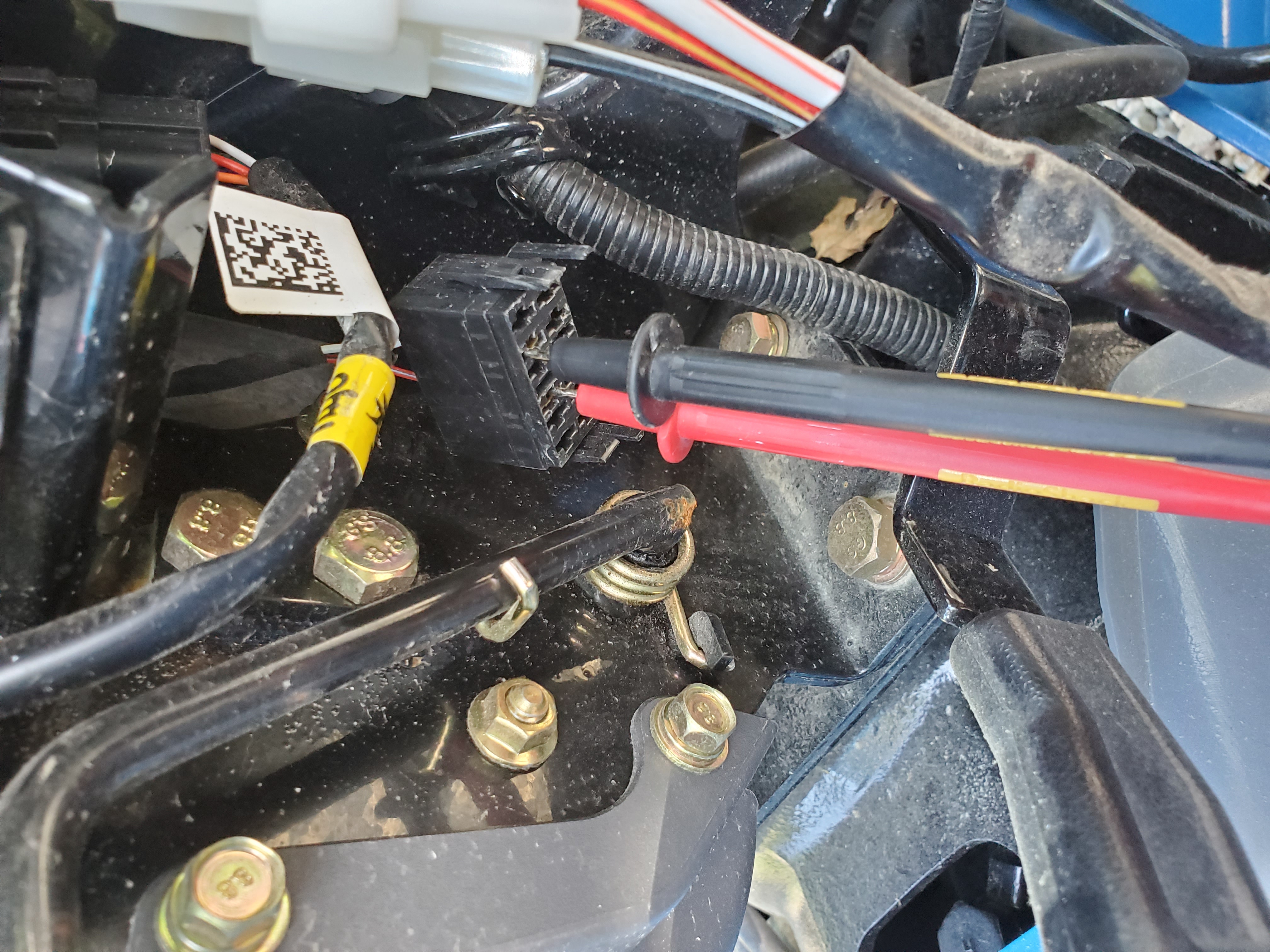

Can anyone ID these connectors on my XG3140H?
The connector by the fuse box has no voltage so I'm guessing it's a sensor plug maybe?

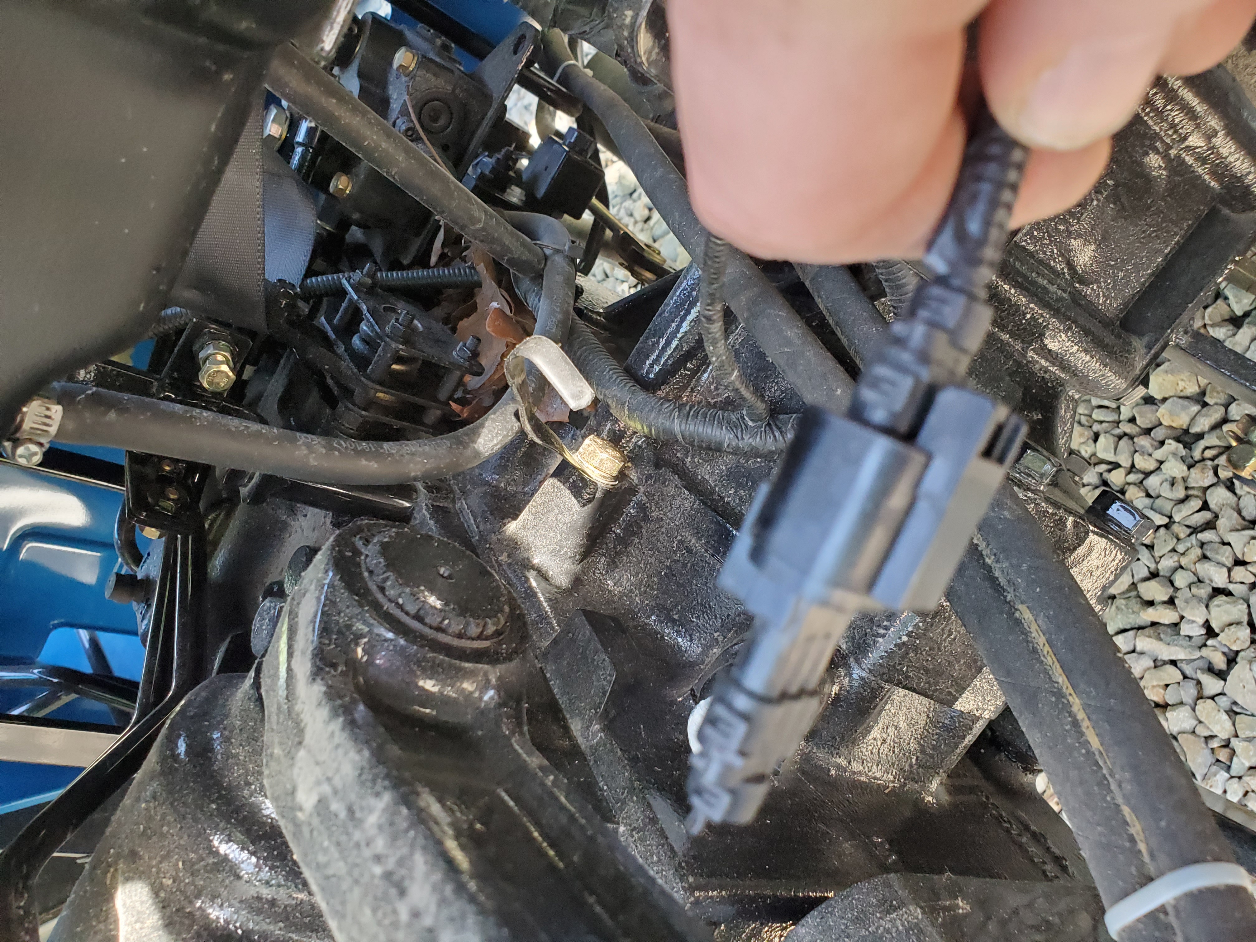

The connect on the back to the right of the 3pt with the dummy plug in it causes the tractor to die when the plug is pulled... that's fun.

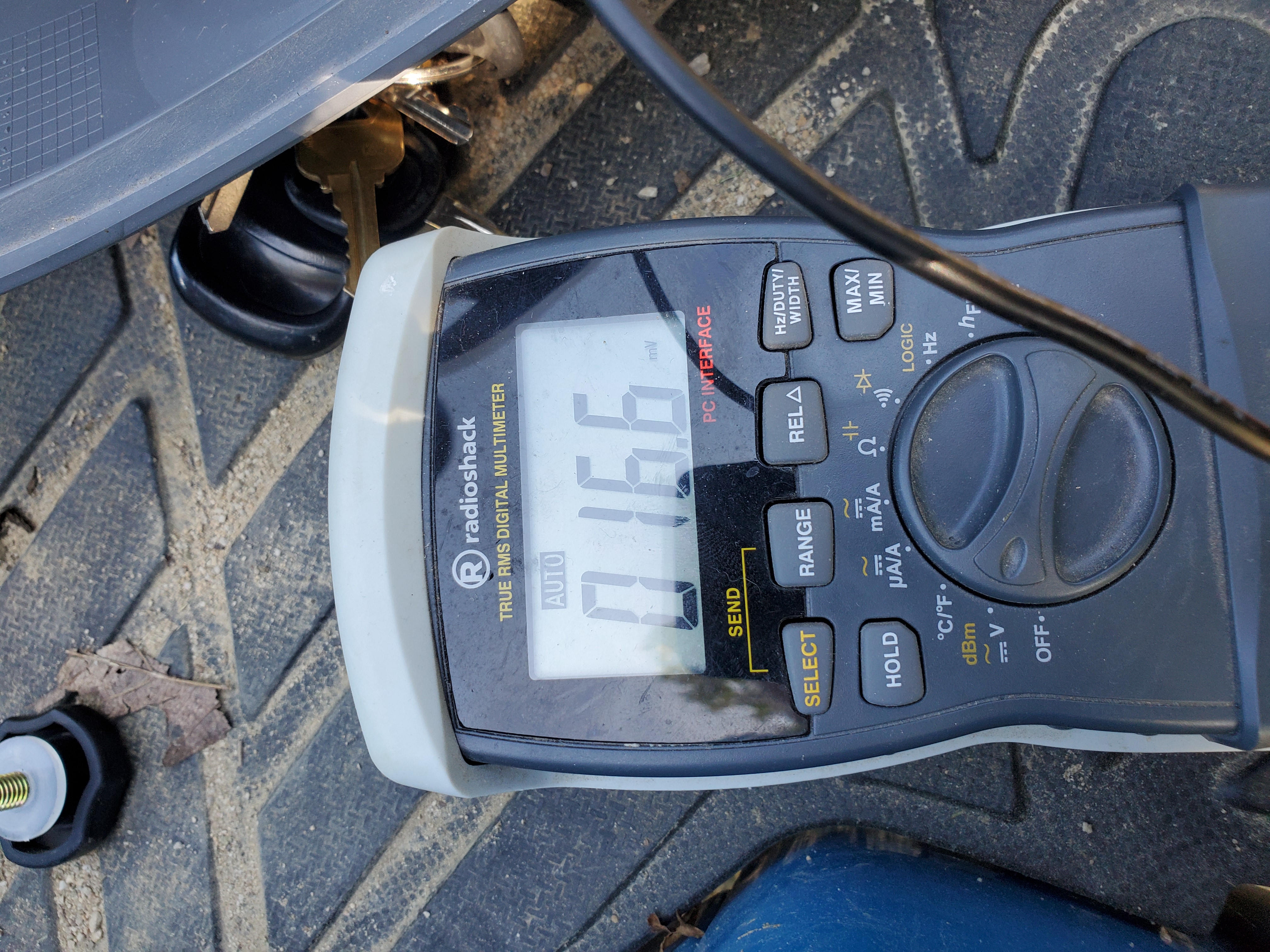

The other connector only has 2 pins and provides 16 volts?

Also, I have a fuse in the horn spot on my fuse block, but no horn or horn switch... any idea where that connector might be? I'd love to add a horn (or use it for lights or something I guess)

Ok, a couple updates from the facebook... the plugged connector is apparently a mid mount PTO safety switch connector, I wasn't paying attention to the scale, that's 16.6 MILLIvolts on that 12 pin DIN connector.

I have that same connector by fuse box on my xr4140H. They are vacant and switched. Labeled EHL and Power Shuttle. Unmount the fuse box and you can see where they go. Provide 12 vdc when switch is on. I used mine to power my camera and usb outlet. Wish I knew what the mating plug ID was so I could buy one. I just used female blade connectors.
