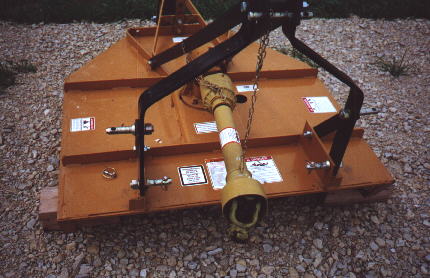

No actually, the alteration is a bit more than swapping the pins around--some must be lowered as well as in the case of the KK rotary cutter. See thread under Attachments -- lowering pins. A fellow who has a 45 hosepower NH with a 6 foot cutter by Landpride had the same problem--pins to high. This problem is then not unique to the BX but is also the case with my 2410 also and at least one guy with a big NH product. I am not sure what some of these implements are intended to fit but it ain't a small compact tractor like my two. J

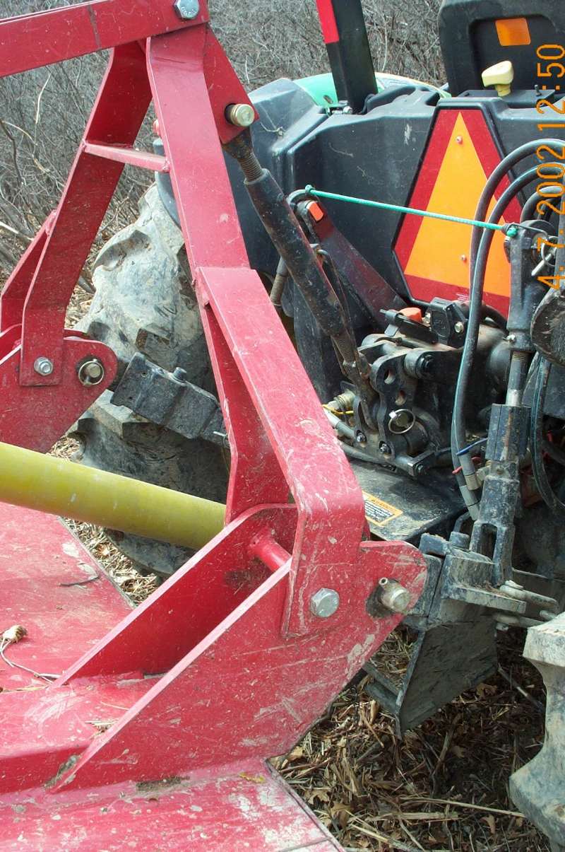

On my Massey 165, the clearance was tight using my 6' KingKutter... If they could just change the "hookup angle" on the A-frame like pictured on my Brown cutter... they would eliminate the problem... (KK's A-frame design is very simple/easy/cheap vs the recommended change I had suggested to them probably over 2 years ago...)

J,
I was under the impression that the trouble with the KK implements was with their standard line. I didn't realize that the XB lines had the same trouble with their Rotary Cutters.

Sorry, did not understand. I should think with the XB implements that no swapping or switching would be needed at all. My brief encounter with XB implements--a quick look cuz I was in a hurry---- made me think hook up would be easy. I went back to check them out in more detail and they are all gone. The brochure seems to confirm that they are set up for small tractors--quality is another issue--they did not seem bad to me but another TBN'r felt they were somewhat crude. J
