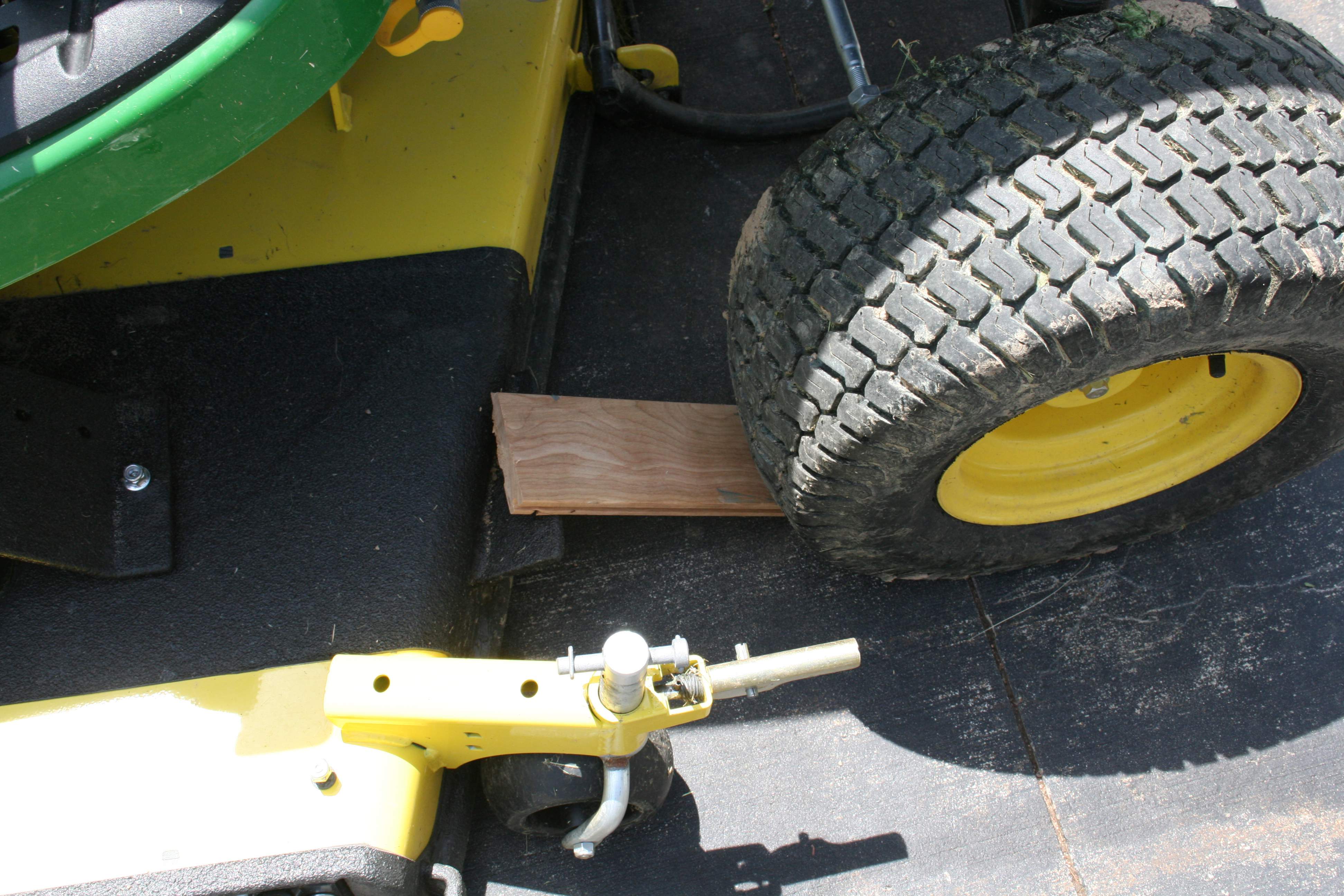

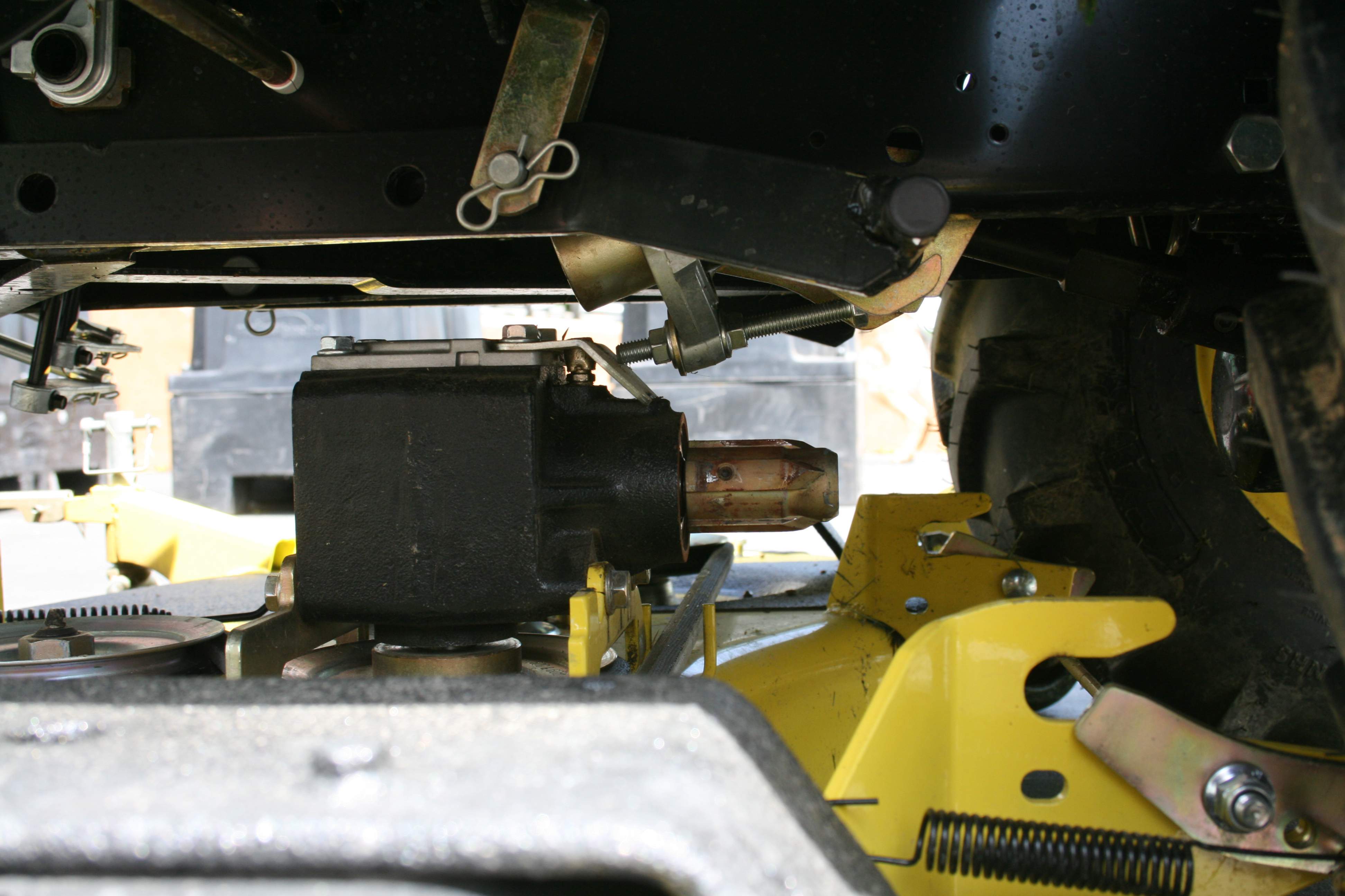

OK I took some pics today that should help.
The mini ramps thing is so simple that I'll likely not pursue a fix that allows the recommended method. The backing off is a much better method anyhow.
If I were to pursue this I'd start by trimming the protruding threads on the angle adjust/stop screw. These threads contact the ramp first
Using the ramps the deck has absolutely no inclination to slide and it drives over with ease.

   / X750 drive over deck/auto connect. #5
In your second photo, if I leave the cams on the gauge wheels open like you have them, they can get jammed in the tire and can be damaged or damage a tire. In my case it is on a X739 with 54" drive over and HDAPs. The HDAPS barely clear the gauge wheels on the 54 with the cams down. To open the CAMs while the deck is under the tractor, you have to be careful. Just FYI for new/future owners.
It is fairly easy to drive over front or back with AWD, as long as the deck isn't rolling on the gauge wheels. My experience is without autoconnect.
Good point on the latches. I bent one on Ma's trying to horse it up and over. Things are plenty close on the 60" decks let alone the 54"s.
AWD are instructed to back off/drive on. RWD can’t climb the non driven tires over w/o a ramp so Deere’s imperfect solution is to drive forward. Problem is the clearance of the auto connect over the gear box. This is solved with the ramps.
