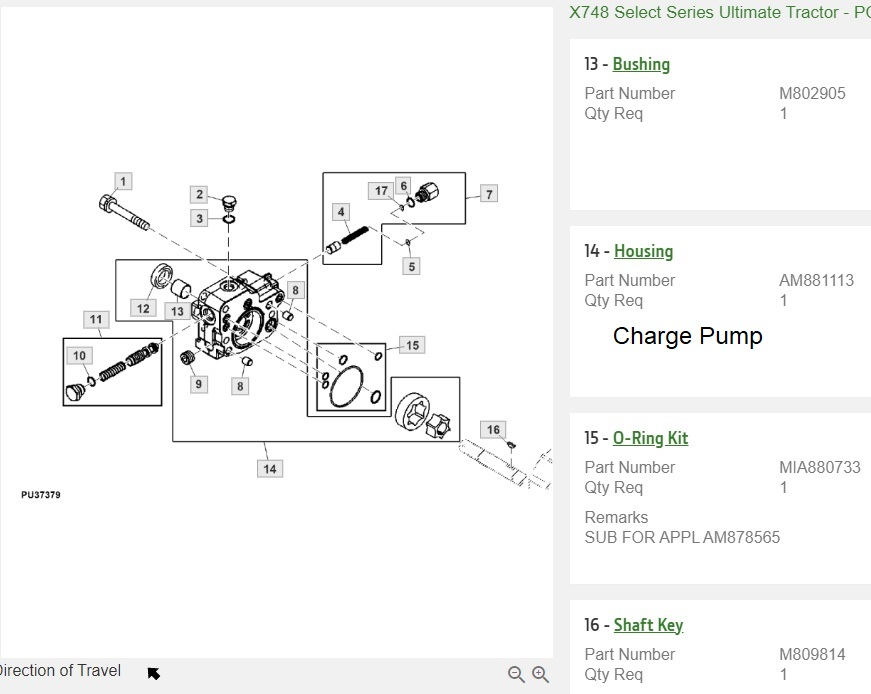

Today I was checking out a JD X748 with a 60 inch deck. The owner tells me that is nothing wrong with it. He buys, fixes and sells mowers. This machine has 2700 hours on it. That is nothing for a diesel engine. The hydrostatic drive works great in forward and reverse. There is no hesitation or chattering. The steering and deck lift however is a whole different story. Regardless of the rpms and if you are sitting still or moving, they both chatter. The steering wheel just jerks as you try to turn the wheel in either direction. The deck lift jerks when lifting. Where is the charge pump location on these tractors? Is it internal or external? My guess is that a relief valve is not set right or has a busted spring. Worse case the pump is junk. The cost for a new one is around $1400.00. This has to be figured in with the buying price. TIA

   / X748 Charging pump location and issues
I doubt that it is air because I ran the tractor for at least 20 minutes and drove it around doing full stop to stop turns with it. The hydraulic tank is full with no air bubbles on the dipstick when I checked it afterwards.
The charge pump is on the front end of the transaxle on the outside. At least it is not on the inside of the transaxle.

Good plan...
Charge pump
Yup, that is the part.
