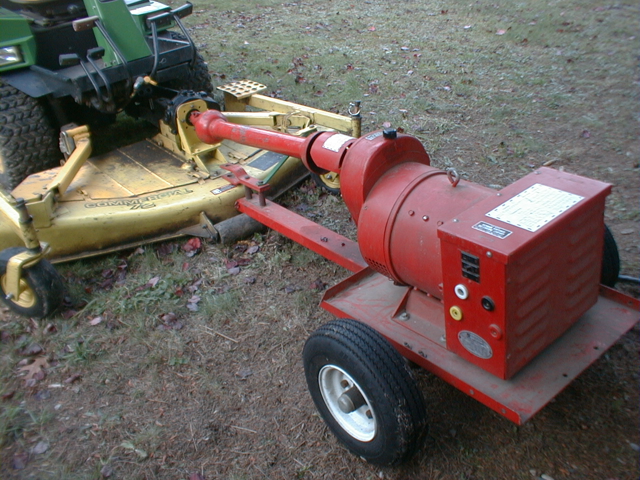

I easily run my 50kW Winpower off a pto adaptor on my 22 h.p. JD F-935 lawn mower. Of course it will run it, just not up to 50kW. That would take a 100 hp tractor (theoretically). With normal power needs, it never hits the governor.
I guess, the manufacturers are like everyone else and concern for legal issues and probably being sued if one cannot get the maximum output. I reality, I'm fine with between 8KW and 9KW out of a 18HP PTO. I appreciate the responses. I also assume John Deere has underrated the HP of the X744 PTO. As previously mentioned, they once sold there own 10kw generator for the X700 series. But, who knows who really manufactured it. Everyone has to be concerned about sue crazy folks out there.
