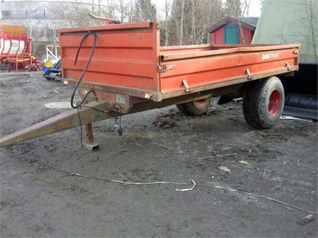

Yes, drive down steep hills or roads with a heavy trailer can be very dangerous, you need a very heavy tractor or have brakes on the trailer.
Even a small one like this can be hard to handle.
