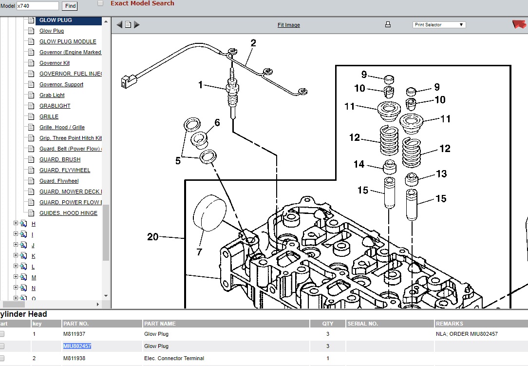

I looked at the glow plugs and it seems they come out straight upward, but a chunk of engine, maybe intake manifold or something is directly over the top. If the wire just pulls straight off that would work. I need to google or find out somehow how the wires come off first.
I will take a look at them again tomorrow to see if I am looking at them correctly. I like the test from the harness and checking all three at a time for starters.

I just found this on a Gator forum. I'll check it out tomorrow, maybe.
1. Park machine safely. See "Park Machine Safely" in the Safety section.
2. Raise and lock cargo box.
MX37356
3. Loosen hose clamp (A) from air cleaner hose and disconnect hose from intake side of rocker arm cover.
4. Remove bolt (B) from wiring clamp.
5. Remove six long (C) and three short bolts (D) securing valve cover to cylinder head.
6. Remove rocker cover.
   / X740 JD starting hiccups. Glow plugs? #6

I stopped my crying and took all the stuff off from the top of the motor live valve covers and air intake. I could get at the glow plugs easily then.
I hooked my negative welder cable to the positive post on the battery and clamped the glow plug body on the other end. Then I put the post of the glowplug on the negative post of the battery. One started heating up right away and 2 did not. So I had 1 good one.
I priced on the internet and greenparts.com and other places were 40+ apiece. I called NAPA next door for a cross reference and they were 15 apiece. When I went to pick them up I asked for a military disc and I got them for 12.50 apiece.
I got them in and they work great.
Thanks for the input.

What are the NAPA numbers for future reference?
