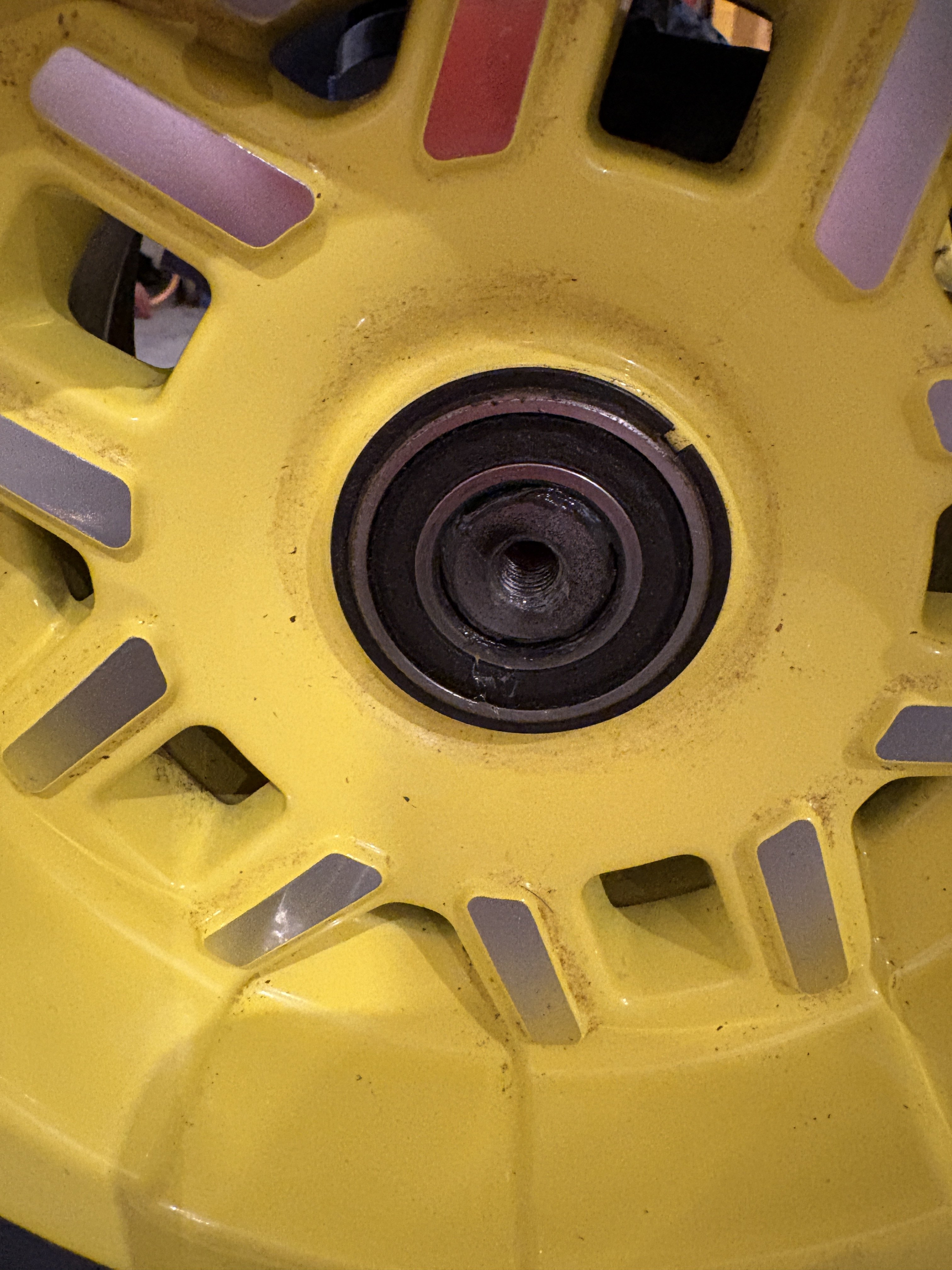

Thought this would be easy, a simple tire change-out but nope. On the X730 they have "Fancy Hubs" (attached PIC). Than X730 Manual is less than stellar, shows a pic with 5 hex bolts...... anyway Image 5301 is what my question is all about, if you zoom-in you can see the split in the retaining ring, 2 o'clock or for sailors, about 015 true. Question: what tool do I need and how to remove rim. Thanks

Bearing should slide off the axle with that bolt removed. They may have some crud and or rust preventing them from sliding off.
Bearings should be a press fit in the rims.
   / X730 Front Tire Removal Help #3
Seems with the bolt and cap washer removed, nothing more to do than knock the tire off the axle.
