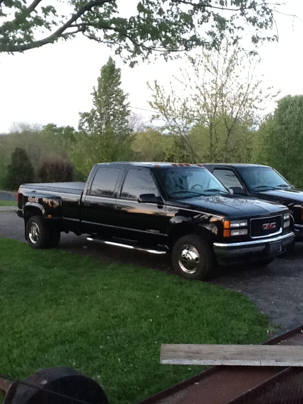

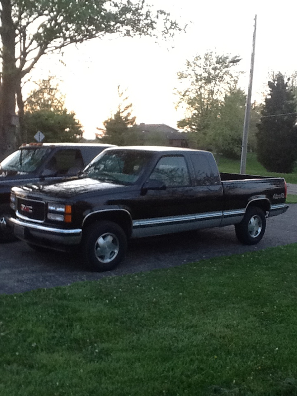

I have a 97 z71 from Seattle Washington with 36k on it never been undercoated and it looks like the day it rolled off the assembly line. And also 2000 1 ton dually from michigan with 48 k on it and the there is a night and day difference in them. The salty environment is terrible for vehicles. Luckily I have a garage for both of them and a old beater truck for the winter. I'm pretty particular about my stuff and it is way to expensive to replace to just let it rust away. I see it everyday peaple just destroy 60k vehicles like its know big deal. No one seems to take any pride in what they have.
