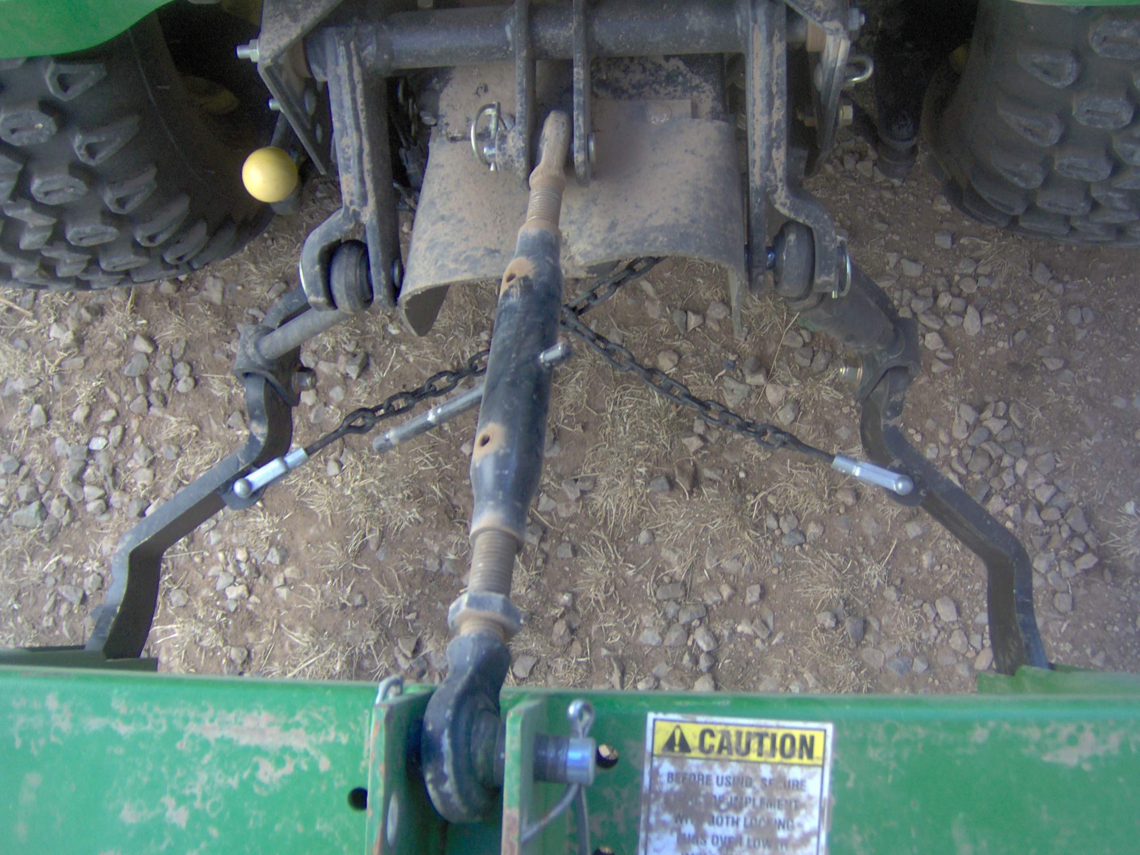

Do any of you guys have a 3 point on your X series tractor? I've had a 3 point on my X748 since it was new 7 years ago. I don't use it much, but I do have a 647 tiller, a disk, and a sprayer. I've always noticed that it seems too wide. The arms have to be pulled all the way in to make it the normal CAT 1 spread. The sway chains don't have near enough adjustment to tighten up. It seems like the arms want to be 4-6 inches wider than standard CAT 1. It just seems odd. The ball ends can barely compensate for the extreme angle of narrowing it up so much. What are your experiences?

I have the cat 1 hitch and IMatch on my x749 and will try to get you a picture in the morning. It has worked well for me so far and with the IMatch pinned on it doesn't move much sideways. It dowsn't replace the larger tractors but it is useful in tight quarters work.

Pictures would be great. It seems like my arms are too wide. They do move in enough to get the CAT 1 dimension, but barely. It almost seems like they are the wrong arms. I might go the iMatch route.

Heres some pics of the rear hitch let me know if you need something more specific. Just finished putting in a new lawn for a customer yesterday so time to clean everything up.

Here's some pictures of my x728 with a 647 tiller if it will help. The tractor is a year 2010. Putting on and taking off the 647 is really easy and fast. It is a Cat 1 X700 series hitch BM22286

Hey Rob. I have an X728 with the three point hitch and yes I have to spread the lift arms almost all the way to hook up a Cat 1 implement. I don't even use those sway chains. There is no need. I generally get one side in at an angle and then push it as far as I can to hook up the other side.

Thanks for those pictures, Yours has the same geometry as mine...Looks like it wants to be wider judging by the the angles of the ball ends, and the sway chains look quite loose. I took a couple links out of mine.
