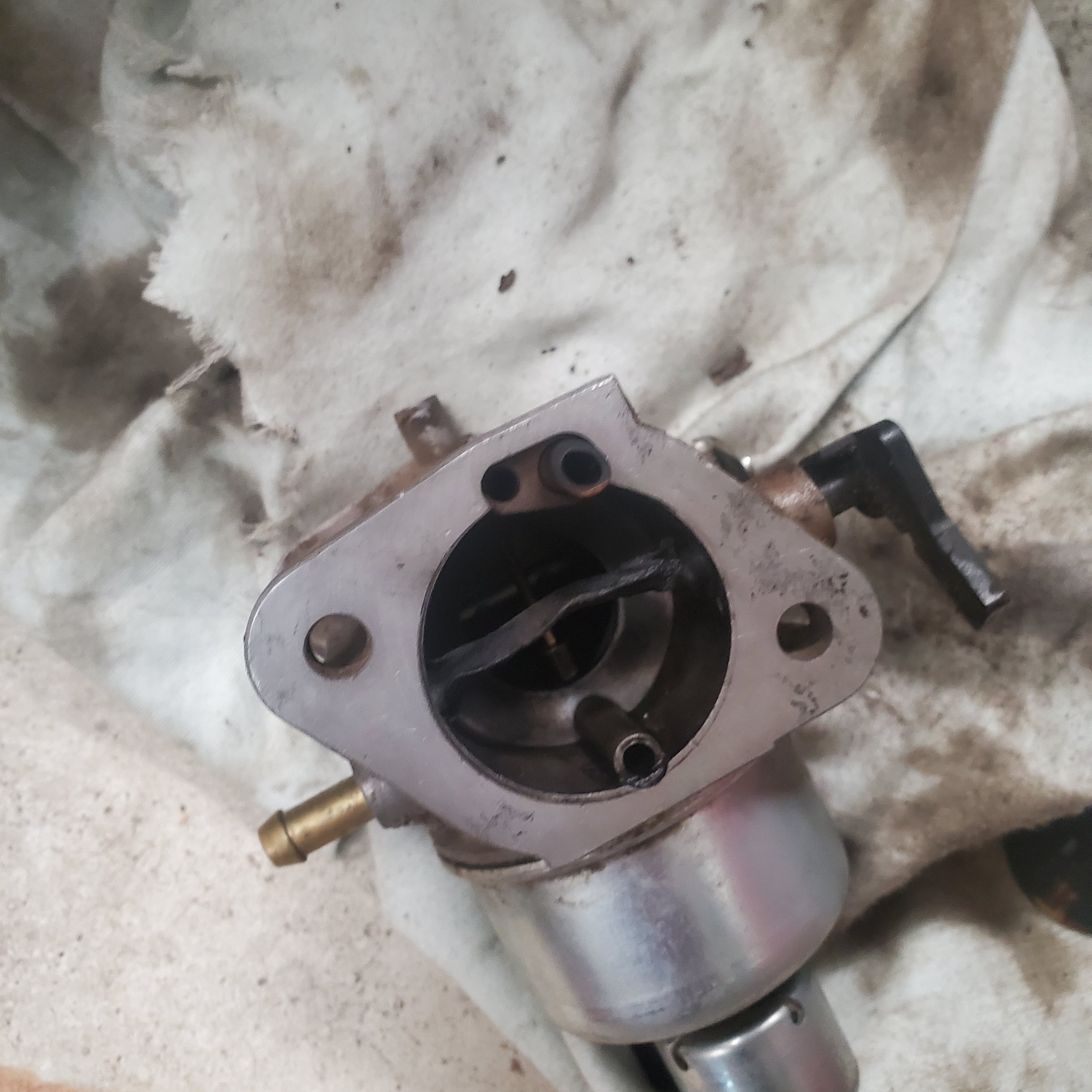

I have an X530 I've had for about 2 years. Late last season it started having an issue where it will stutter when I engage the blades at full throttle. Usually this happens when I've had to stop the blades to move something or back up without pulling up on the engagement lever, then go to restart the blades.
It almost sounds like its backfiring. It will go on for about 5 seconds and then resume normal operation. I figured it was a fuel flow issue, but then I noticed that it doesn't happen when I do it at half or less throttle, then go to full throttle after they're engaged.
I've had some other issues I've fixed and things I've tried so far that I thought could be contributing, but the issue remains. So far I've
had an ignition coil go out and replaced
found my choke lever wasn't returning to the open position, but fixed that too
gapped and replaced plugs
Any thoughts on other causes?

Little update to my woes.
I tried the choke when engaging the blades and that didn't make much difference. (More on that in a minute)
I began to notice a stutter more during normal operation so I decided to check the coils again. Lo and behold now the other coil wasn't firing. So off to the parts counter I went for another coil.
Now we're firing on both cylinders and I'm ready to mow. Only now when I get up to full throttle I'm getting puffs of smoke (smells like unburned fuel) and if I commence cutting I'm really bogging down and losing power.
So I decide I better take a look at the carb. I get it out of there and where the choke valve should be is a melted looking piece of plastic. So at the very least I've been running for some time with no choke even though I thought I was giving it choke.
Anyone ever try to replace just the choke valve or am I looking at a whole new carb?
***EDIT BELOW***
Well my coffee kicked in while I was looking at the schematics of the carb and while I was wondering where the heck the old butterfly valve went as all I had in the choke end of the carb body was a melted strip of plastic.
Then I recalled when I took off the metal air intake piece on the front of the carb there was a piece of metal in the throat of it that looked like some sort of baffle plate. Out to the barn I went and there's my butterfly valved lodged in the air intake. I'm guessing that backfiring I was having before must have blown it off the plastic rod, lodging it there, and also melting the plastic rod.
So rather than no choke, I've been running full choke as the butterfly was lodged in the intake in what would be a closed position.
Guess it's back off to the parts counter...

When you get this re assembled, verify that your choke control cable isn't travelling too far and putting stress on the choke shaft.
