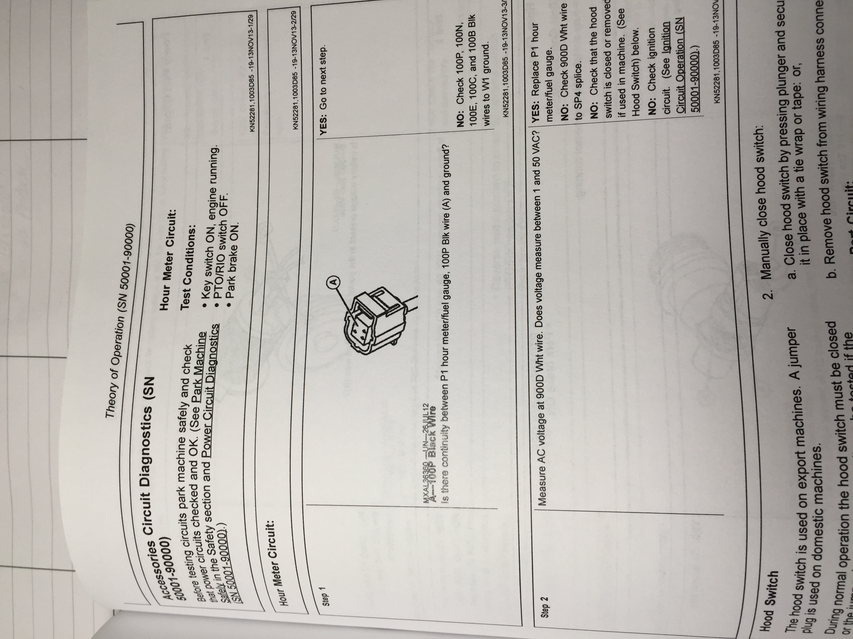

There is a page in the technical manual that deals with testing the hour meter circuit. They have you measuring an AC voltage with the engine running. I've attach a photo of the page.
   / x500 hour mtr not working
Thanks. Checked this morning. At the connector for meter 3.4-6 steady volts ac, sp4 is at x6 connector volts are 3.4-6, yet meter works for 5-8 blinks of (.) then stops. All had been working fine until pulled engine to change gasket between top and bottom of engine. My daughter was mowing 4-6 weeks ago and tractor quit once, not sure why. She is small, may have been seat safety, because farm land is uneven. Thanks again.

IT'S FIXED!
Bought manual. Did test, had power on yellow, said replace gage, no change, other than lost $'s. Did more testing, appeared to be interlock module from manual's limited diagnostic's of the interlock, new one installed, no change. The manual shows that the Blk. wire, changes to white, at a connector and once the key is in the on position, then started, the wire pick's up the impulse from the coils, through the interlock, to hour meter for recording, still no change. The engine seem to take longer to shut off than prior to the issues. Pulled shroud to check coils, if you grounded the coils the engine would not shut off, what was shutting the engine off was the fuel solenoid. The manual said when key is turned off the interlock was to ground the coils and close the fuel solenoid to stop engine, that didn't happen. Put two new coils on, and left new interlock module on, old hour meter and all was working correctly. I have no idea of what caused the coils to short out internally, other than the interlock module. I did not want to chance putting the old module on and loosing two coils.
