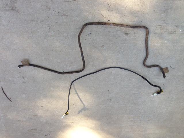

Had a leaking EFI fuel line so I ordered a new one from Green Dealer (Part Number AM135313). Part arrived today and it's 1.5 feet shorter than the original. Called Green Dealer and it's supposedly the correct part but I can't for the life of me figure out how to route the new line and have it be long enough. Had anyone run into this issue and how did you resolve it. Thanks.

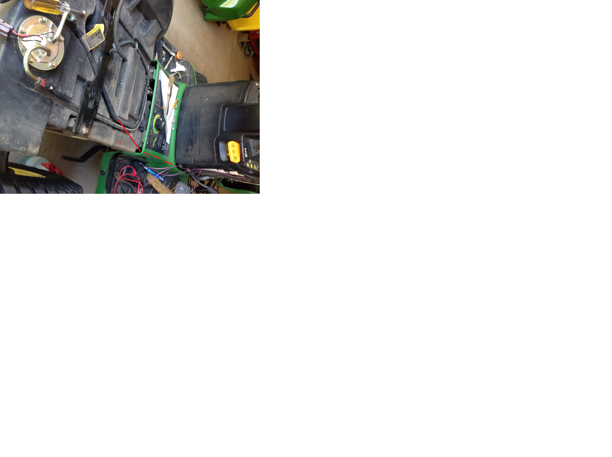

Shot a pic of the X485 fuel line (now exposed) and wonder a couple things.. if they re-route the line direct to the filter on the right side.. (red line in pic). Would be shorter than shown switching over to the left side and forward, then back to the right side to meet up with the fuel filter.
Second thought, looking at jdparts it can be confusing as there was a s/n break and change at 40000. Found another part # for the fuel line (Engine F711D) that was AM135314 but replaced by AM140651. May or may not explain the difference in line lengths.

Where does the line go, there are several lines? Maybe they sold you filter to injectors when you needed tank to filter?
Line goes from fuel tank to fuel filter. Picture below is old and new with the new line on bottom.

Tried the routing you highlighted in red but still too short because it has to get around all the hydraulics on that side of the machine. I talked with the local JD parts guy and he said I ordered the right part number but has no way to know if the part they sent was actually that part. You would think it would be labeled but apparently not. I ended up buying a used one online. Not my first choice but the tractor has been down now for over two weeks and need to get some mowing done before my wife decides that me push mowing the 3 acres is a good choice.
