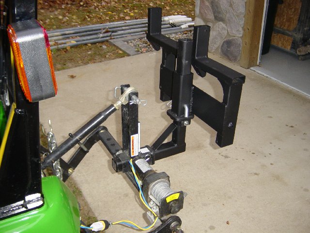

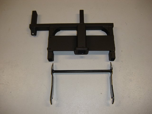

This is the setup I came up with. Had to cut off the lower section of the frame and had a plate welded across the frame with a 2" receiver attached.

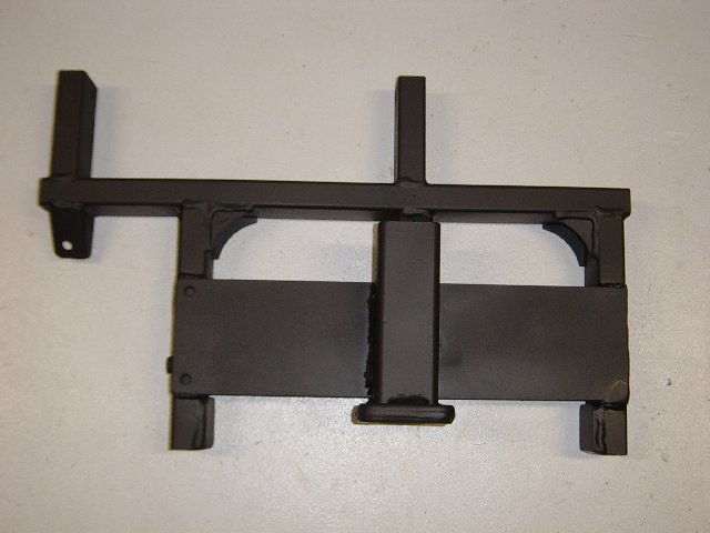

   / X-Series to 2210 bagger conversion
#2
plate and receiver attached

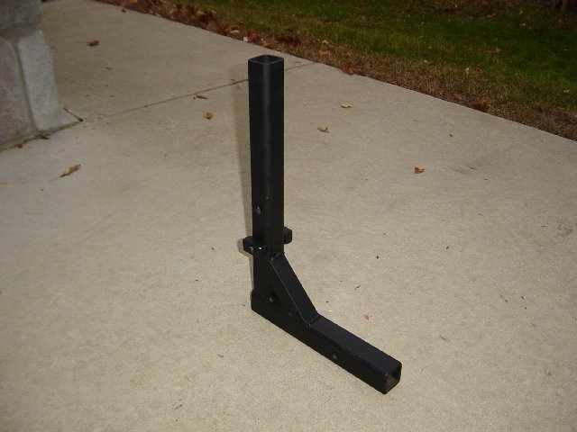

hitch mount made out of 2" square tubing

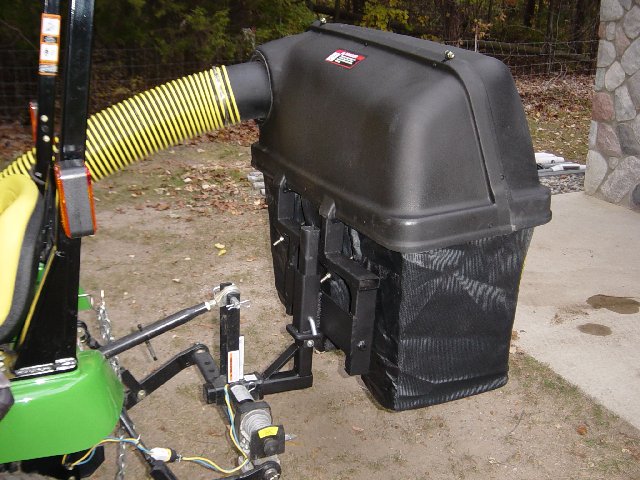

frame attached to hitch

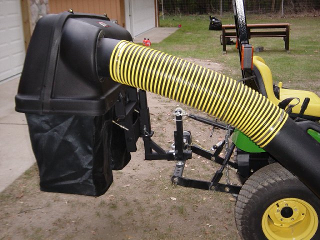

see attached
file attached

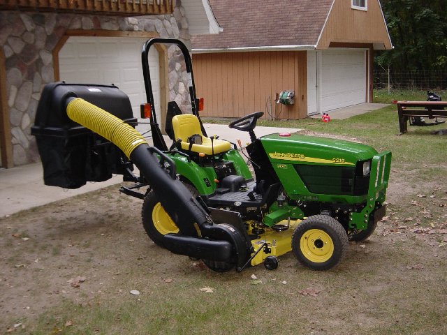

complete setup
   / X-Series to 2210 bagger conversion #8
Hi DonS, that is a very nice setup! You will probably get alot of "x series" owners like me thinking about selling the tractor and keep the MMM and bagger system. Let us know how it works. I new someone, someday would come up with a modification that would allow you use a 3 bagger poweflow setup on a 2210 or 2305. Maybe you should take that design to John Deere and get it patented and make money while they sell your design. Congrats!! Russ /forums/images/graemlins/smile.gif
