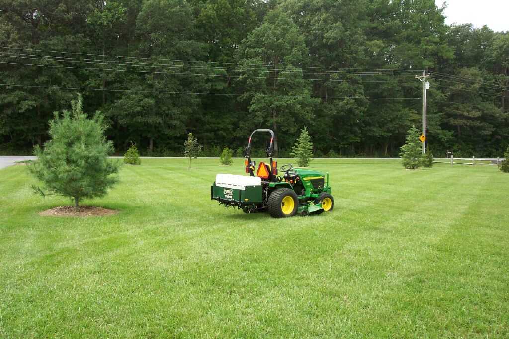

Well, I'm fortunate to be able to cut every 4-5 days and I have no problem with very healthy fescue. I've never had to double-cut. I have cut it long and come back for a shorter cut two or three days later. Even if I were to have to cut it twice in a few days, it's still twice in a week /forums/images/graemlins/grin.gif That happens once or twice a year in rainy season. I used a mulching kit with my JD445 with 60, my 2210 w/62C, and now with my 4110 w/60. My lawn and tree braggin' pic is attached /forums/images/graemlins/cool.gif

Very nice lawn!
