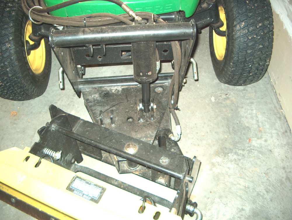

(Except I did weld another set of 'ears' on it to move the lift cylinder over and get full float, rather than 'float with some downpressure' that comes with the X series. Sure makes a world of difference when using the front 54" blade).

   / X Series Front Hitch Questions #5
There is a 'fix' by Deere that suggests (because there is so much down force on the blade even in float) that wheel weights should be added to assist steering. Give me a break.
The problem exists when the x series had a hydraulic cooler change, that made the float act this way.
The new ears are welded such that there is a slot in the lower ones that allow the ram to travel full throw without pressure on the blade.

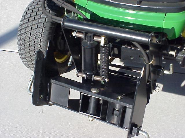

Here is my attempt at negating the down force. I installed a spring in parallel with the cylinder. It works well enough to make the front blade usuable on my large concrete drive. Without it, the shoes would wear out in a short time (actually I couldn't stand the skreeeeeching sound!). I have used this arrangement 2 years now here in Wisconsin. I can't remember where the spring came from other than it is John Deere Garden equipment and is 8" long eye to eye and is 1 1/2" diameter.
Joe

Joe,
It looks like most ofthe parts are "off the shelf" except for the top spring mount. It appears to be machined.
Is the bottom mount machined too? Some close-up pictures would be great!
   / X Series Front Hitch Questions #10
I didn't want to make any welds or mods if I could help it during the experiments. So what I did is simply replace the bolts that hold the cylinder with longer high grade bolts. I made the spacers out of steel bushing material (thick pipe) and then used some brackets to prevent the springs from coming dislodged. I think I used the nylock type of nuts. Intially I used 2 springs (that is why there are spacers on both sides of the cylinder) but that over corrected the settup. Hope that helps.
Joe
