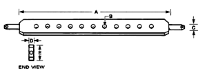

Drawbar pic

Inspector,
Maybe I am using the wrong terms. I have seen the 3pt draw bars, but mine YM1810 has a frame mounted
bar. I see some tractors call this a swinging drawbar. Thats what I want to get ahold of. Ill have to get out to the barn and get a photo for folks today.

   / WTB: drawbar #9
GWS....I agree with the terms you are using and also agree that what you want is a frame mounted drawbar. Some are swinging type and some are not, but I hope you will not use anything except a frame mounted drawbar.
The alternative type would be the 3pt drawbars. I've used them, survived the experience through dumb luck, and wish I could convince others to consign every 3pt drawbar to the museum (scrap metal) pile.
If you are tempted to use the 3pt drawbars please read this artice at: http://aepo-xdv-www.epo.cdc.gov/wonder/PrevGuid/m0040898/m0040898.asp
Yes, that's a three line URL! I just tried it and it works....
3pt drawbars are dangerous both because of the extra pivot and because it is so easy to raise the 3pt to axle level. No matter what you think, your reactions are NOT faster than a tractor rotating around its own axle. And ROPS is not very effective in that type of wreck. I escaped injury because I just happened to be looking at the front wheel at the very moment that it left the ground and got the clutch in about 1/10 of a second later. My tractor was near vertical at that point.
Thanks to Wayne For the URL from his collection.l
