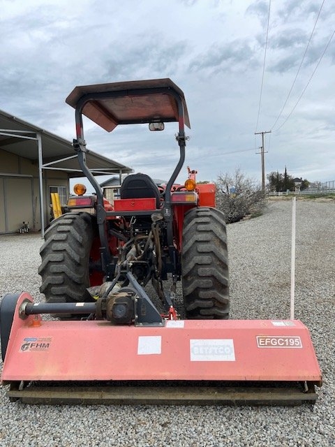

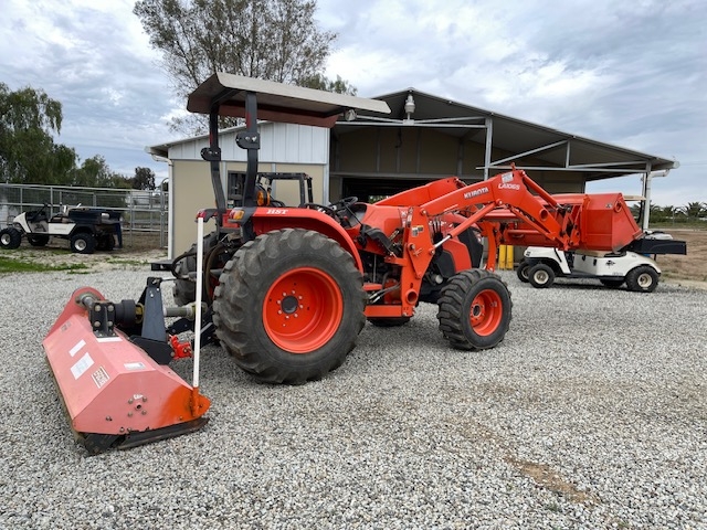

I mow tight against the fence with an offset flail mower. Works pretty good. The PVC pipe is a visual indicator of where the edge of the mower is.
