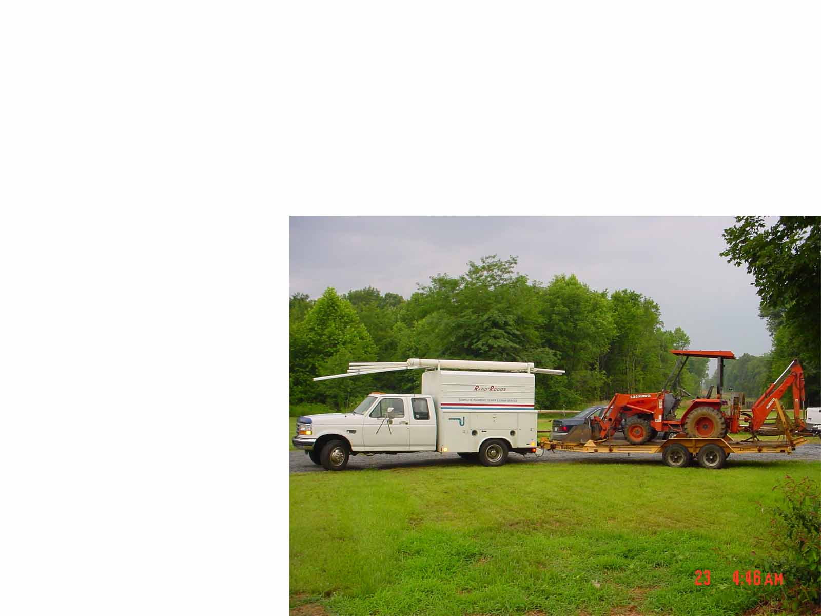

I didn't know you could pull an L35 with this truck, F250 or something? I don't know. Not sure why I thought that but that's very nice to know for future reference. This is a company I found on the net while looking up L35's. I'll put their backhoe and their trackhoe pics. on. Their trackhoe needs a thumb though.... /forums/images/graemlins/smile.gif

oops.

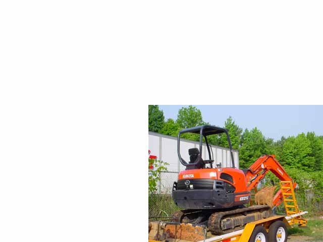

here's the excavator.

   / Wow, didn't know you could pull with..... #4
Re: Wow, didn\'t know you could pull with.....
F350... the brochure I have for the newer body style listed F350 with diesel rated at 13,900lb with a gooseneck trailer.
All bumper hitch trailers are limited to 10,000lb on light trucks.
** I should note that the rated weights shown include the weight of the trailer. If one's gooseneck weighs 4000lb., one can only haul 9,900lb. on it. Same situation for the bumper hitch.
