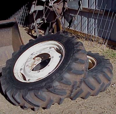

I bought tubes for these tires ( 11.2 x 24 ) from a local tractor / truck tire shop for $30.00 each. Made in Korea and felt as heavy as any others I've looked at.
