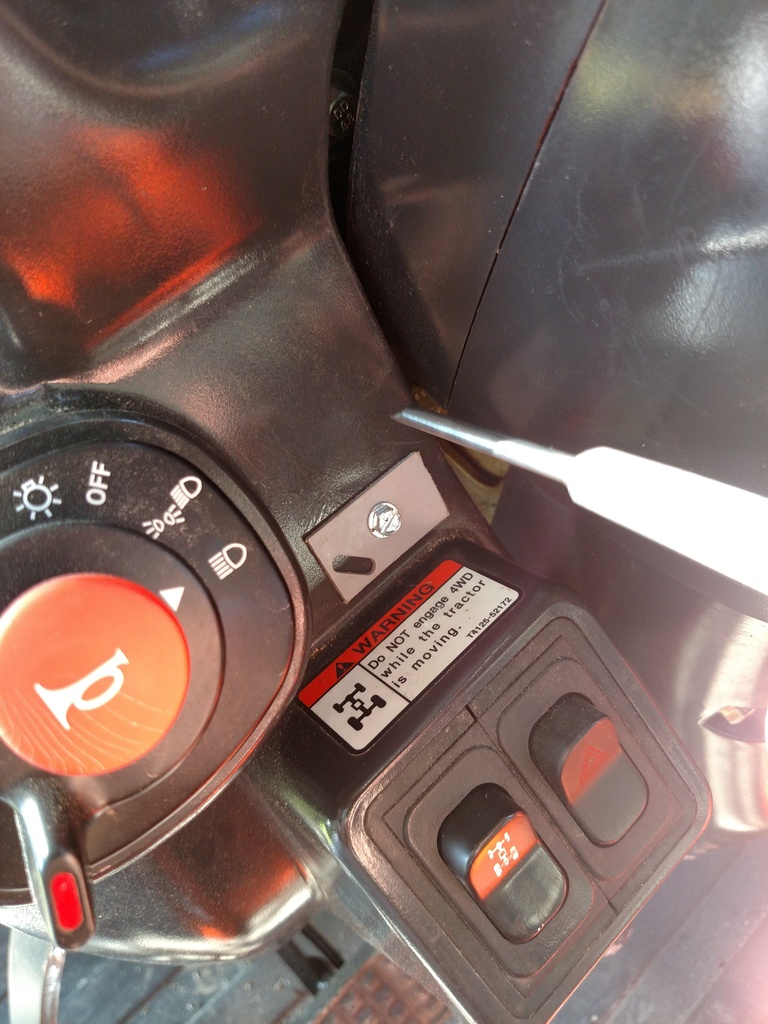

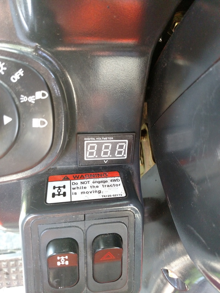

   / Would an alternator be the cause of this? #5
I installed a permanent one.:)
