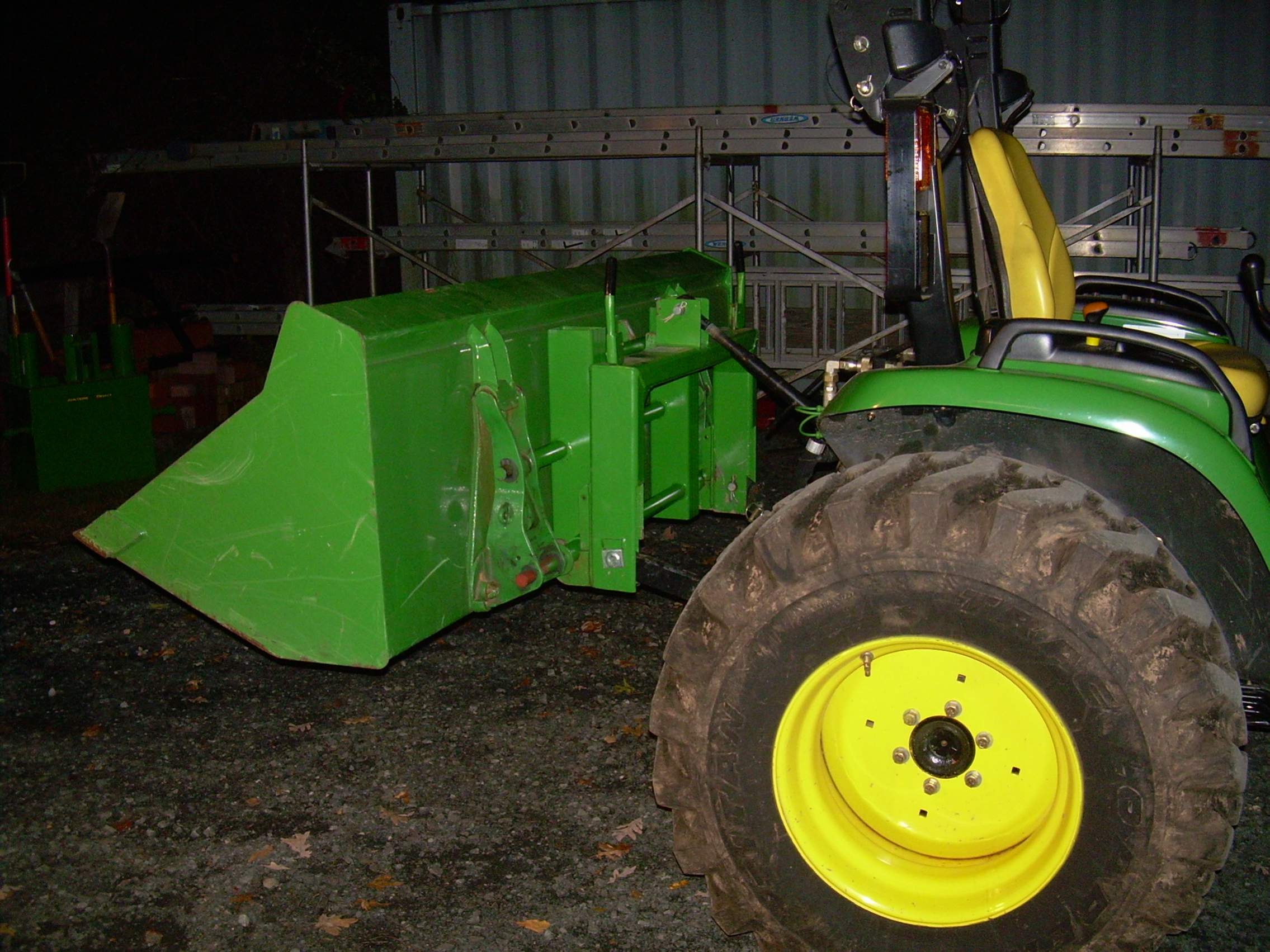

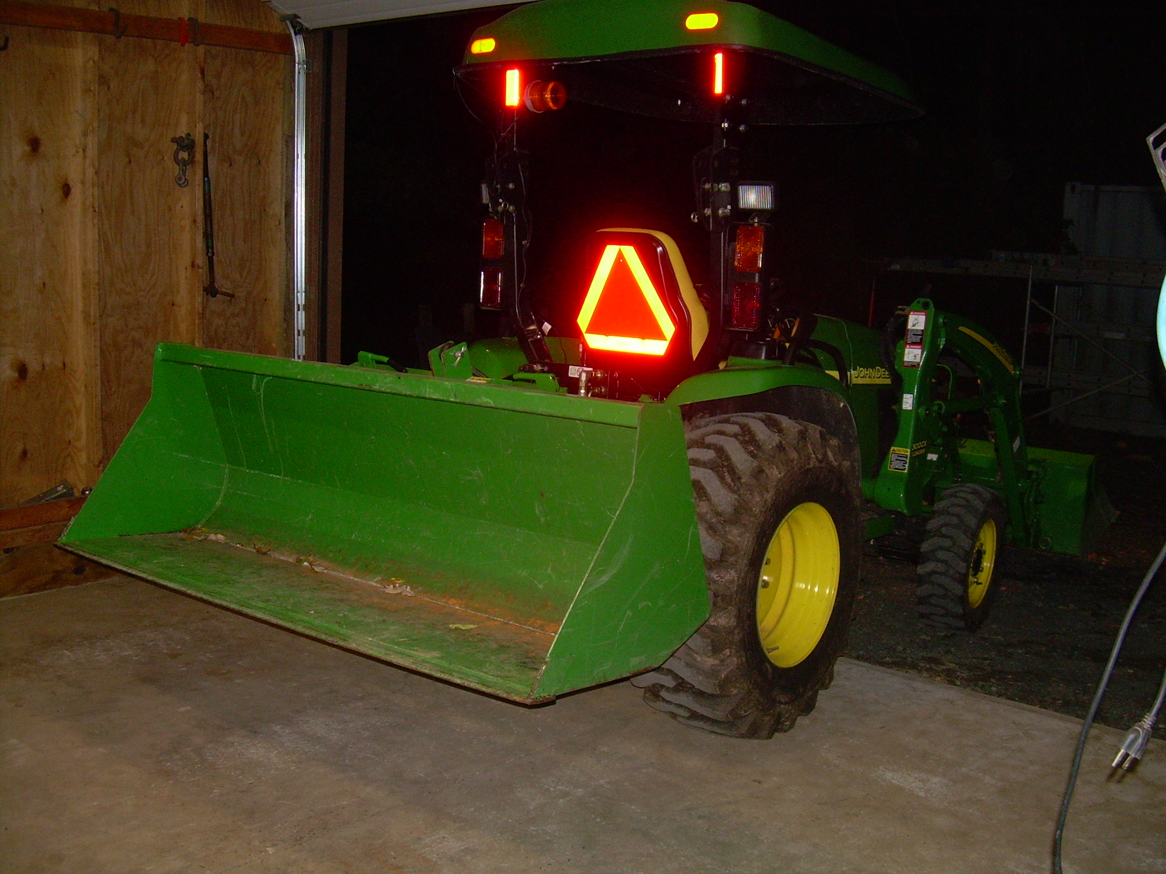

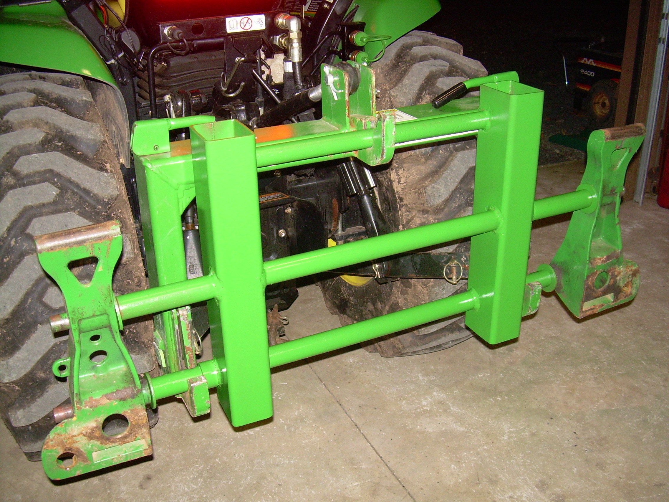

It may be just me that doesn't think it's a great idea, but then again I went and made this wackadoodle adaptor to put a FEL implement on the 3 pt. Well the bucket isn't very practical except for a large trunk space, guess it could come in handy for putting some tools and equipment in. Using 3 pt forks is very handy, but I already modded my forks to couple directly to the QH, so I really never used this contraption.
Didn't cost me anything cause I had the extra pair of JD carriers.

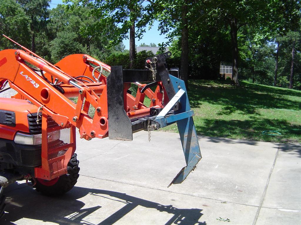

I have one of those 3pt QA for the FEL. I have used my box blade on it. Using the box blade that way is perfect for cleaning out ditches...
Here's a pic of mine...best I can remember I paid around $350 for mine...
   / Would a 3pt for my FEL quick attach be useful?? #9
Hmmm.. that subsoiler on your FEL has implications for plowing in cable up close to a building.
James K0UA
   / Would a 3pt for my FEL quick attach be useful?? #10
Not sure how you use that subsoiler that way but it reminds me of a friends subsoiler that I borrowed. He bent about a 1 inch piece of pipe and welded it to the subsoiler. It bent the other way from the tooth on the subsoiler.We just fed UF electrical cable through it as we travelled. Did a great job. We pulled it from the old fashioned rear 3 pt hitch though.
I do like your subsoiler though. Where can I get one like that?:thumbsup:
