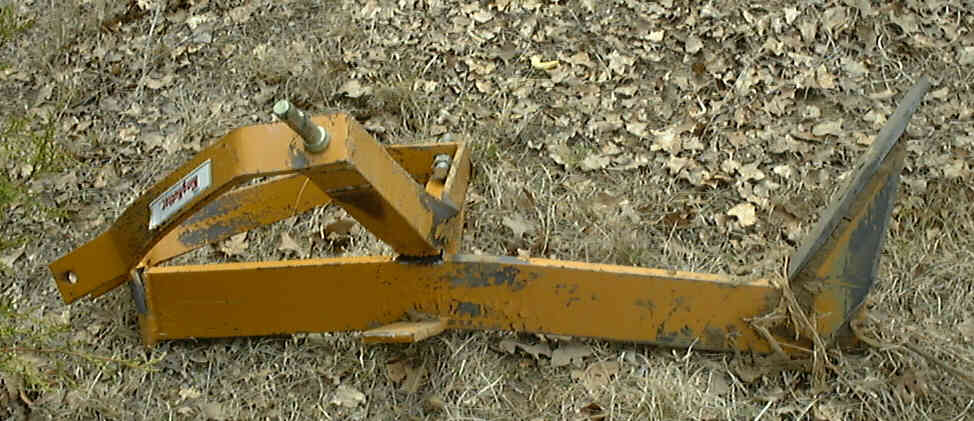

If I understand you right, you were talking about a subsoiler.
Quick advise - don't do it.
I made the mistake of using (or trying to) on mesquite. It is now scrap. (See the attached pic). A 4110 has the hp to absoultely mangle things like this. (Notice that steel is bent backwards and it's dimensions are ~5"x~2"!!)
Seriously, if you have roots stumps to get up, get a dozer. Much more efficient and easier on the equipment too. You can rent them for reasonable prices with or without an operator. (They're not hard to operate, but they are a lot of fun! /forums/images/graemlins/wink.gif )

Subsoiler, that is what I was talking about.
I have a 2615. I don't think it has the power to bend like that. But that also means it might not bust the roots.

It can take a surprising amount of effort to pull a subsoiler just thorugh the dirt if things are dry, so adding a root to the mix and you are likely to run out of HP long before the root has moved at all. If you are intent on trying it, make sure things are nice and wet down below as it will substantially reduce the effort and strain on the equipment. (This goes for dozers too).
