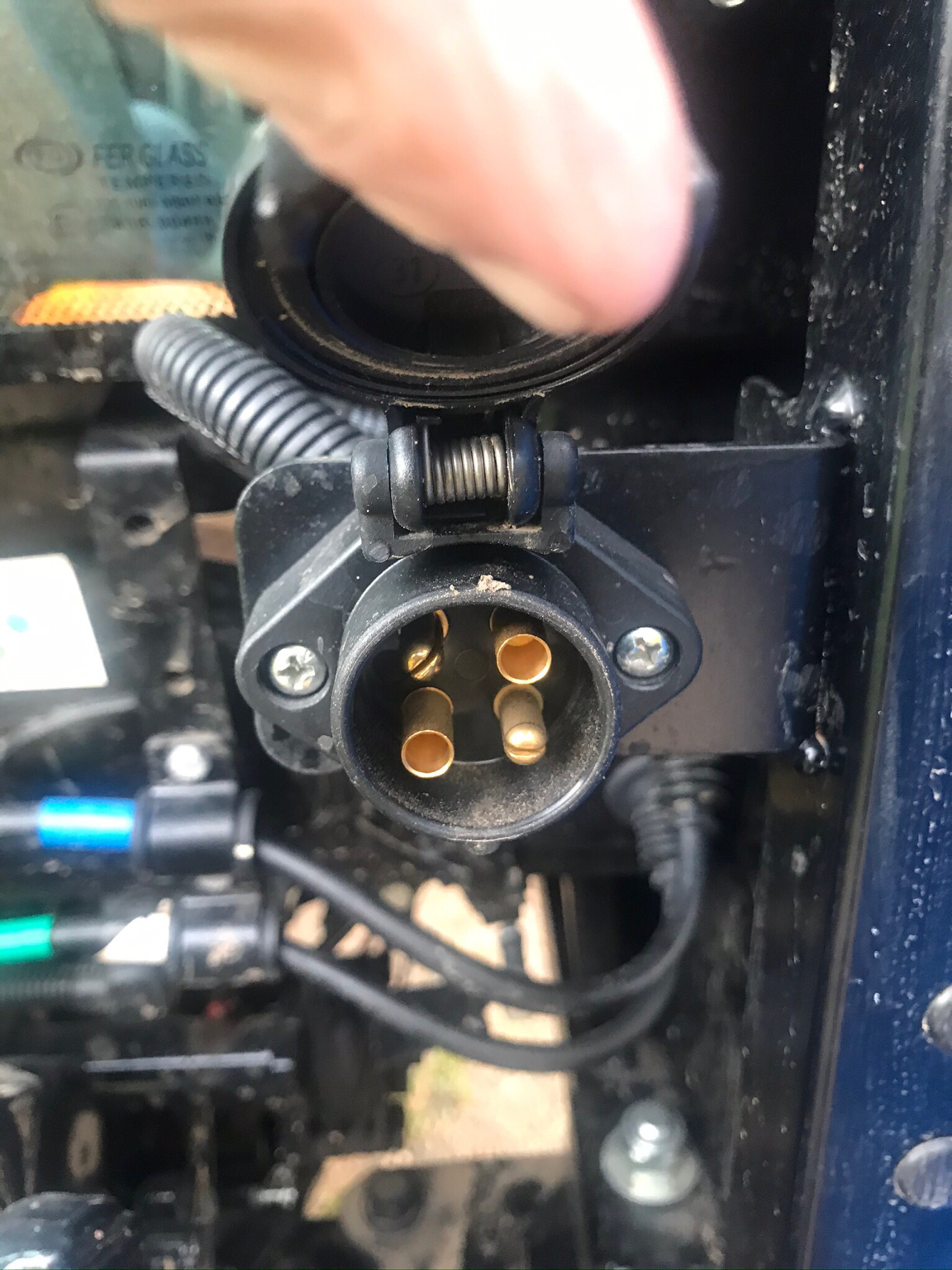

My Workmaster 75 has this power outlet just outside of the cab under the cab access grommet. It seems as if each pair (male & female) has 12 volt power continuously.
I would assume that this. Power could be used to run a electric sprayer, or electric positioned for a snow blower. But I can’t find any information in the manual, and the local auto parts guys had no idea about this type of outlet.
Does anyone know 1) what type of connector would be used to connect to this outlet. 2) what the amp rating would be on the circuit? 3). If this circuit is switchable from within the cab.
I intend to contact the dealer as well, but this group has need pretty informative, so I though I would ask here as well.
Thanks
   / Workmaster power outlet
#2
Here is what I found;
The NH part number for the 7 pin connector is 361428.
The NH part number for the 4 pin connector is 81864735.
The “wiring port” where the wires are fed through on the cab is NH part number 84290317. This is the flat “D” shaped rubber piece that is removed to feed the wires through. I need to give a big shout out to Chris over on his YouTube. Channel “CenTex”. He helped locate this part number.
