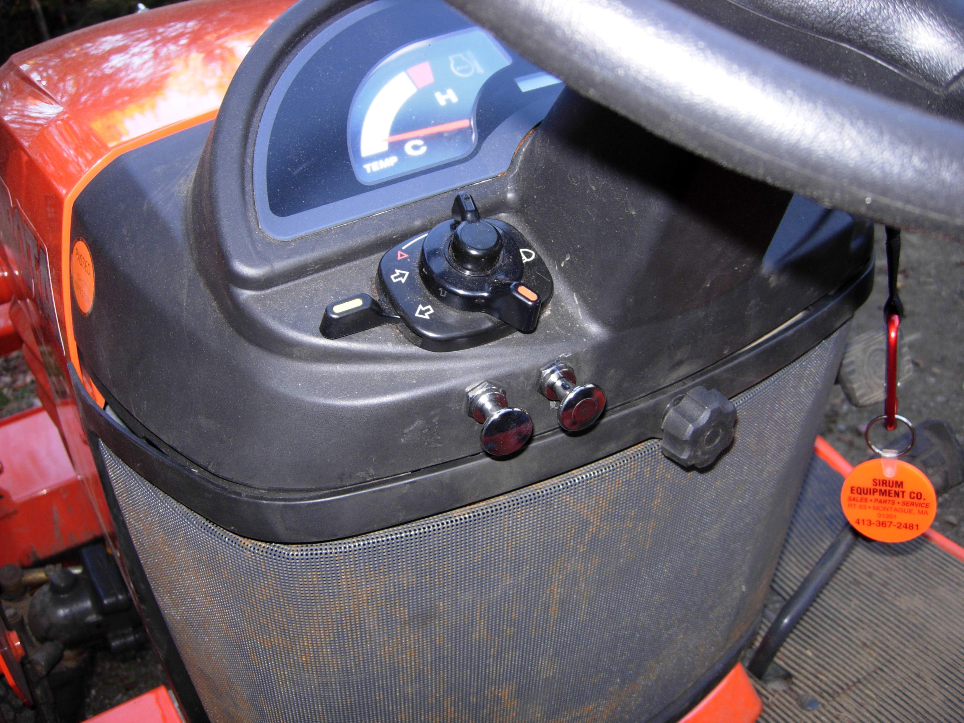

I just finished installing some front and rear work lights on the ROPS of my BX1850. Here are some pictures of the installation and links to the components I used.
The two switches, one for the front and one for the back were from West Marine. They are pretty heavy duty and are waterproof. They cost $20.99 each but should last a long time. They are made by COLE HERSEE Switch - 2 Pos, Sealed Push-Pull.
West Marine: Switch - 2 Pos, Sealed Push-Pull Product Display
I connected them to the wiring using something called Posi-Lock.
Posi-Lock(TM) - The Best Connectors You'll Ever Use!
They make a waterproof one that will allow easy connection and if needed an easy way to replace the switch if anything goes wrong with it. All other connections are soldered and covered with silicon filled heat shrink.

Looks good. I have been pondering doing something similar to my B2620. I was curious, do you run the regular tractor lights with these on? Do you run the front and rear lights on at the same time? Does your alternator handle the extra lights with all of them on? Did you connect directly to the battery or did you connect to the tractor fuse block?
