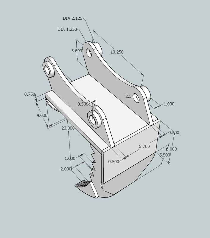

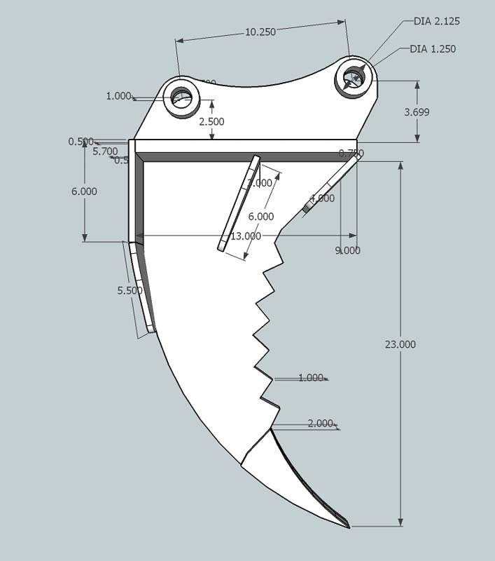

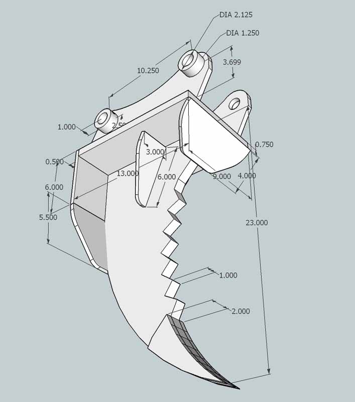

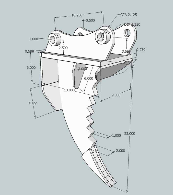

Hello All,
I am working on a government project at work. Ripper tooth for my new KB2485. Unfortunately I am 600+ miles away from my tractor. In hopes that one of you may have the info I am looking for.... I found this design in a search but I do not believe it was designed for the 2485. Can someone confirm or supply the bucket mounting dimensions?
Thanks!
Brian
