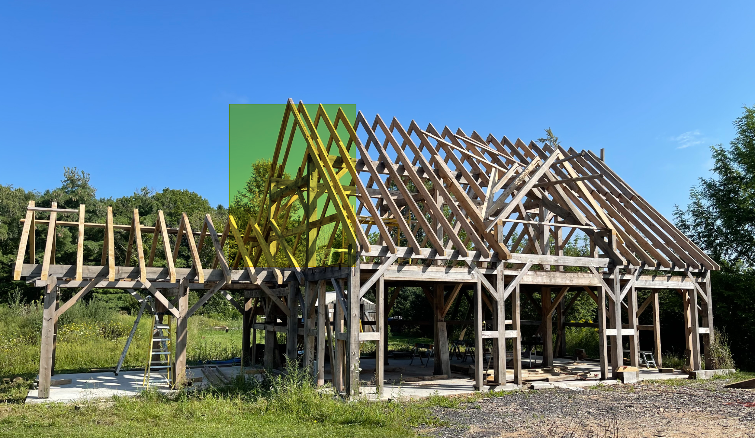

My wife and I have been slaving away at a barn for about a year and a half now. We did the entire timberframe ourselves, but elected to have a local contactor install the roof. It's a 12/12 pitch and frankly it just didn't seem like a job I wanted to take on. After we get the roof on, the next biggest task is the siding, which the plan is 10" board and batten, but I'm not sure the best plan of attack to install the siding on the highlighted side below safely, above the roofline of the attached pavilion. That lower roof is an 8/12 pitch. Is a lift my best bet here to handle this safely?

Scaffold should make it a safer job. If you installed the siding before the roofing contractor, it would be easier to attach some blocking to use walkboards to the timber framing. Going to have to flash the transitions anyway. So why do the roof first?
Other thought is have the roofing contractor install the same metal roofing as siding in that area. Shouldn't have the maintenance issues of wooden siding, either.

It's going to be a shingle roof, not metal. Because the entrances are under the eaves, we didn't want to deal with the snow slide. We're in upstate NY, so we can see some fairly heavy snow falls. It's not in this picture, but we've already put blocking on that final rafter that buts to the main building, in order for the roofers to run the flashing up under where the siding will eventually be.
Thought about snagging some scaffold, but the lower roof covers the part I'm most concerned with, which is the peak above that last tie beam. I could run some planks from the scaffold over the peak, but seems sketchy to then put a ladder on that :)

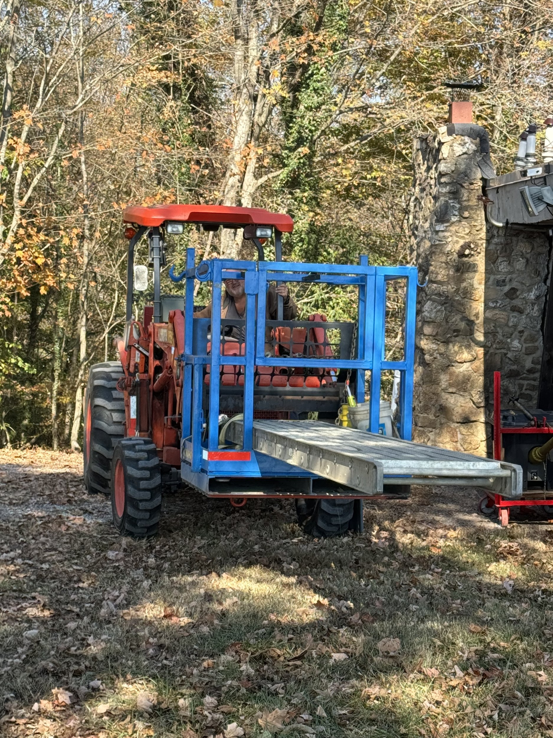

Sort of depends on the size of your wallet versus the value of your time.
A rental lift is there and done as soon as you can finish. But can cost several hundred/day and is very expensive to buy.

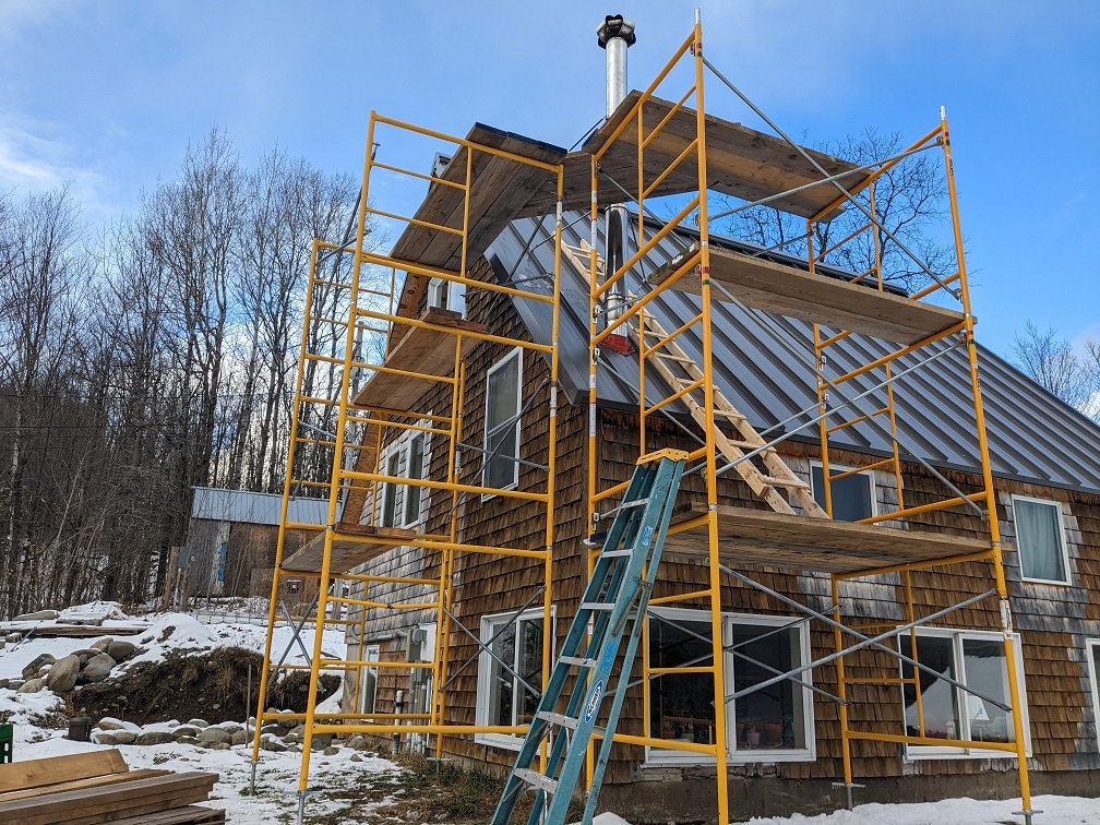

   / Working above the roof line #5
Wood planks and walk boards can skate out from under you unless they are screwed or otherwise secured to something to hold them firmly in place. Easier to attach them to the wood beams when there's no roofing on them and then remove them when you're done.
   / Working above the roof line #6
What we just used.

Yes put that siding on before the roof. You can srew to framing. You cant really screw things to a finished roof.
Also in NY and we did something similar but finished the siding before we built our porch at all. So we had a flat subfloor to work from.
