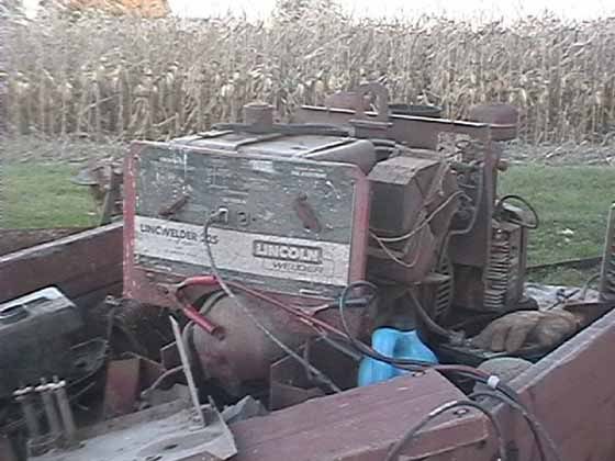

Long live the old Lincolns. Mine is from a dead guy in Idaho. Just cost me the fuel to go and get it which ain't chump change but much better than new. Not a lot of moving parts to go wrong. I only added a 25 foot or so power cord to the unit of much better quality than the original. I use my coleman generator for power when remote welding. I sure wish the actual working low voltage lines were easily replaceable as in the idealarc. The OEMs are very short.

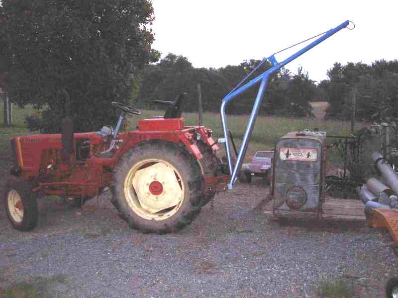

Here is an early pic of my old Lincoln SA200. It belonged to my dad who was a steamfitter. After he passed away I dragged home from WI to NC. It hadn't been run in more than 25 years and it wasn't welding the last time it ran. I cleaned up the magneto points, new spark plug & wires, rebuilt the carb, unstuck some valves, and got the Continental side-valve running. Then I cleaned the literal mouse nest out of the main commutator area, disassembeled and cleaned up the rusted solid brush mounts, and cleaned up the commutators. (main & exciter) Now it welds like a champ! I still need to get it lookin pretty but I did clean the rust up and sprayed on some grey primer. Sorry, no after pic yet.

Is this Belarus/Vladimirec on pic?
Interesting to see an old USSR tractor in USA /forums/images/graemlins/wink.gif
