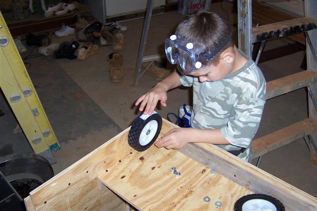

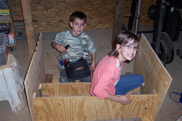

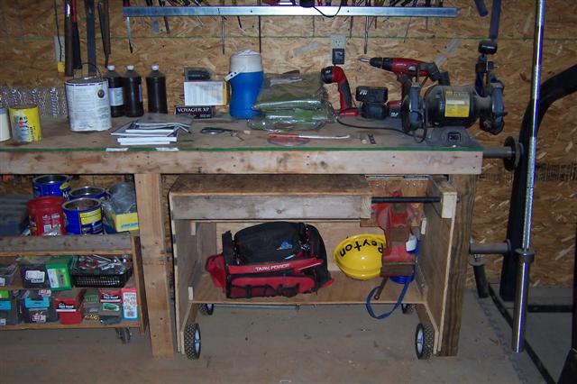

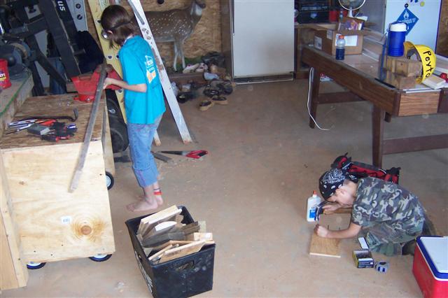

Steph and I thought it would be fun to give the kids there own set of tools and a place to use them. The tool part was easy, figureing out where to put a workbench took some creative thinking. :)
I figured I could move a few things around and give them the space under my workbench. I bought some wheels and started cutting scrap wood.
The kids were very exited about this and wanted to help out.

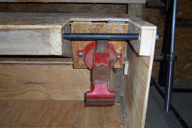

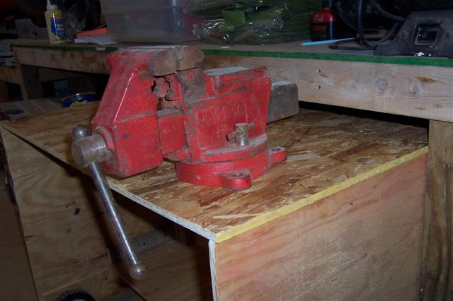

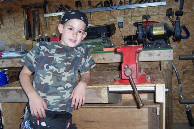

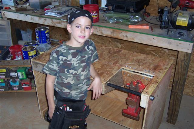

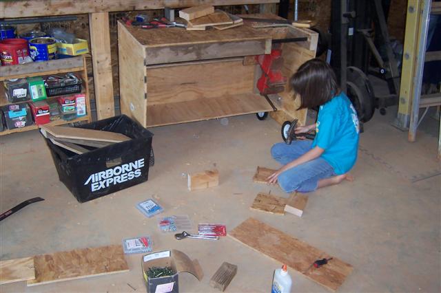

I had an extra vise laying around and wanted to put it on there bench. The bench had to be a certain height for it to be usable, which put the vise too tall to fit under my workbench.
I cut out a piece of the bench top and reinforced things. Than I put on some hinges and drilled a hole for a piece of half inch pipe to support the vice. Pull the pipe and the vice drops down. Lift the vice and slide the pipe under it, and you have a solid work station.

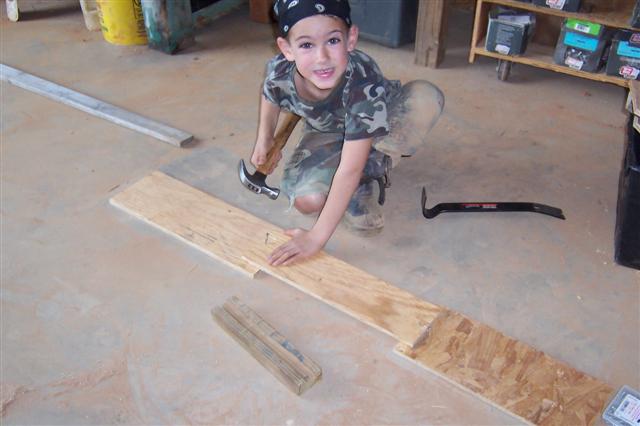

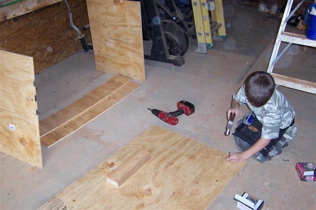

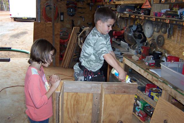

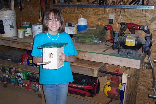

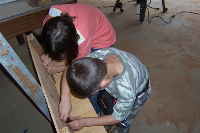

Now that they have a place to build things, they got right to it!!!
Eddie
