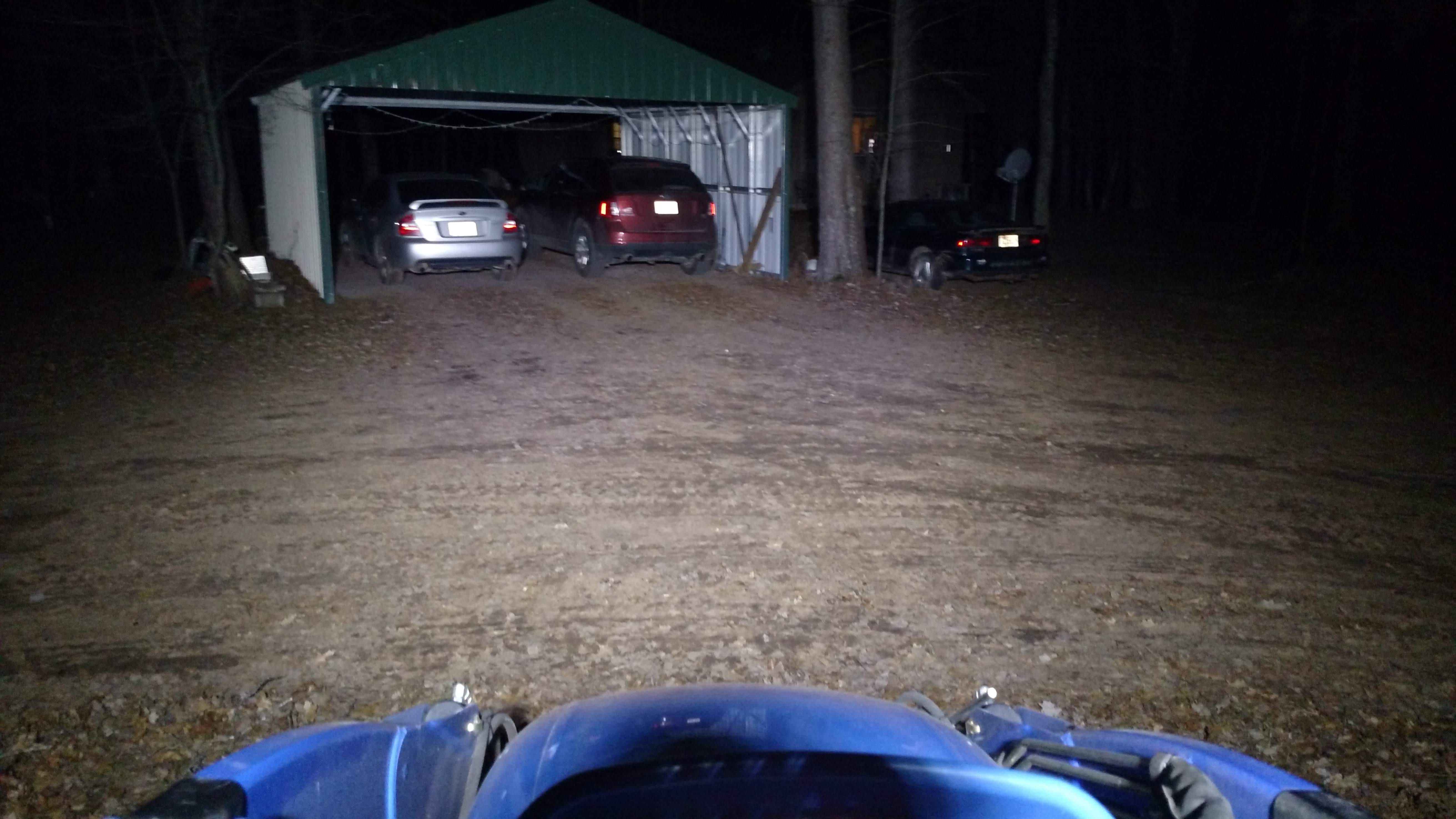

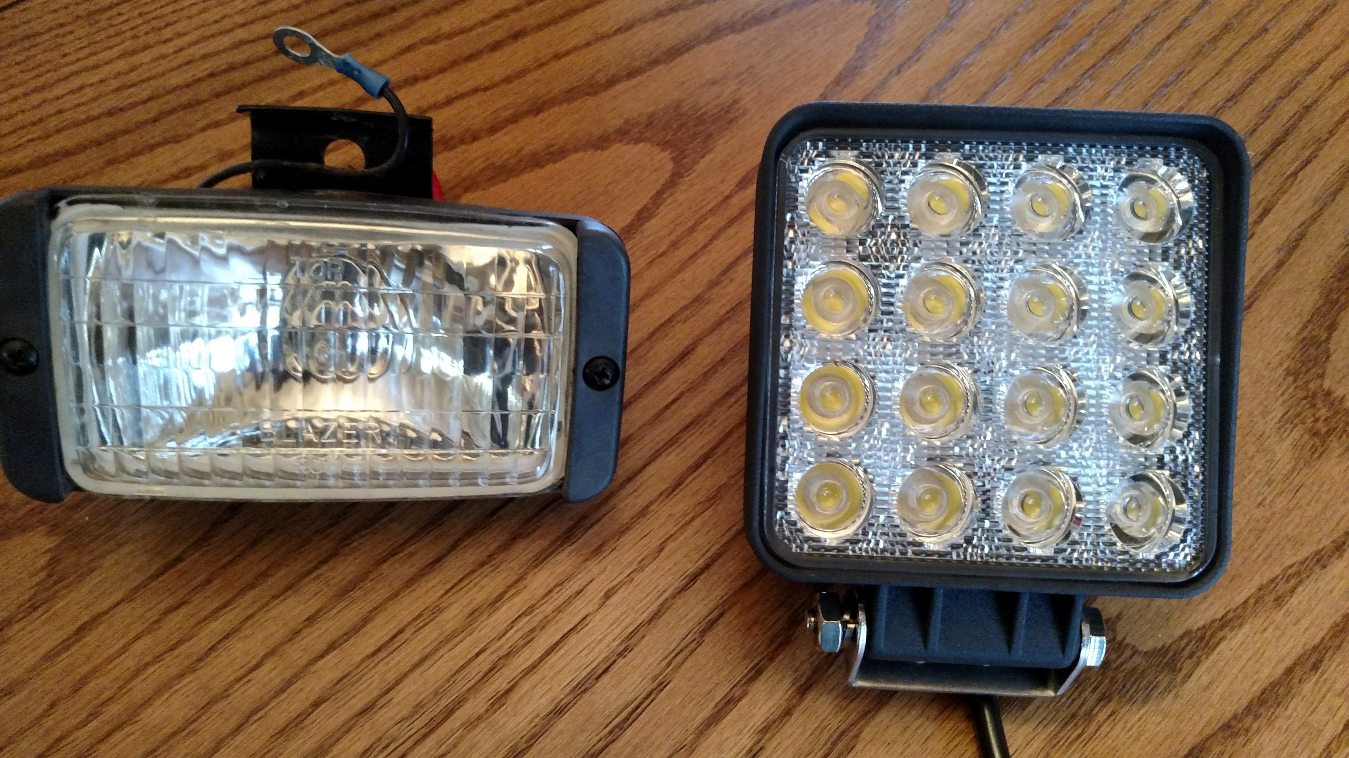

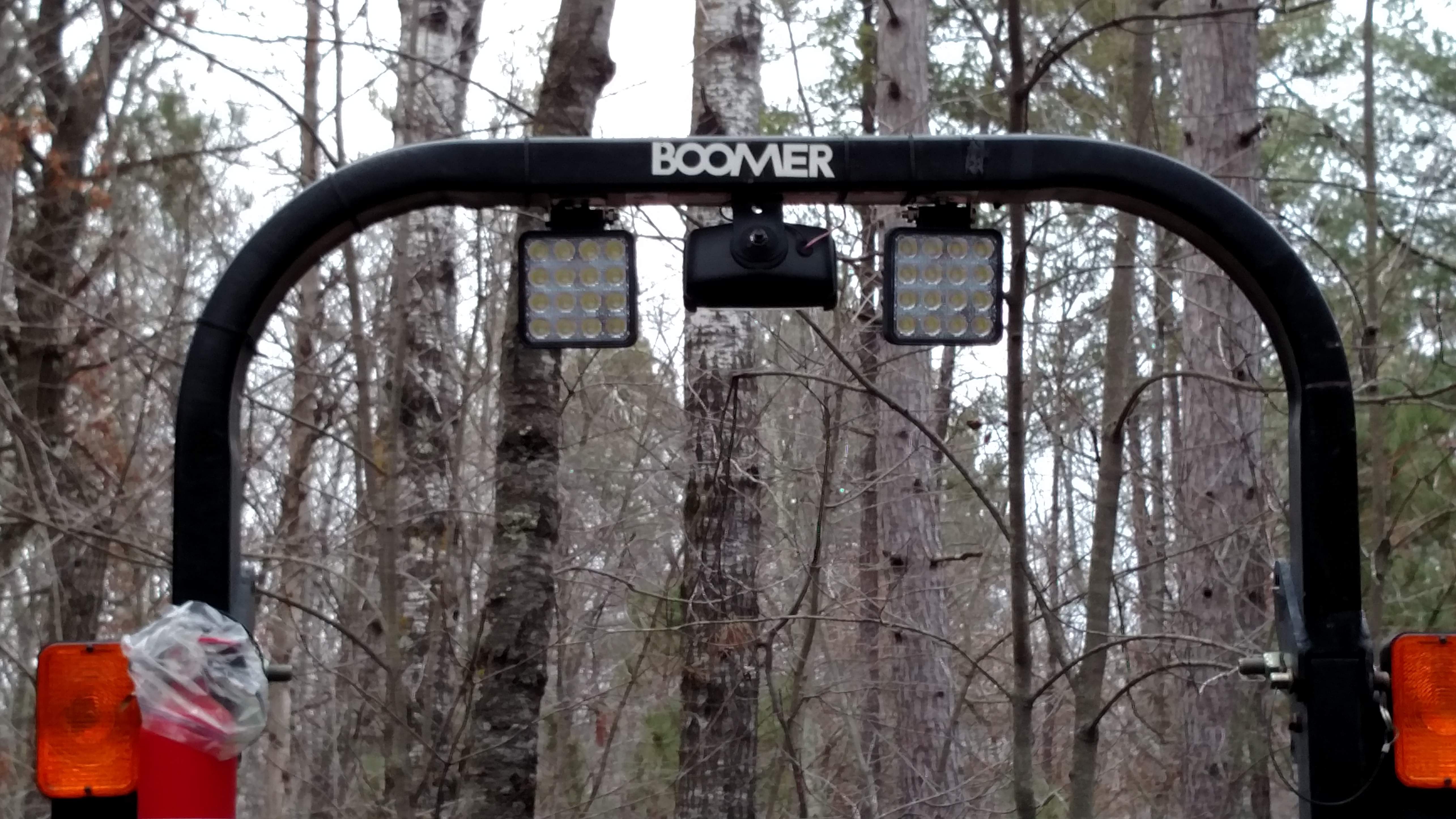

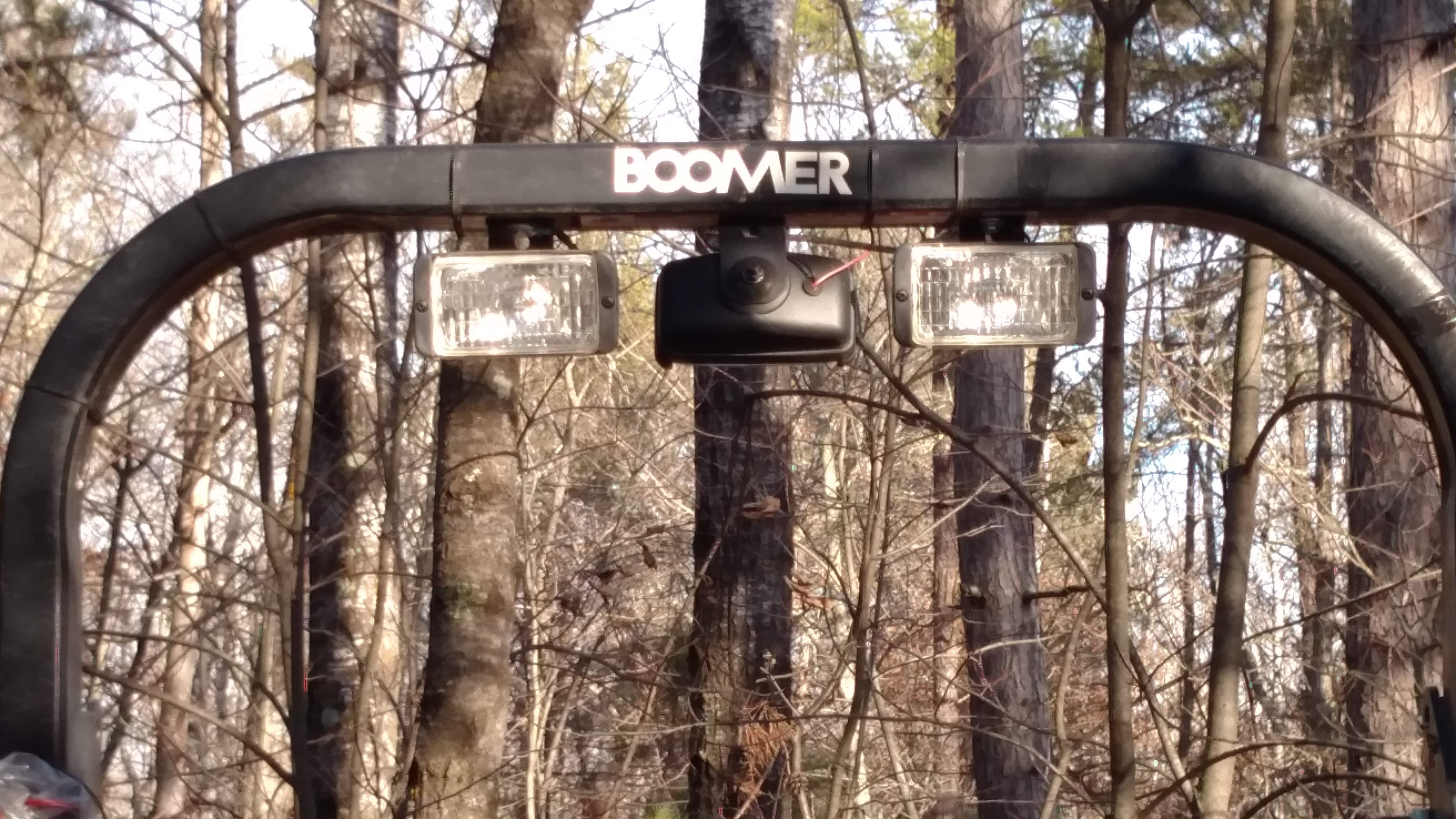

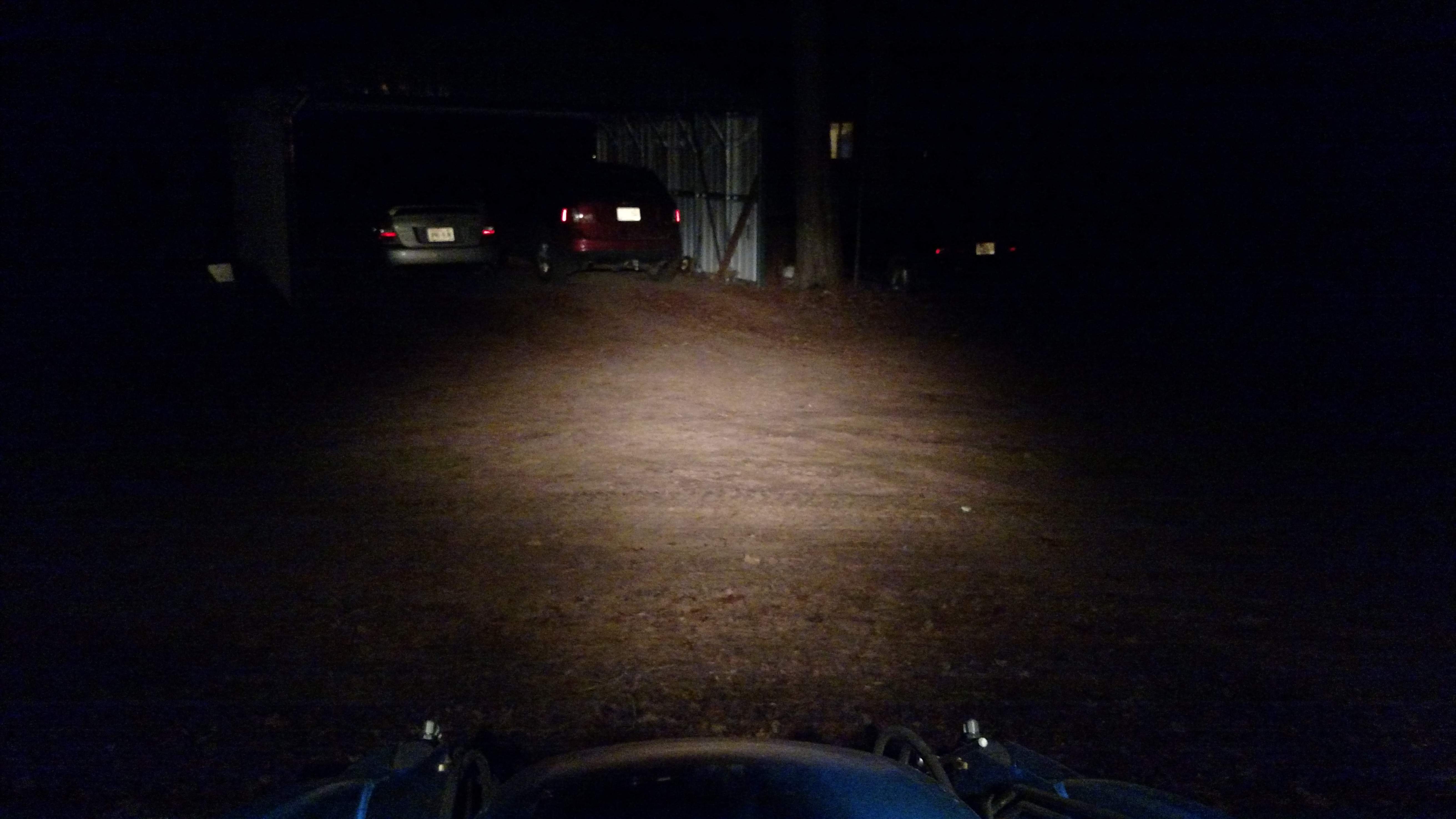

I originally mounted 2 front facing and one 55w halogen work lights on the ROPS. I replaced them with 45w LEDs for under $15 each. Excellent lighting. There should be a work light plug/power source in the rear area somewhere. You may have to wire in a simple switch.
