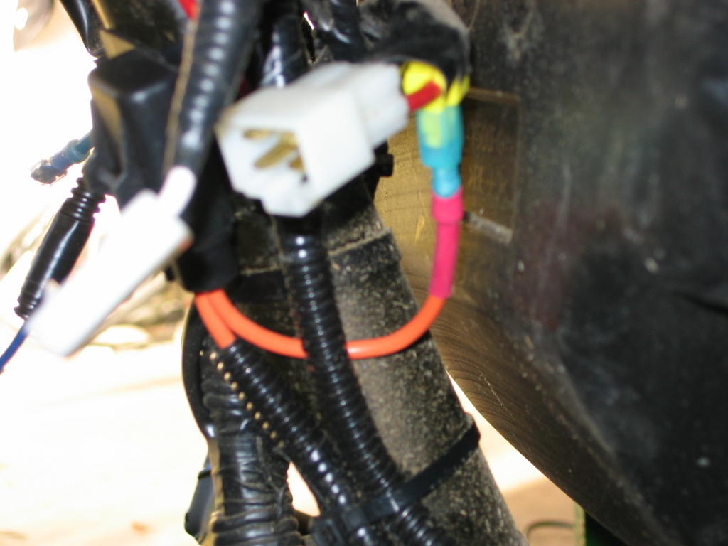

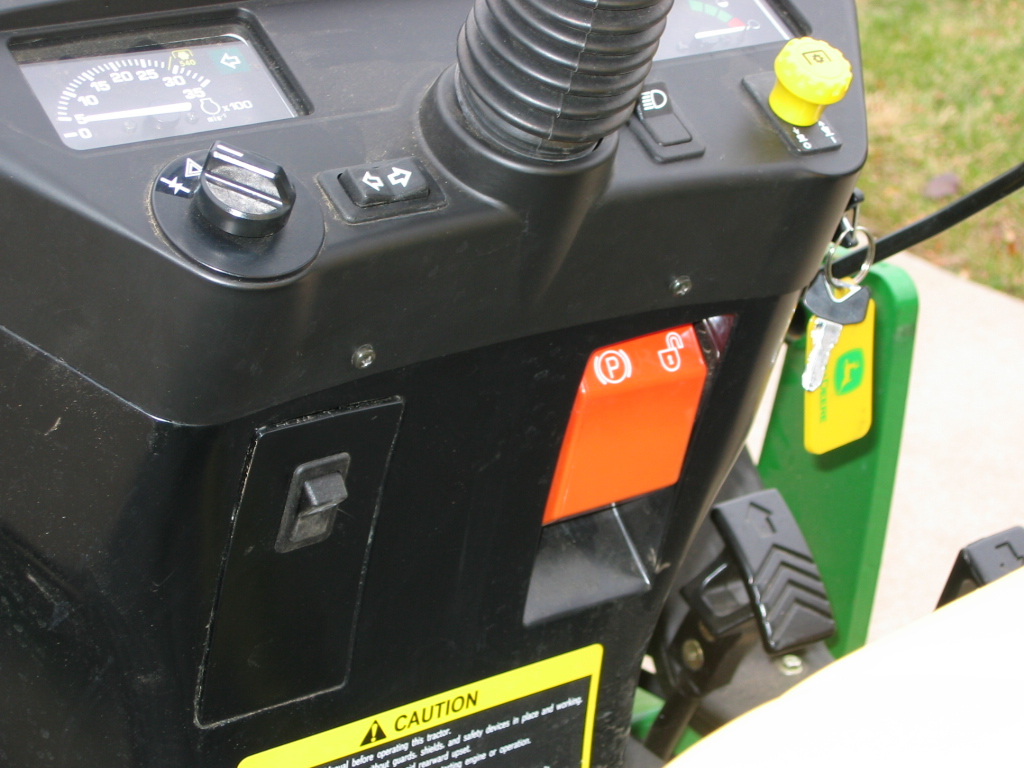

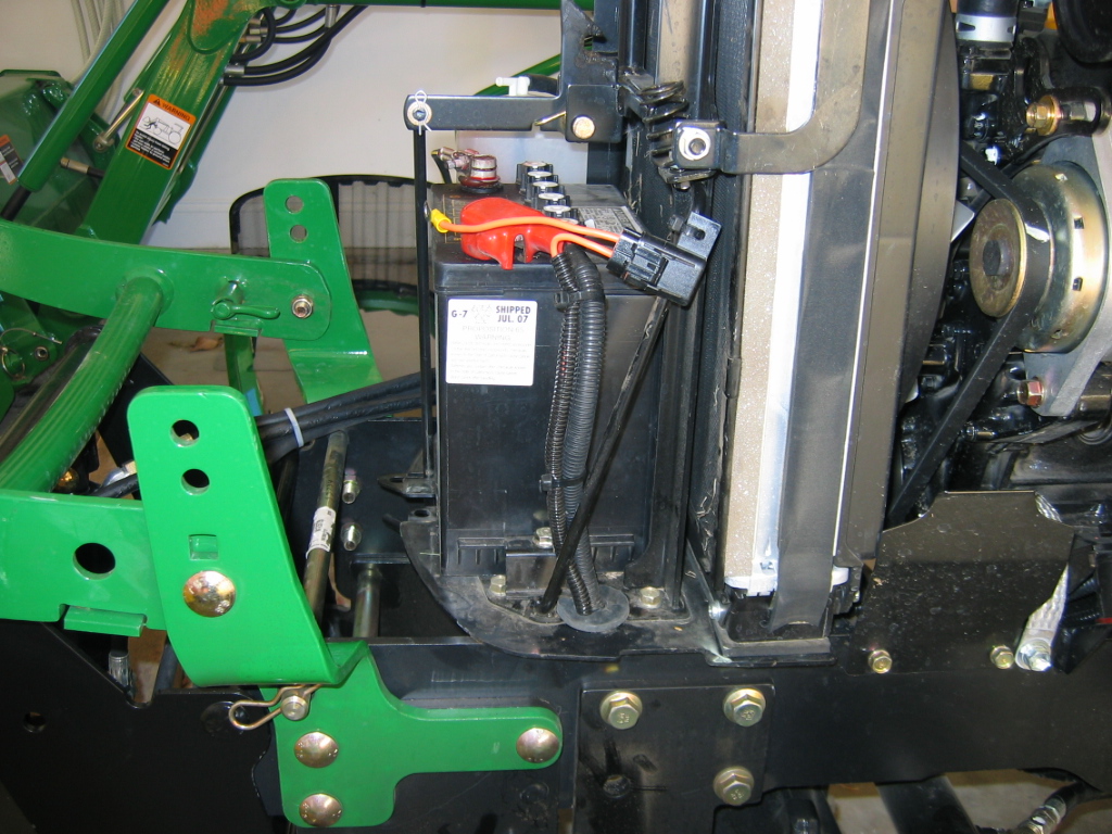

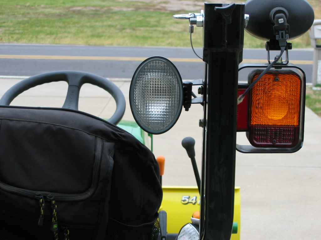

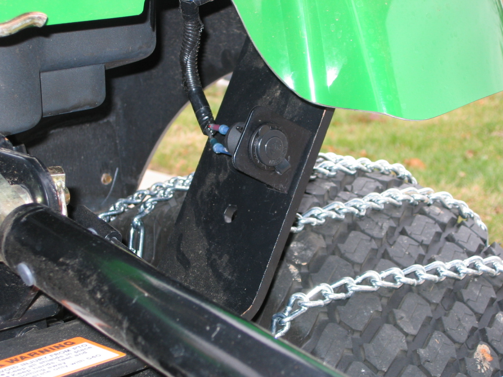

I finally got all the parts together and installed a rear work light and 12v switched power outlet on my 2305. I borrowed alot of ideas from you guys! I used the cutout that is meant for the cruise control sw for the sw that controls the 12v outlet. I installed a second sw in the blank left of the parking brake for the rear work light. Both circuits are fused and operate thru relays. The relay circuit draws it's power from the #1 wire at the key sw and is only hot when the key is on. It goes from the #1 wire, thru a fuse, thru the sw's and to the relay coils. The power to the light and 12v outlet come directly from the battery, thru a fuse, thru the relays, and out to the loads. May seem like overkill, but I think it's a good design. Sw's are John Deere as is the rear work light. The 12v outlet is a marine outlet I've seen used by a number of people on here. The relays are standard automotive relays. Almost all connector are heat shrink type or sealed with heat shrink tubing. It was dark when I finished and the rear light already came in handy backing into the shed.

Are the lights mounted on the ROPS ever annoying since they are kind of behind your head? I was planning on installing lights out toward the front of my canopy because I though I might end up staring into a bright light when turning my head. The only thing I know for sure about the headlights is they are bright, but that bucket is almost always in the path of the light. It would also be very helpful to see behind me. This time of year around here it is dark enough to need lighting from 1500 until 0800. I usually only have the time to play after 1700.
   / work light and 12v outlet done!
If you don't have a height issue, then absolutely the lights would be better near the top of the ROPS, or if you have a canopy, near the front of it. That will most likely be one of my next little projects, designing an adjustable mount for the lights so I can telescope them , or a shield of some sort. As it is, you have to be careful not to turn your head and look right into them. Definately blinding! I've seen where a couple of other guys have done it using various methods. Gets dark pretty early here too. Luckily I'm retired now and can work in the daytime if I need, although I typically like to do snow removal at night. Guess thats what happens when you work 3rd shift half your life!

Nice work. I got tired of my rear lights poking me in the kidneys, so I moved them up higher as shown in my photo gallery accessible via my signature.
