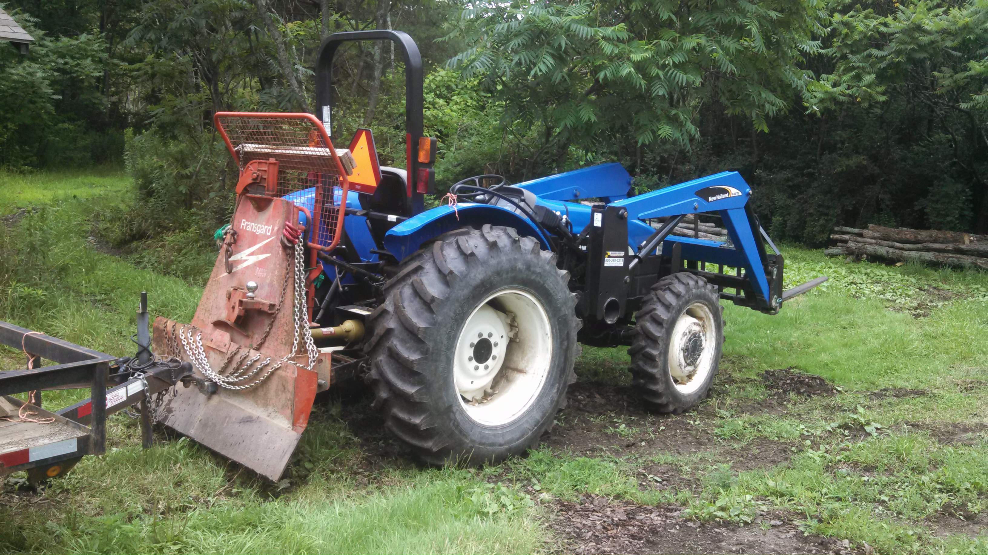

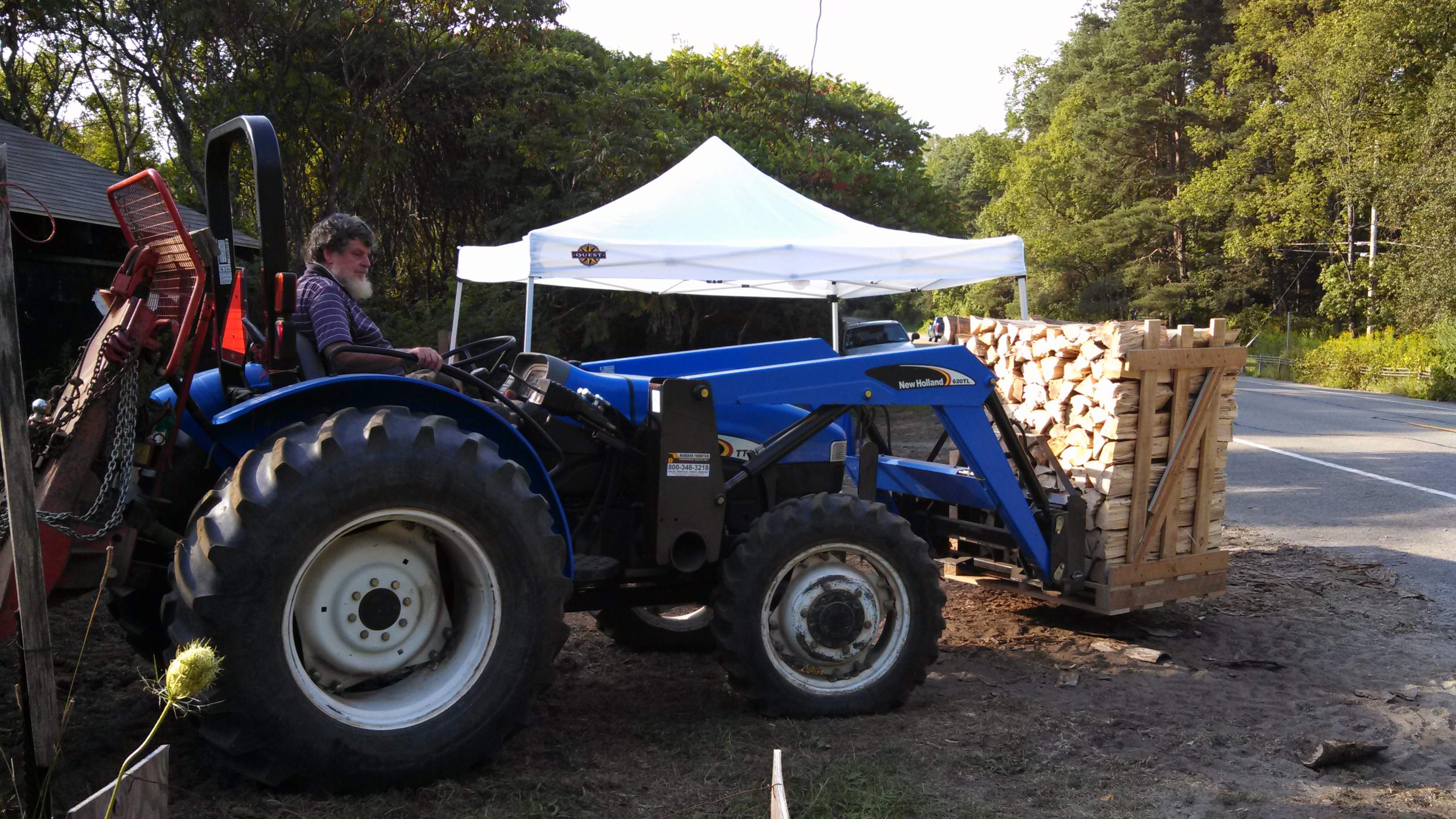

I recently purchased a 2007 New Holland TT60A 4x4 with approx. 400 hrs. on it for $16500 with NH quick attach loader. I also found a used Fransgard v-4000 winch to hang off the 3 pt. hitch. One of the reasons I liked this machine was- it will easily pick up 2000 lbs. on the loader- I palletize my firewood in 1/2 or 1 cord increments and 1 face cord of wet wood is in the 1 ton range. Also the front tires are quite tall for clearance. A lot of the 50 HP machines have smaller front tires.
It's a great size machine that will do whatever I need it to do, the only drawback so far is I miss having a f-w shuttle shift.

I think I did pretty well on it. I shopped around for quite a while and I was looking at all brands with local dealers, both private sale and dealers. This one was a private sale, I talked the guy down a little. He was looking to buy a compact tractor with a cab.
It is a bare bones utility tractor, though. That model is no longer made but to get into a similar new unit is at least $25,000 and most of the ones I checked out were on a smaller size frame and didn't have the loader capacity or taller front tires I mentioned.
Heres a couple pics, if they show up....
