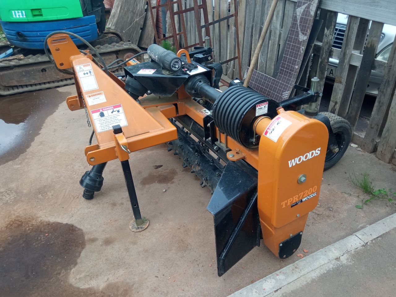

Hello everyone. I use a translator, so I can write with mistakes. I'm new to the forum and would like to ask you for help. I purchased a new Woods TPR 7200. Unfortunately, it was delivered without a user manual. I couldn't find it on the manufacturer's website. Is there a way to find it on the Internet? My second problem is setting the floating stroke on the TPR. Each time the floating mode is activated, the rake begins to dig into the ground. What could be the reason? I really hope for your advice.

I am guessing that you may have your depth setting too low when you go to float. I don't see a manual on the Woods TPR7200, but have a link to a Harley power rake. This is basically the same and may answer your questions.

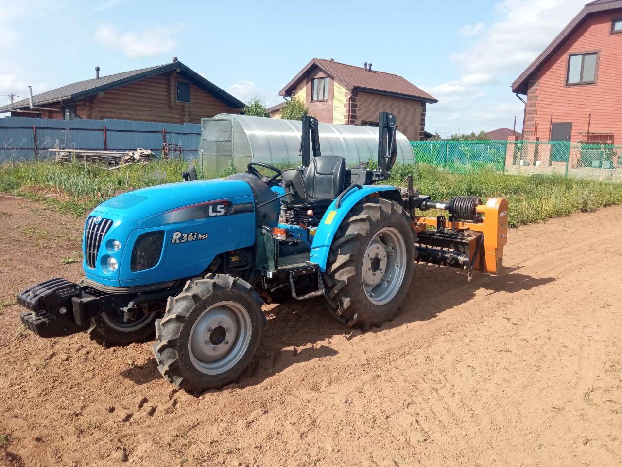

Thank you very much. This is really important information that I have been searching for a long time. I'm surprised that even the model is completely identical in design. There's one more thing left to do, and that's to learn how to work for them))) The rakes I bought are the only ones in our region, so I'm hoping for them.
