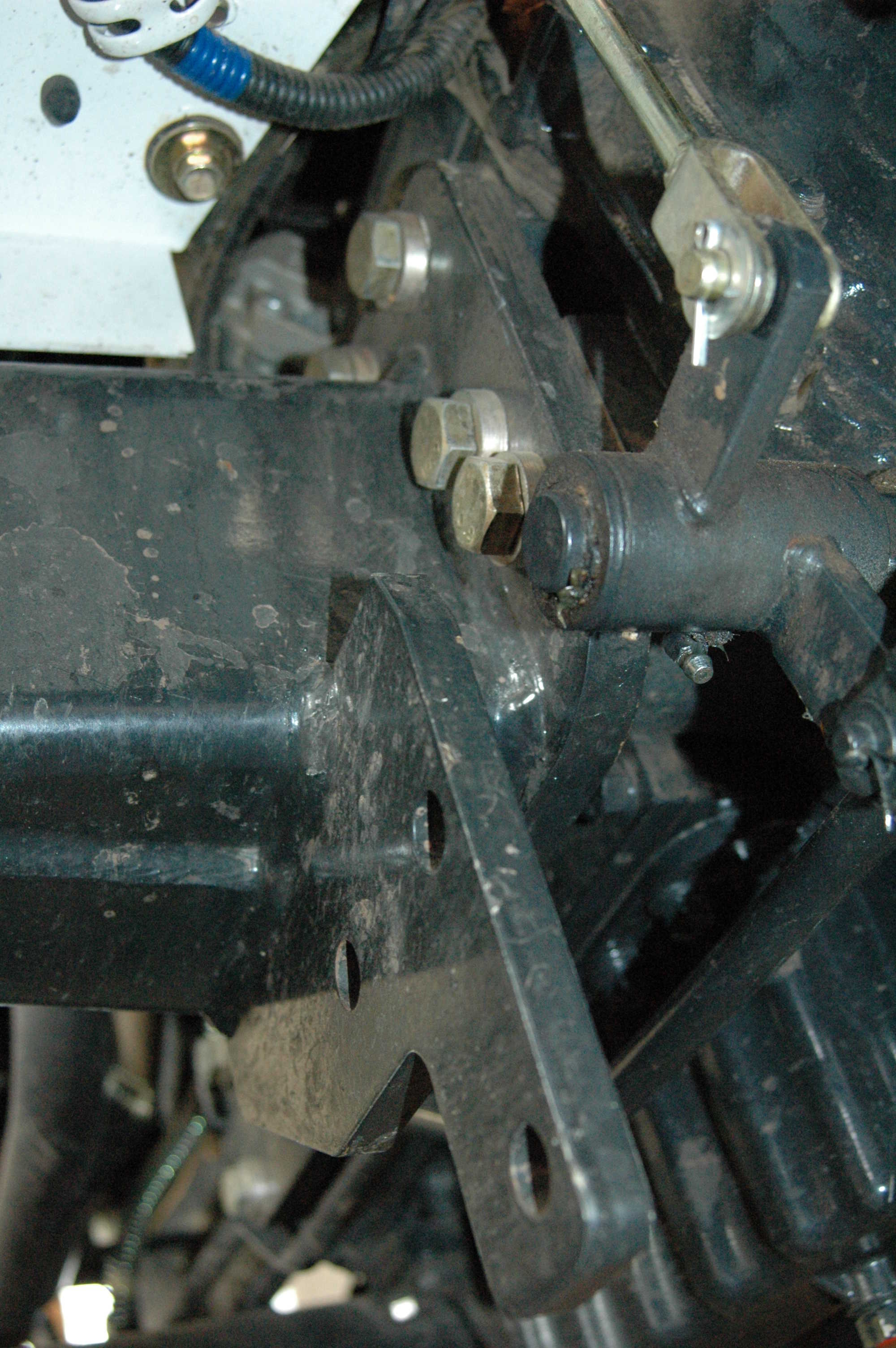

I'm needing a backhoe for my CT230, and have settled on the Woods BH75, mostly because of the smaller "parking footprint" for the detached hoe. Woods does not offer a subframe for the CT230, but does have one for the near-equivalent CK30. The problem seems to be that the subframe connects near the FEL mounts, and the FEL's are different between the Bobcat and the Kioti. I'm told that the matchup is close, but some additional fabricaton/modification is required.
Has anyone here done the matchup of a CT225, 230, or 235 to the Woods Subframe for the Kiotis?
Could you tell me how it was done?
How difficult is the modification required?
Any photos of how the front attachment was done?
Any advice here would be very welcome. Thanks in advance.

The rear mounts of sub-frame will be the same as CK30. The question will be how the front mounts are installed/located. If mounted to the transmission case, flywheel housing, or engine then it would be same as Kioti. If mount brackets are fastened to loader frame the modification or new brackets would be required. Ask Woods dealer to get a copy of the installation instructions from Woods and see how the front mounts are installed.

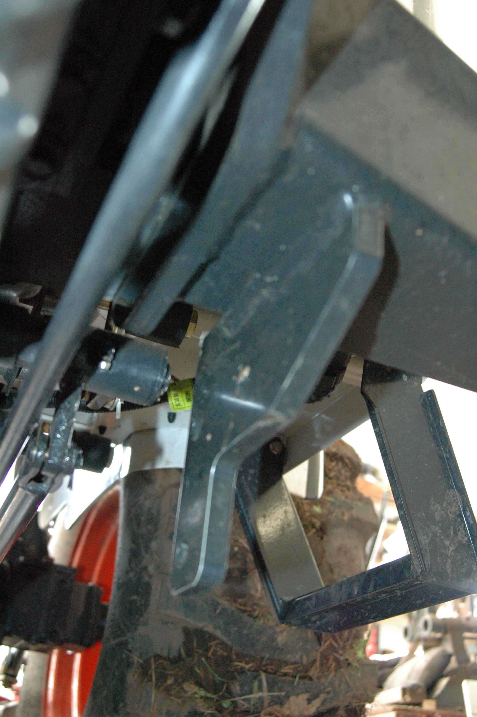

I have the Woods subframe installation instructions, and it very clearly shows how the rear connections bolt in. The front is not shown nearly as well, however.
At my FEL mount, there are three-hole tabs that appear to be for something like the front connections of a subframe. Does anybody have a decent photo of the ck30 FEL mounts for comparison?

I'll attempt to upload a couple of photos here... it's the left front mount for the FEL, with the subframe mounting tab that would be used for the backhoe subframe. Is this different from the Kioti with it's FEL?

I just recently installed a woods 80x on my CK30...I can take some pictures if any of that would help you
