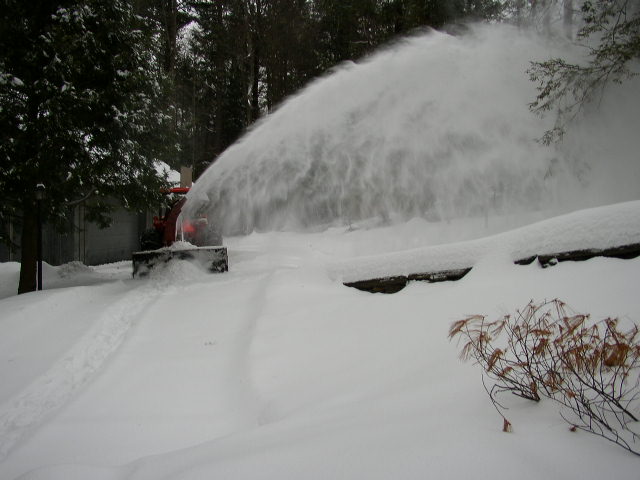

The question I have is there anybody out there, that has the same blower. Do you think the impeller is big enough to handle the volume of 6' of snow that is being pushed thru it ? To me I think it should be deeper or wider. If you feed it to much snow it will just start plowing it instead. Now don't get me wrong, I'm not piling it in so that it wouldn't be a reasonable amount. I think it should be able to handle more volume. I also think the impeller size is the same as the smaller woods out there. Maybe I'm wrong but if this is true, shouldn't the impeller size get bigger with the size of the blower?

Hello Bruce - you are on the right track -blower output is a combination of fan diameter, depth, and speed. One machine's fan may be smaller but may run faster than another machine's. You might check to see if there is any step-up of the fan on your machine.
I've noticed my 84" New Idea blower will plow up a wave if the tractor is moving too fast. It has a 24" fan, 8" deep, running at pto speed (not stepped up).

In addition to the depth and diameter of the impeller is the "tip" speed of the impeller fan. I'm not a math wizard but one could figure out how much faster the shaft speed has to be to get the same impeller tip speed on different diameter impellers.
My Pronovost P-740 (74") blower has a impeller diameter of 26" and 12" depth. The tractor that running the blower, L4330HST, is at the lower end of recommended PTO hp. If I run my ground speed is to fast for the conditions, I can bog down the tractor to stall if I want.
In my searching for snow blowers I remember a few dealers telling me that a larger impeller spinning at speed is more overall efficient in moving snow than a smaller drum spinning faster. I'm not sure if that is true.
One thing I have noticed is that snow blowers with a smaller impeller seem to shot more of a mist or cloud of snow. The larger impellers seem to stream the snow more less misting.
