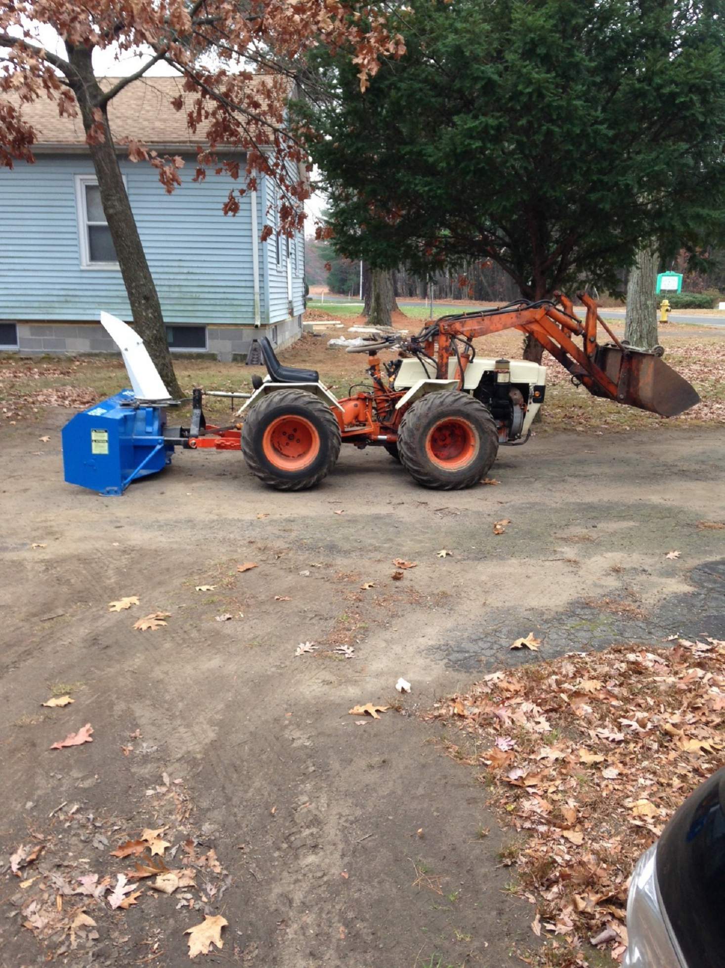

My snowblower is a 60" that I use to do several un-even & heaved asphalt driveways & a hard-packed driveway out to a horse/goat pen. As some of the other's said, you need a minimum of 4" to keep blower happy. When I run into area's that are less than required 4", I dis-engage PTO & use it like a box-blade, build up snow in the box, then engage blower to clear it.
