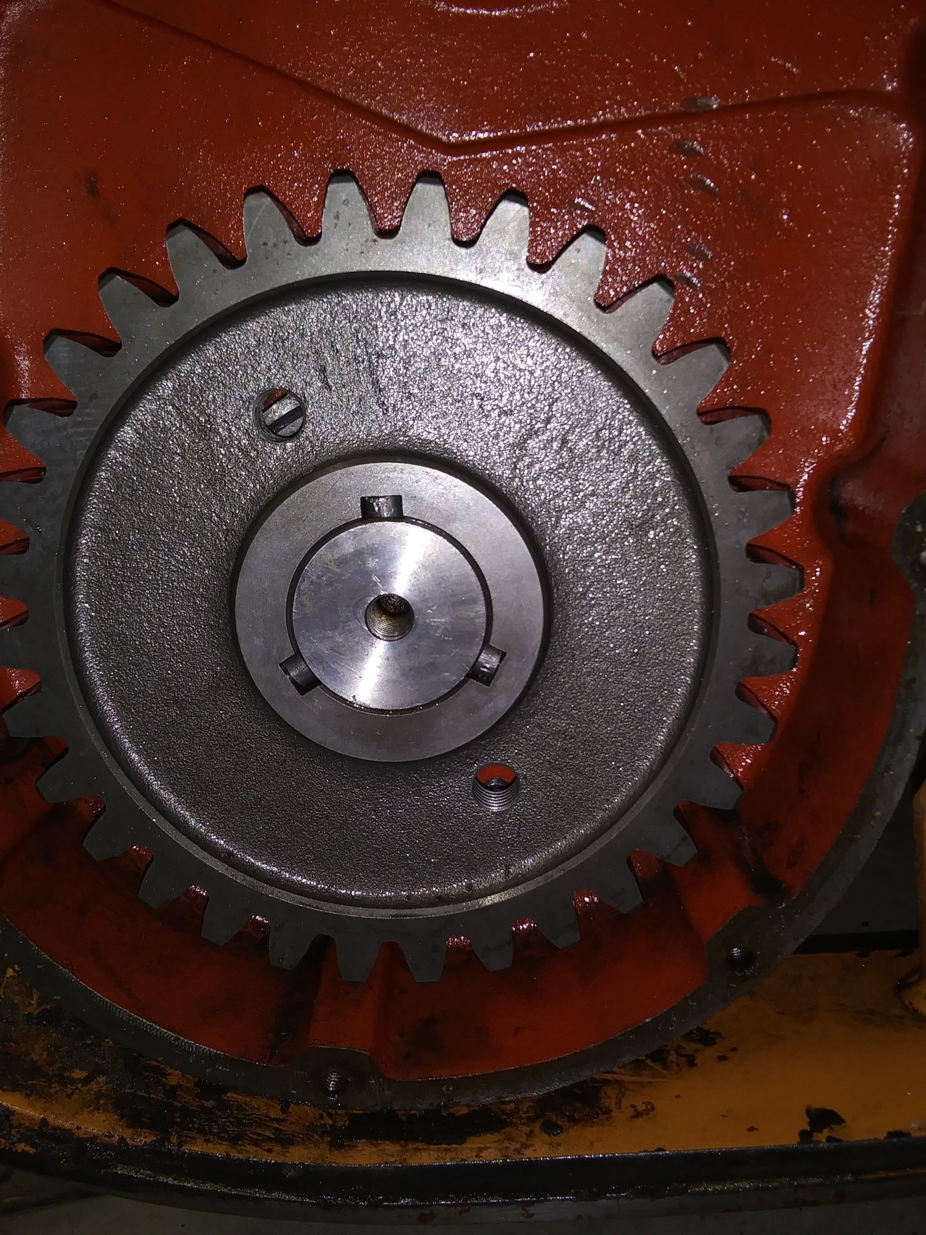

I have a Woods SGT60 rototiller made in Italy in 1998. It started to leak oil from the seals near the gear case. There are three gears for the drive unit. I was able to remove the center gear by driving bolts (14mm) thru the threaded holes in the gear. The bolts pushed against the gear case forcing the gear toward the end of the short shaft, which is part of the gear case, and off. The center gear has a bearing which actually fits on the shaft.
The top and bottom gears are trouble. The top is attached to the drive shaft; the bottom to the tiller tines shaft. Both have drive threads as the center gear, but if I drive bolts through them, I would be driving the bolts right into the bearings for shafts. I put steel plates behind the gear in an effort to protect the bearings, but they do not budge when I drive the bolts through. The top and bottom gears have three keys on each shaft. Any thoughts on how to get these gears off without destroying anything? Is there something special about these Italian made units?
I could only find a part diagram for this tiller; not a service manual.
The gears have to come off in order to get the gear case off and get to the rest of the parts on the shaft.
My next step might be to heat the gear, but not looking forward to that.
Any thoughts would be appreciated.

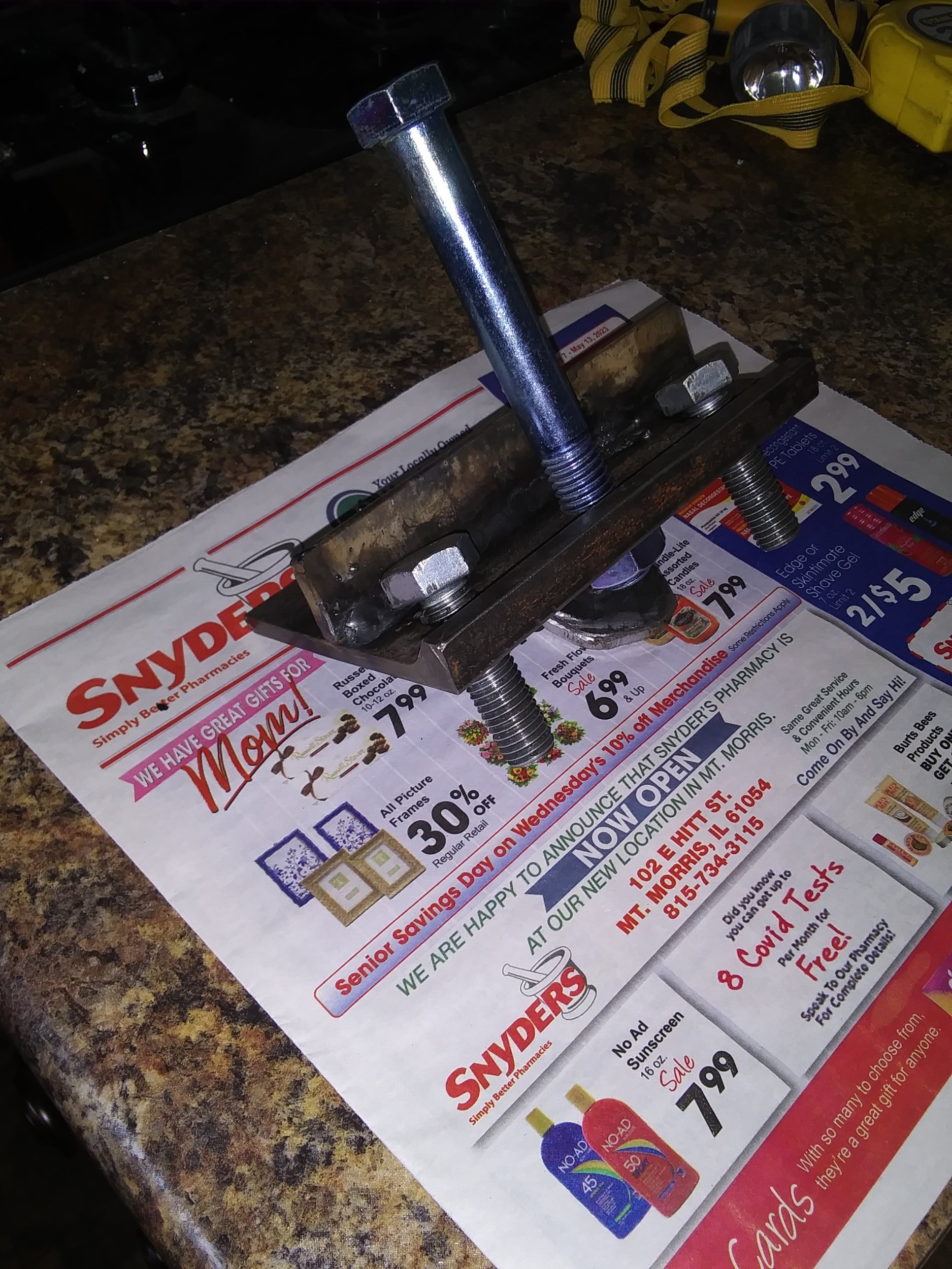

I made a new puller today and expect to try it tomorrow. Does anybody see a reason why these gears should not pull off? There was a bolt with large washer threaded into the ends of each shaft. This prevented the gear from working it's way off the shaft. There are no set screws.
The new puller is for the bottom gear. The two outside bolts will thread into the gear. The drive bolt will press again the shaft. I have a small spacer to protect the internal thread on the shaft. As the bolt is turned it will drive the nut against the frame of the puller thus forcing the two outside bolts to pull the gear off the shaft. I hope it has enough strength to not bend.
If this works I'll make a version for the top gear.

I see no such reason. It looks to me like they should come off easily enough. Other than the fact they've been on there a long time. Things like that tend to bond over the years, even though the housing is lubricated. Having three keys adds to it, as the keys tend to fit tighter in the keyways than the gear does on the shaft. It certainly looks like the bolt puller idea was what the engineers were shooting for.
If you make your tool strong enough, the weakest link will be the two bolts.
   / Woods SGT60 Rototiller Repair Project #9
What surprises me is the fact the keyways are not continuous through the drive shafts. It could be they are notched into the drive shafts and when you pull the gear, it is wedging the keys between the two. Put some pull on the gear, then with a punch, tap the keys in to prevent the binding. Good luck.
   / Woods SGT60 Rototiller Repair Project #10
Could you use a piece of all thread in the center shaft. Then bolt a strap across the gear with a hole in the center for the all thread. Have a nut below the strap and drive it off and away from the bearings.
