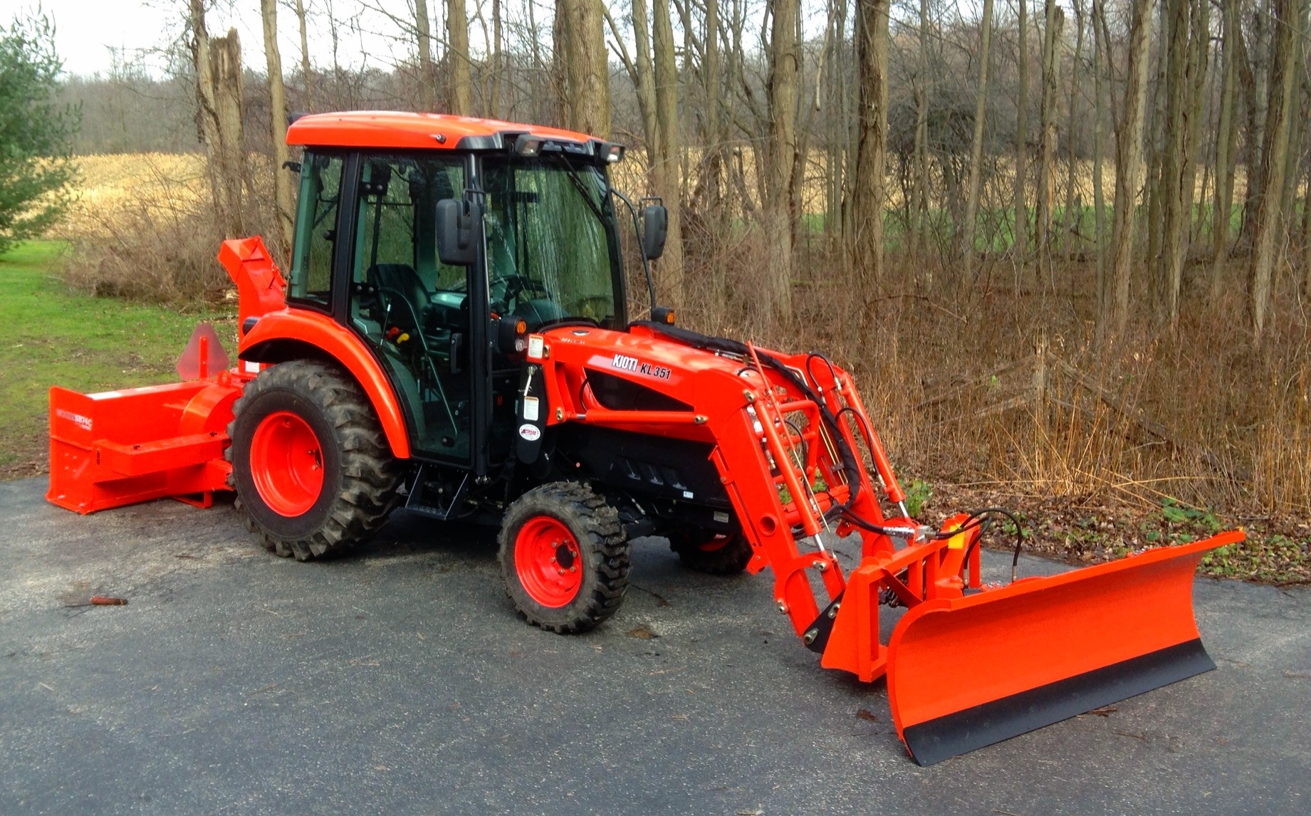

I had the same blower on my Kioti with hydraulic chute rotation. But I also had it on a quick hitch with TNT so it was an easy hookup, no cutting of the PTO shaft. It does improve the angle with the QH. I never ran it without so I can't comment on that.
I'm a big fan of the QH but it seems you don't feel like the need or expense. It would make hooking your QH compatible implements even easier. If it were me I would get the QH because invariably I would cut the PTO shaft too short or if I cut it right it would bind because of the angle and I would end up buying a new PTO shaft and QH anyways!
