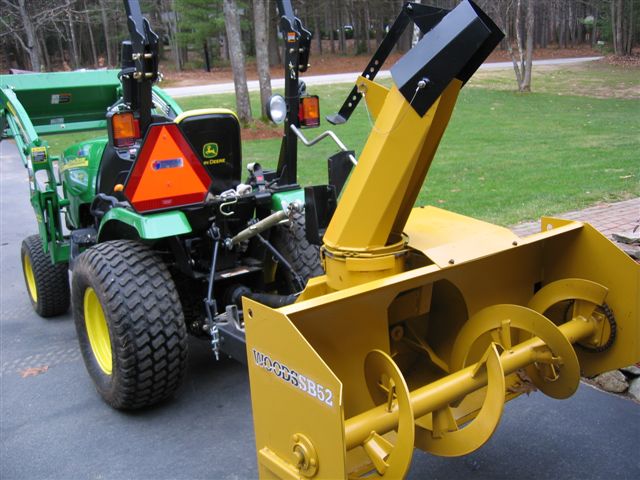

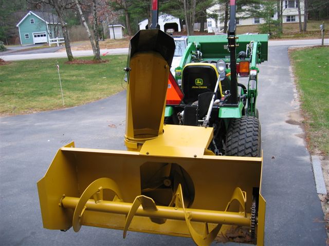

I purchased a SB 52 this last year and to notice that it doesn't throw the snow that far also. Im wondering what the changes between the SB and the SS models. Mine is at least 10 years old. But in great shape.
