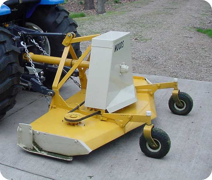

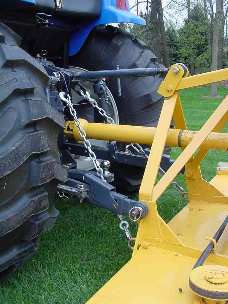

There always is the concept of "check chains". In some ways, I think it is preferable to front casters. See attached pic.
   / Woods RM 90 #4
QUOTE=djradz;2869079]There always is the concept of "check chains". In some ways, I think it is preferable to front casters. See attached pic.[/QUOTE]
That is the concept I was explaining above.
If you are always going to use the same cutting height the attachment at the tractor end as shown in your pictures is fine.
Normally the chains have extra length and the slot your chain hooks are in
will hold any height you set by just putting the chain link in the slot sideways.
The check chains are the way I do my Woods 6' brush rotary cutter and are great for changing cutting height for different situations like cleaning up
along the edge of tree lines versus mowing shorter weeds.
Your pictures show nice clean equipment:thumbsup:
Mine looks terrible after 20 years of hard use but still functions as well:ashamed:
Are your pictures the model he was asking about? I was talking about bigger stuff. He has not responded, I see.
   / Woods RM 90 #5
That picture is about 8 years old, so the equipment is not in as quite as good shape today, but not bad either. The deck is a 6 foot, Woods RM306, but I have chains on my rotary cutter too, set up without turnbuckles and use the chain links (just as you describe) for adjustment. The turnbuckles work good for the finer adjustment I wanted on my RFM. I think the unit he was asking about is 8+ feet, but I see no reason that the chains wouldn't work well for that also.

Thanks for your help. The information and pictures were very helpful in understanding how this works.
