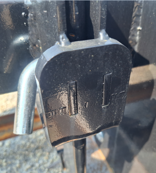

I was at a dealer and noticed that the new Woods grading scrapers (land planes) were made in china. The black GS 30 series scrapers had 'made in china" stickers on them. The old burnt orange GSS series was made in the USA. I was disappointed to see the change from USA made to Chinese made. I looked both units over and noted some very minor differences.

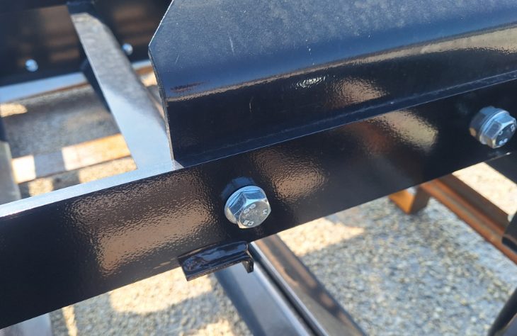

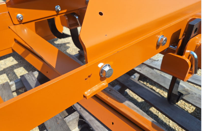

The USA (orange) unit had a flat bar at the bottom of the mast, the Chinese (black) unit had a thinner piece of angle.

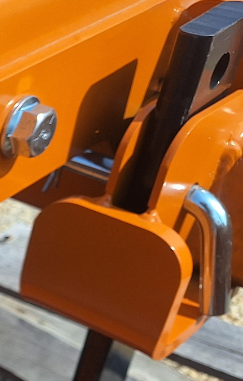

The scarifier pocket on the USA unit was welded whereas the Chinese unit had tabs and notches. The metal thickness looked the same so the CN unit was better built.

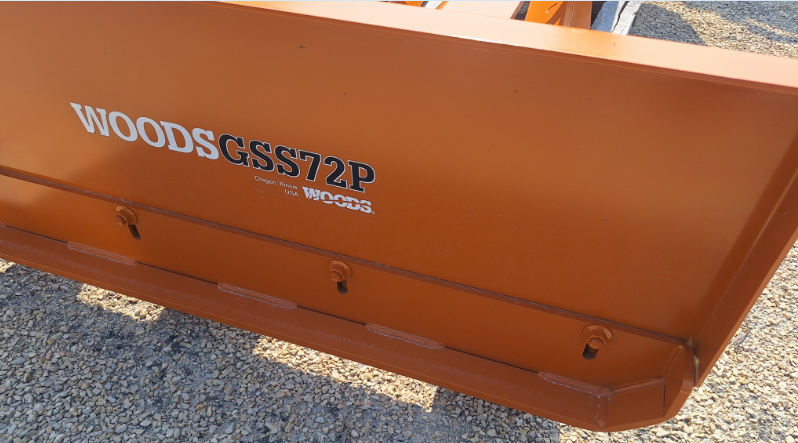

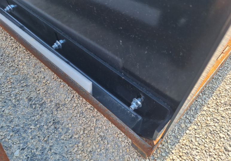

The runner on the USA unit was fabricated but the Chinese unit was formed. The thickness of the metal looked the same.

What makes tabs and notched "better" than welded scarifier pockets.
I've just spent a dozen hours moving forest soil (and roots) with a box blade, and am thinking of one another foot wider.....
   / Woods Grader Made In China
This might be opinion. But I think it lets more contact between the back and side so it will have less flex. These are landscape graders/landplanes/grading scrapers. The woods box blades I think are all still USA.
