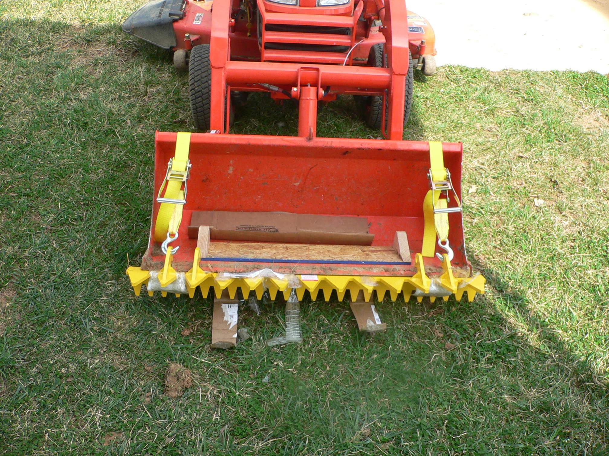

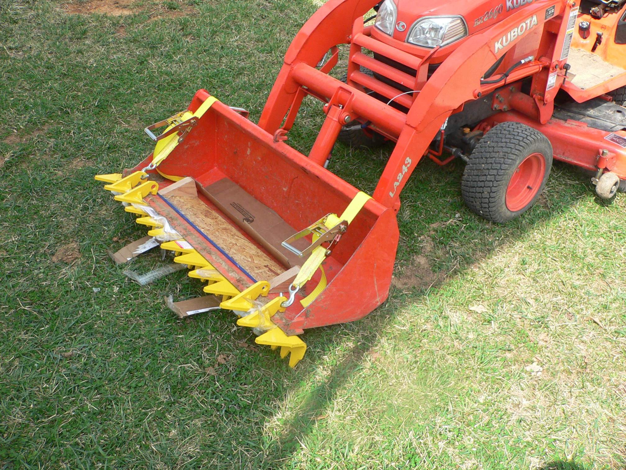

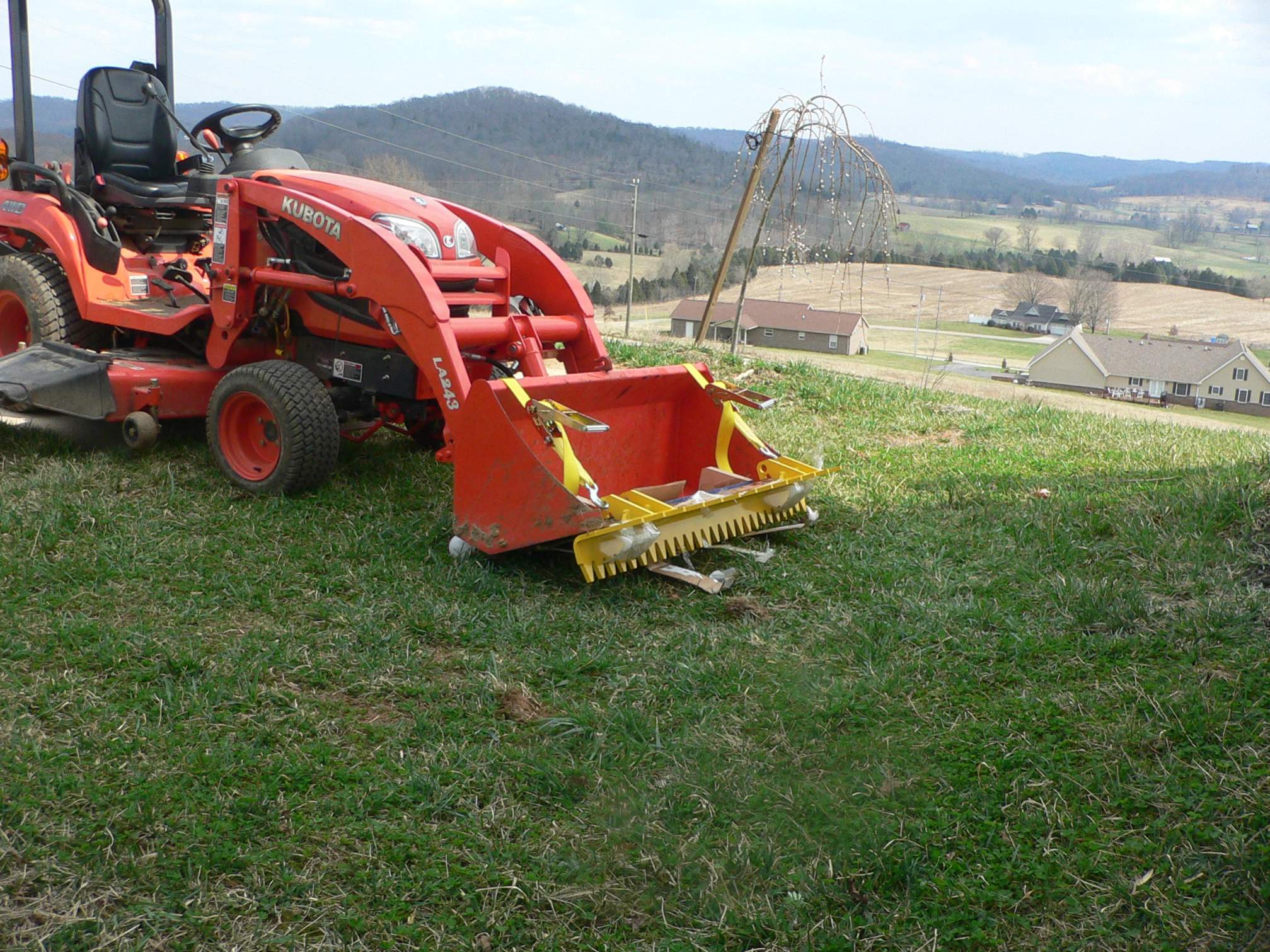

Finally found pictures of RatchetRake on my BX.
This is when I had it on the BX2660 before the BX25.

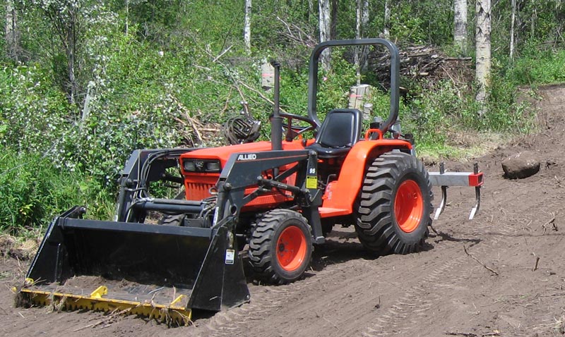

This is my setup for my B8200. I had to mount the Ratchet Rake with (4) 1/2" grade 8 bolts so I could still use my 4-in-1 but it only takes a few minutes to take it off.
If the RR doesn't get it the rippers in the back do. :)
