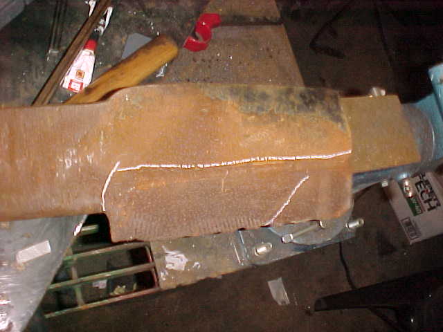

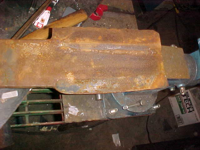

I did some experimenting by taking the torch and cutting about an inch off the cutting edge and welding a cutting bit from a plywood lathe into it. It took off some four inch alders like paul bunyan with a broad axe. I used them for a week in heavy mowing and they did pretty well. I have had them put away for awhile so the are a bit rusty. The chalk is right along the weld line. The chalk line that runs across the bit towards the end is a crack from stress. The weld looks good though and I wouldn't be afraid to use them again. They do hold up better than mild steel.

Here's the other side
